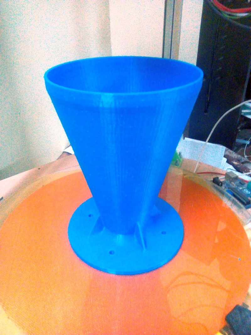

Its time to print cyclone separator for my CNC router.

.. here is the completed half portion took around 8hours...
