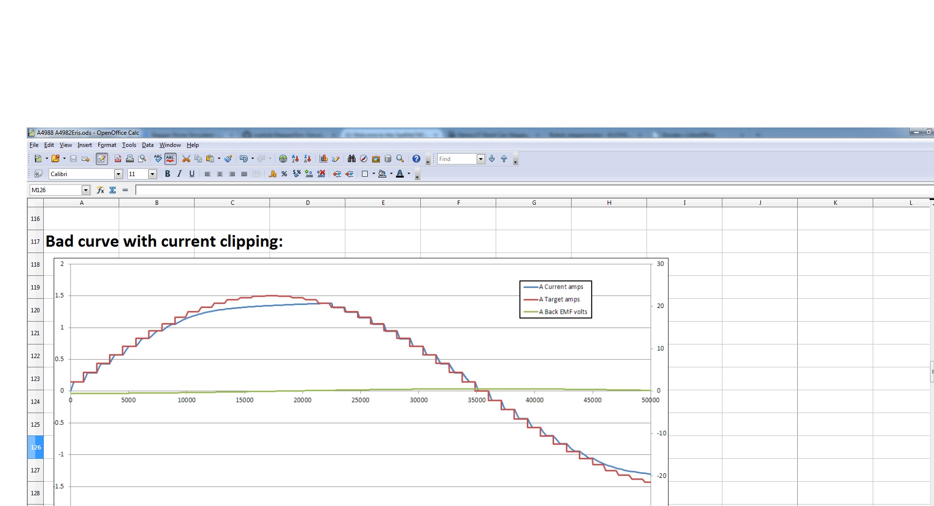

Figure I might as well kick over this stone now, as i just discovered it.
You cannot use microstepping on a 12V rated motor on a 12V rated power source.
https://www.seemecnc.com/collections/pa ... pper-motor
They draw appx. .35 amps at 12v and are 1.8 degree (200 step).
That's why this thing is so noisy, the stepper driver cannot control the current in a high inductance coil that self limits the current.
Same reason MakerBot T-O-M failed and had a major motor change.
Jetguy
Posts: 40
Joined: Mon May 23, 2016 8:23 am
Post by Jetguy »
https://github.com/rcarlyle/StepperSim
motor data sheet http://www.automationtechnologiesinc.co ... 033-4A.pdf
Basically, at 60mm's carriage speed, not effector speed, we already see the inductance high enough the driver is maxed out. Meaning current lags where it should be. Simply put, do not run a 12V rated motor with a microstepping driver on 12V because there is no "headroom" for the driver to actually control current. Like an amplifier driven to clipping levels, the music (motion) pretty much becomes noise (distortion).
Simply changing the motors to a rating somewhere between 0.8A to about 1.2A rated motors in the same size would totally change how the machine sounds and prints.
A4988 A4982Eris.ods
(11.16 MiB) Downloaded 1126 times
Jetguy
Posts: 40
Post by Jetguy »
Should have added, When you see the blue line BELOW the RED line= BAD. AKA Clipping
Per the instructions in the data sheet, the example.
Again, even as low as 40mm/s the curve begins to appear that we are lagging and only gets worse the faster you go.

I think SeeMeCNC really, really, really, needs to take this advice and implement to production. Yes, this is going to cause a version issue and yes, people are going to have to know which motors they have, but as predicted, using much better rated motors with lower inductance considering the 12V source makes a HUGE difference in sound and I'm more than sure that's going to also translate to print quality by removing some ridges I saw in prints that looked like stepper clipping.
These are the motors upgraded to for XYZ https://www.amazon.com/gp/product/B015SS3Y7O
Plug in compatible, just requires updating firmware with proper vref settings.
config.h file attached
