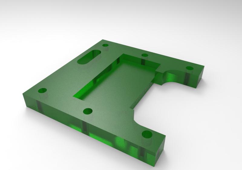

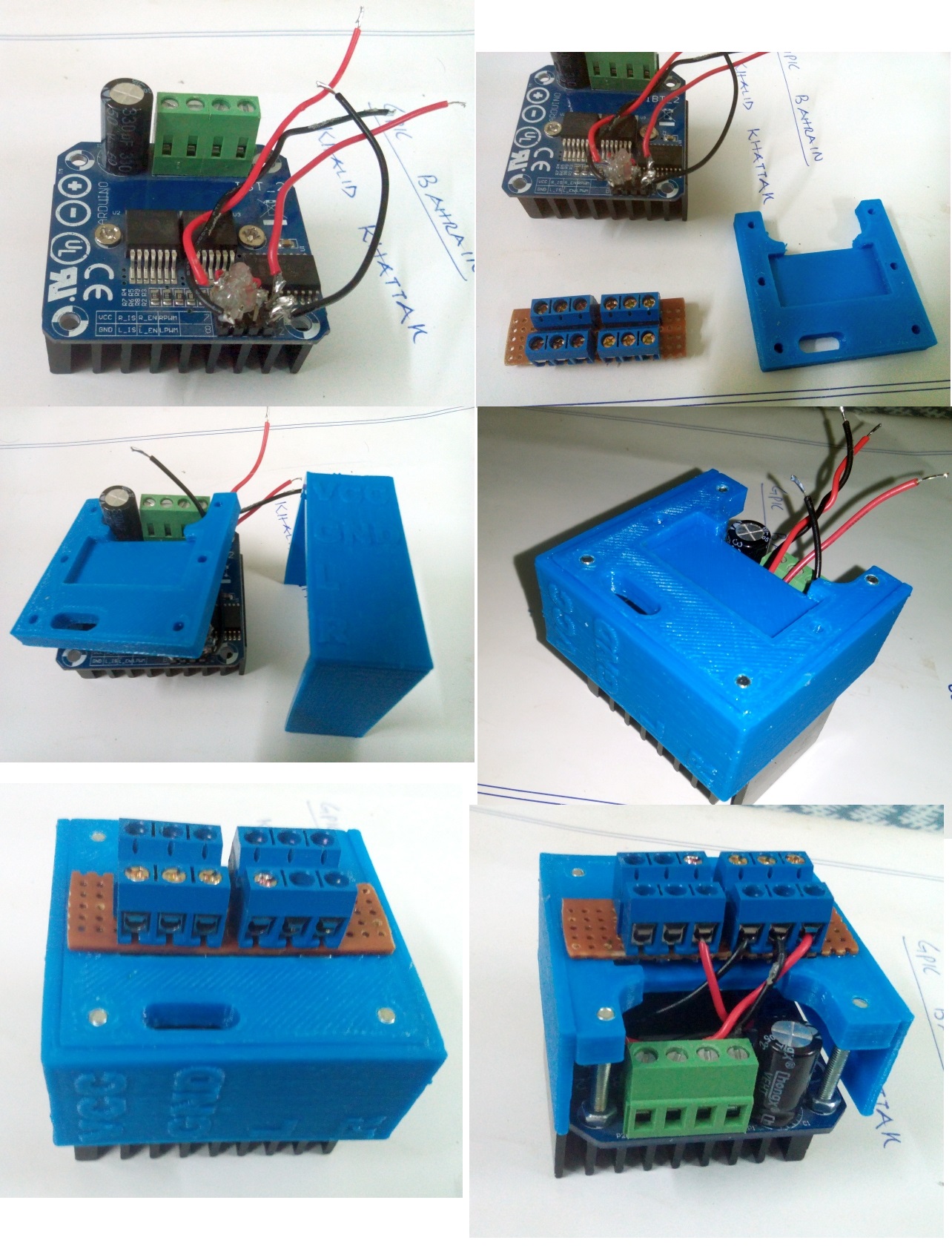

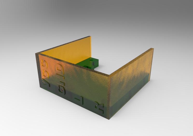

This is just an enclosure for easy wiring for IBT-2 controller. Print the files separately without support and just assemble as seen in the picture. The 4 holes to be tapped 3mm and use 4 M3 screws to tighten with IBT2 base. posted on Thingiverse.
