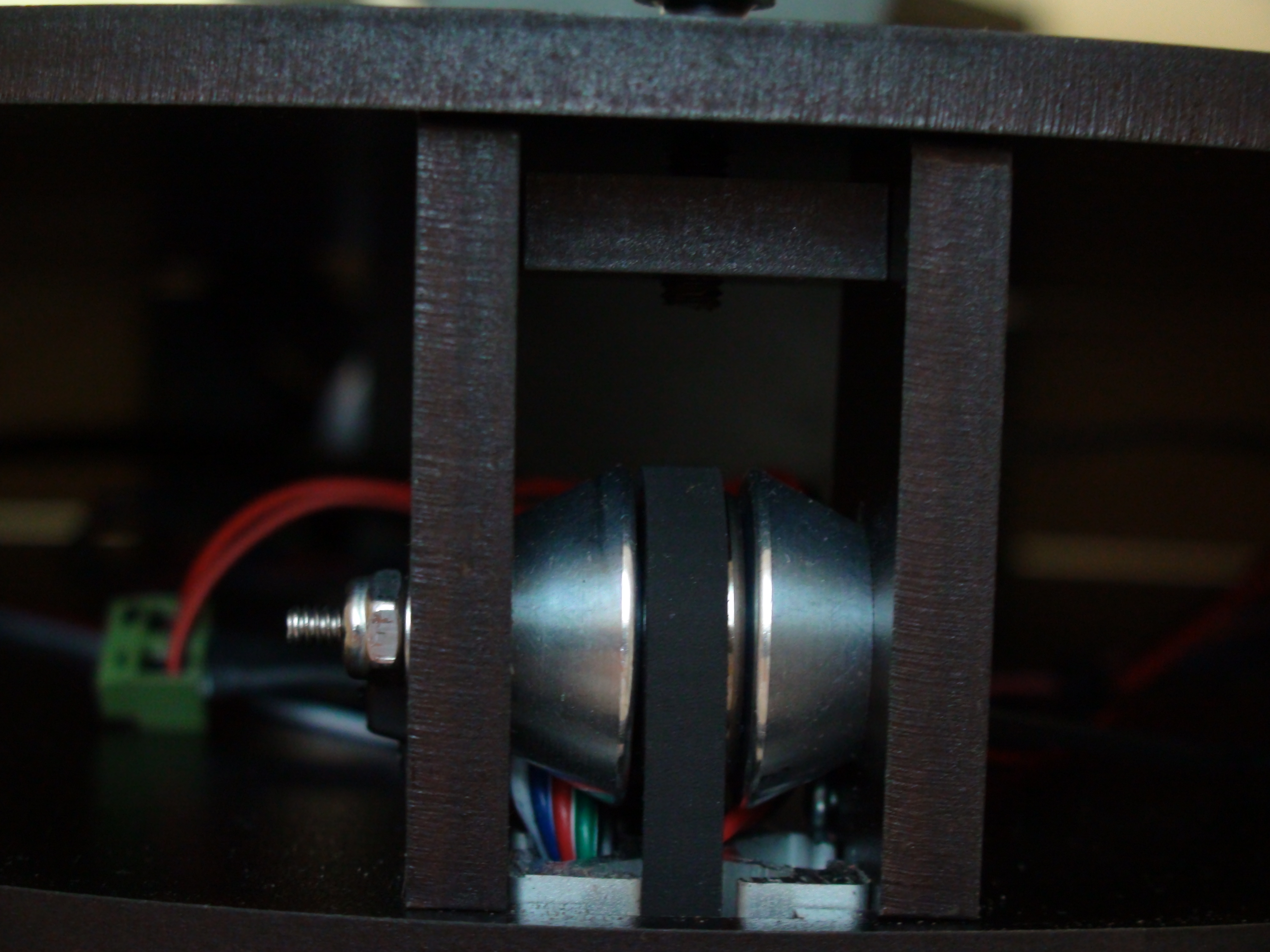

I kind of went a different route when building my V2.
I used 5 conductor #20 ribbon cables made for RGBW LED strands, and ran the flat ribbon cable up the side slots of the extrusion verticals pulled tight and behind the T-nuts. http://www.amazon.com/gp/product/B00NANLXNC

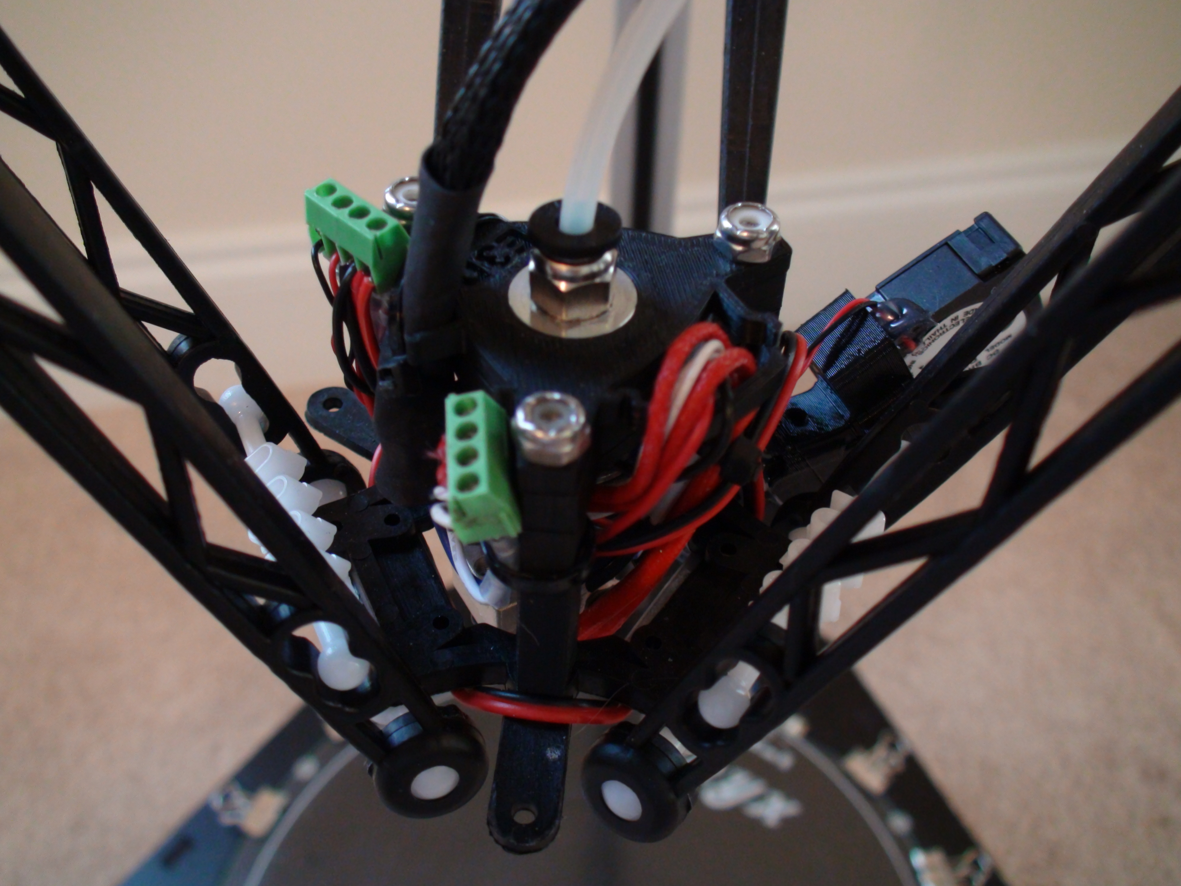

For the extruder heaters, fans, and thermistor, I ran another 5 wire #20 flat ribbon cable and a 2 wire #20 cable together up the other tower and down to the head terminated in 5.08mm spacing bard style screw terminals soldered with heatshrink.
On that one, I use white/blue for thermistor, then the main single separate 2 wire #20 was for the heater, then the Red of the 5 wire was for fans. That leaves black and green as returns for a hotend and a print cooling blower fan. This allows you to run 24v heater and 12V fans, or just not have a drop in fan speed when the heater kicks in.

#4, the wires to the hotend are contiguous all the way from the mainboard to the hotend with no splices or solder joints. The routing is clean and sharp bend free, the exposed loop down to the hotend is covered in black mesh which helps limit bend radius and looks sharp.
#5 the screw terminal termination at the hotend makes swaps, repairs, testing, and just assembly a joy rather than a nightmare. It's might not be the plug and play of the Eris, but it's not that far off either.

Side is both a 5 wire and a 2 wire in the V of the side where the rollers go. This is the contiguous wire run to the hotend. Has thermistor, 2 fans, extruder heater. If you wanted to be extra slick, I could use the heater power and then use the second red for a constant on source (say LEDs strips on the effector). As is, the hotend fan is temp controlled in repetier. The instant the heater turns on, it's on and stays on until the hotend is below 50C. As such, I wired in LEDS in parallel to the fan, such that the LEDS are effectively on the instant you call for heat, and don't turn off until well after a print finished and the head cooled to less than 50C.

Jetguy; Your set up seems very interesting. So your ribbon cable runs on the track behind the carnage wheels? I was concerned about the wires bending so much and stripping against the aluminum when I build it.
Re: Most elegant way to wire duel extruder?
I'll try to post pictures later tonight of that build. The key was I used a washer on the 1/4 inch screws that hold the extrusion and t-nut to ensure the capscrew didn't go through the t-nut and crush the wiring. I think it builds faster and easier than trying to chase all that wiring down the center and certainly reduces crosstalk and other issues.
Sorry for the delay in pictures. The flat ribbon style wires made for LEDs comes in 2 variants, 4 wires for normal RGB (Black, Blue, Red, Green) and then the newer style is 5 wire RGBW, (Black, Blue, Red, Green, White) https://www.amazon.com/gp/product/B00MHQLMTS
Thanks for sharing the photos. Looks like a very nice setup.
