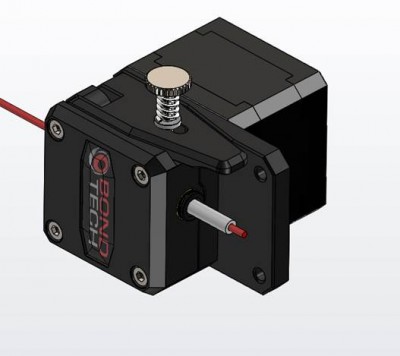

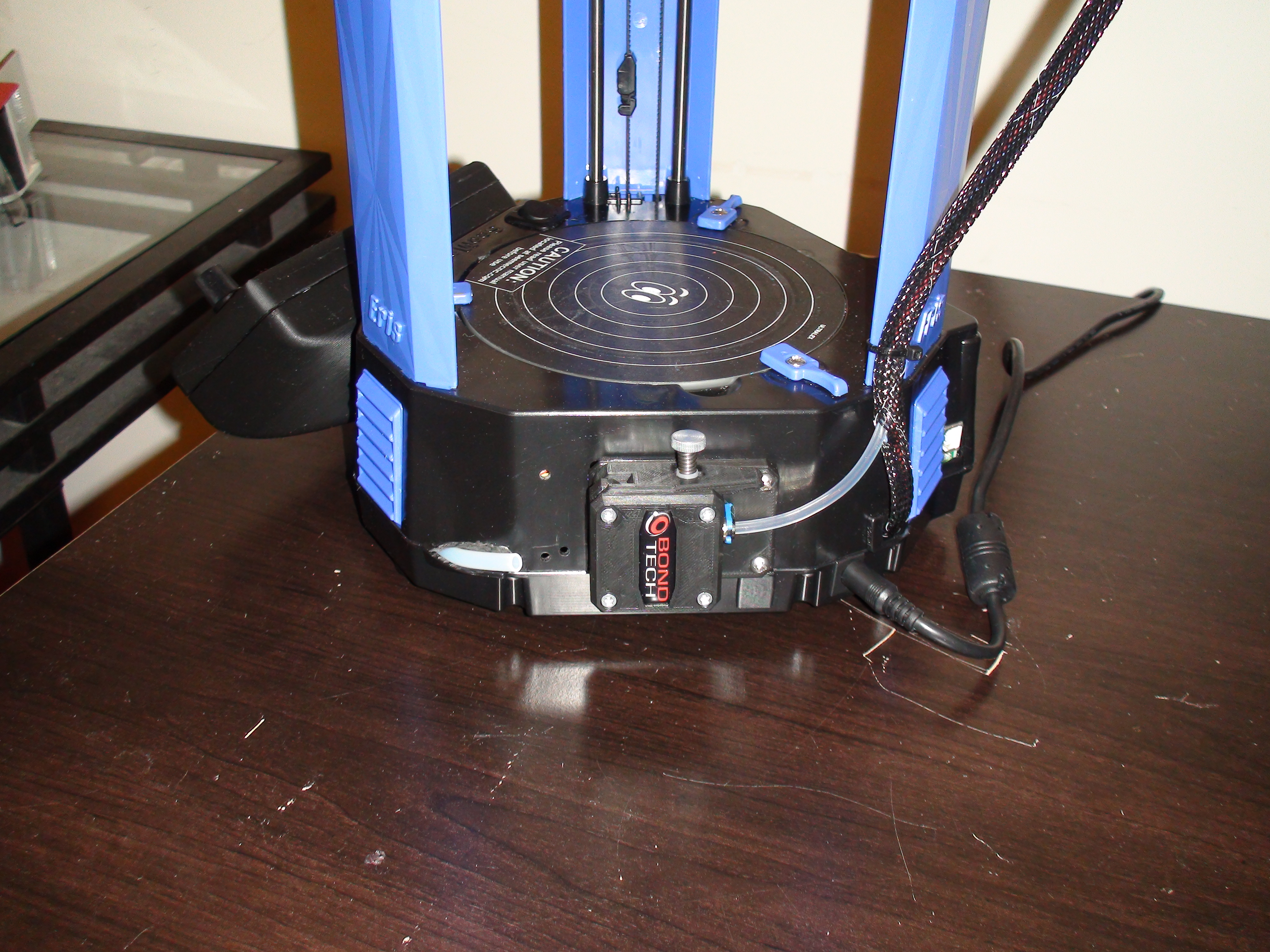

FWIW, Martin from Bondtech sent me a proposed design that is bolt on in place of the standard  SeeMeCNC EZ-struder. The only different is the filament path is on the upper side, but that decision is so that the lever and spring is facing upward for easier access.
Here is a draft picture.

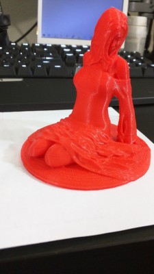

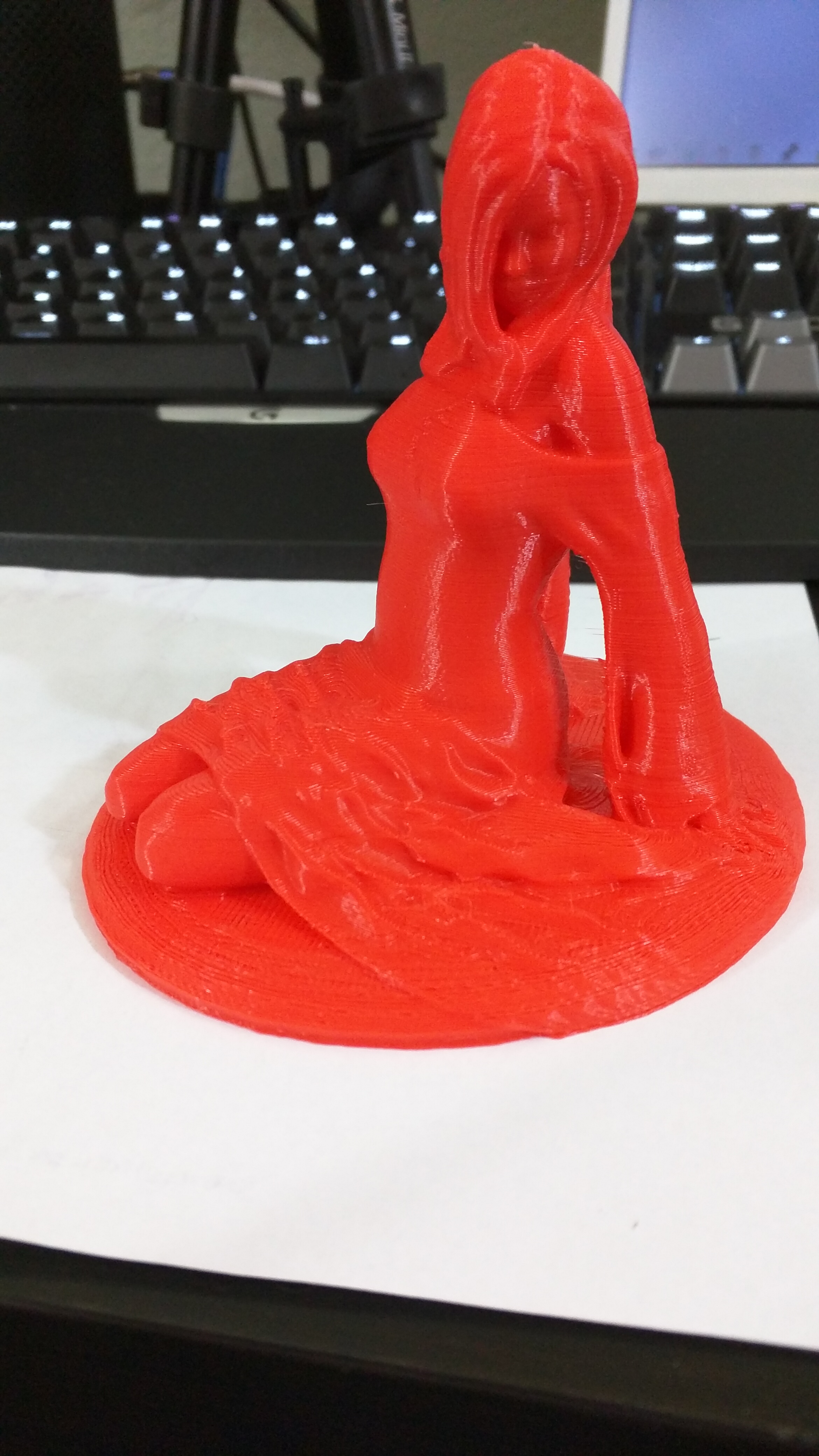

Ok I have updated my most recent Simplify3D profile. Been running it all day with quite good results (see attached pictures)
I will mention I run a desk fan while printing as well.
Cant figure out why the smoke stack is coming out like it does on this profile, need to do some more tuning. But I feel this profile is better than my first one and thought I should share it.
Credit to Jetguy for the starting gcode, I only modified it to raise the nozzle slightly higher from the bed while purging
 Eris-05-29-2016.fff.txt- Current profile im using.
(Remove .txt) - (11.46 KiB) Downloaded 536 times

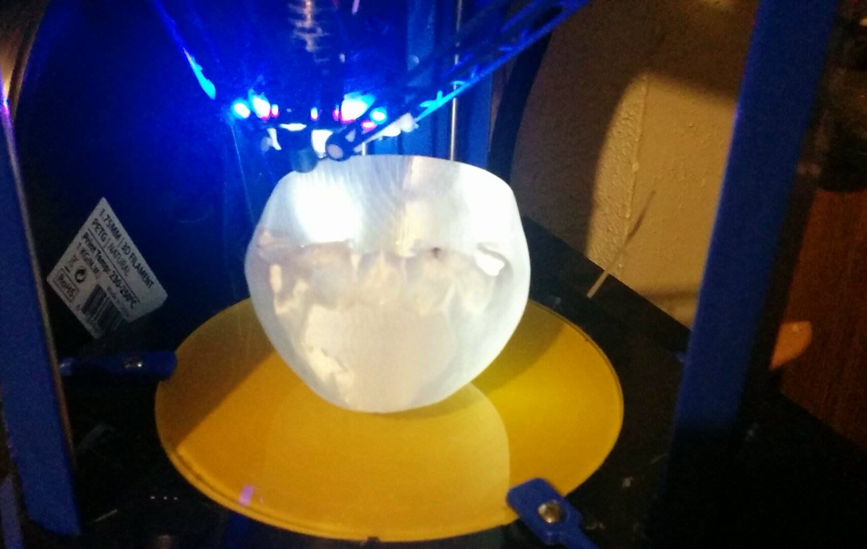

 - Posts: 1407
Mac The Knife wrote:PetG Skull
It failed. a 20 loop x 2 layer rim wasn't enough to keep it stuck to the bed.
Here is the actual printed version installed.Jetguy wrote:FWIW, Martin from Bondtech sent me a proposed design that is bolt on in place of the standard SeeMeCNC EZ-struder. The only different is the filament path is on the upper side, but that decision is so that the lever and spring is facing upward for easier access.

Looks good. I suppose you can't trim the base so you could angle the extruder to line up to the feed tube better? Prolly make the base look hacked up.Jetguy wrote:DSC04014.JPGHere is the actual printed version installed.Jetguy wrote:FWIW, Martin from Bondtech sent me a proposed design that is bolt on in place of the standard SeeMeCNC EZ-struder. The only different is the filament path is on the upper side, but that decision is so that the lever and spring is facing upward for easier access.

The point was 10% for stock, and 90% for using with the Mosaic Palette which uses an external encoder about the size of a feeder attached with a short 6mm tube. I've run both ways (Palette or direct feed) with no issues. The alignment is not as bad as you think because this curve around the printer thing actually aligns the path right up and gives you access to start the feed.Mac The Knife wrote: Looks good. I suppose you can't trim the base so you could angle the extruder to line up to the feed tube better? Prolly make the base look hacked up.
I bought the Eris for 2 reasons.
#1 it's the smallest portable printer I like. There are others around, they all have major shortcomings. Eris is a tough as nails, properly designed, common components, well supported, open source printer.
#2 the design looked perfect for demonstrating with the Palette as the smallest possible 2 color package that fits as carry on luggage on airlines and I proved this flying back from Bay Area Maker Faire. 4 color printing that really works and fits into a small sized bag.

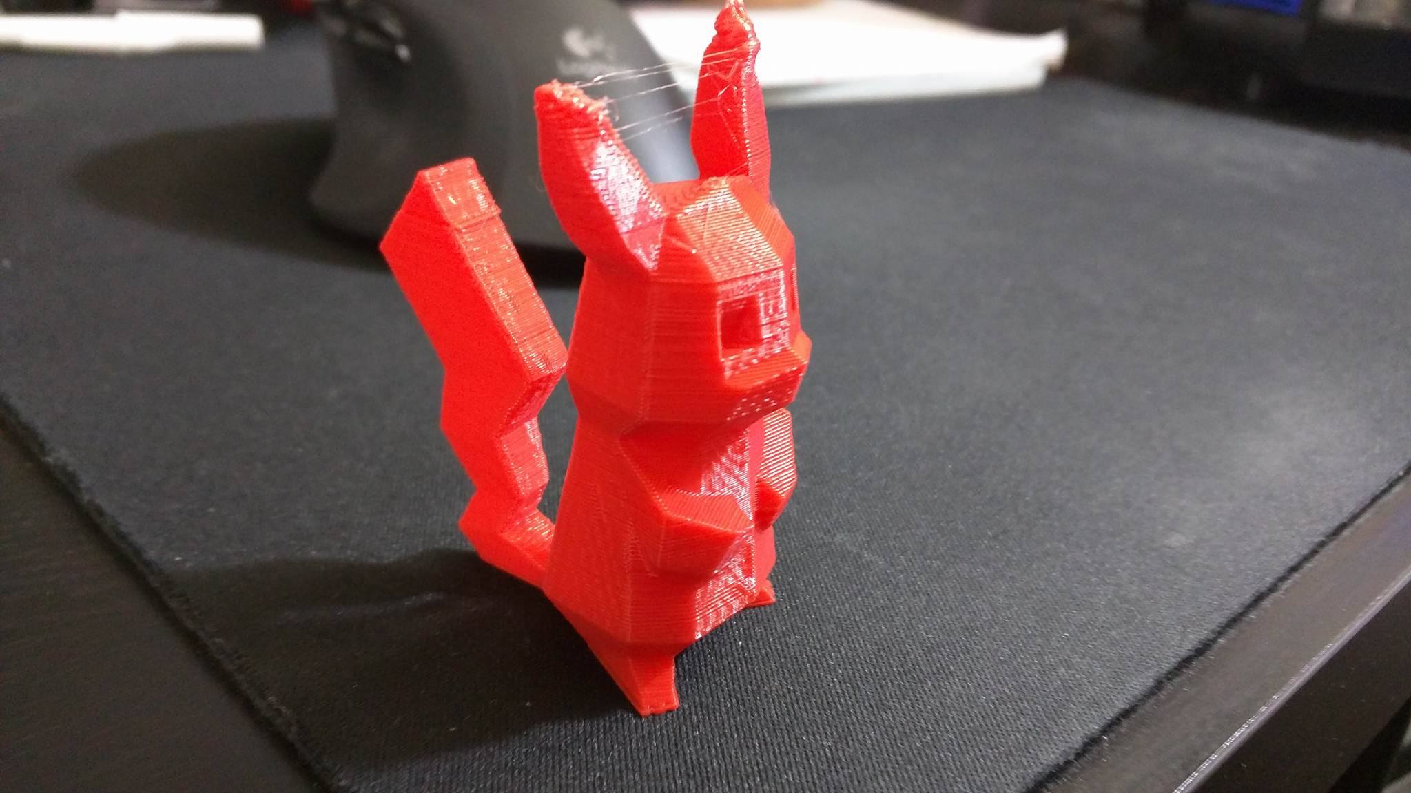

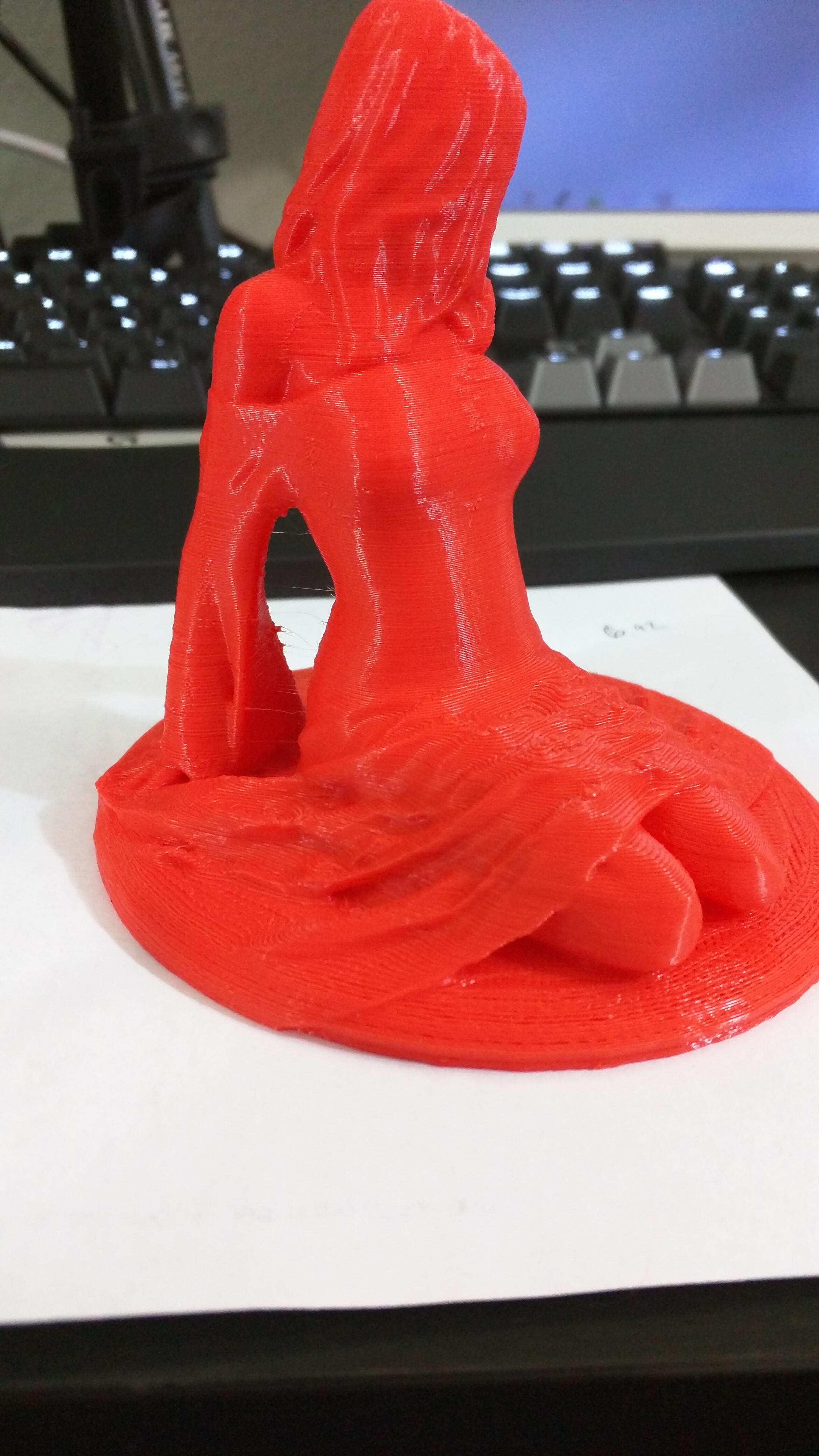

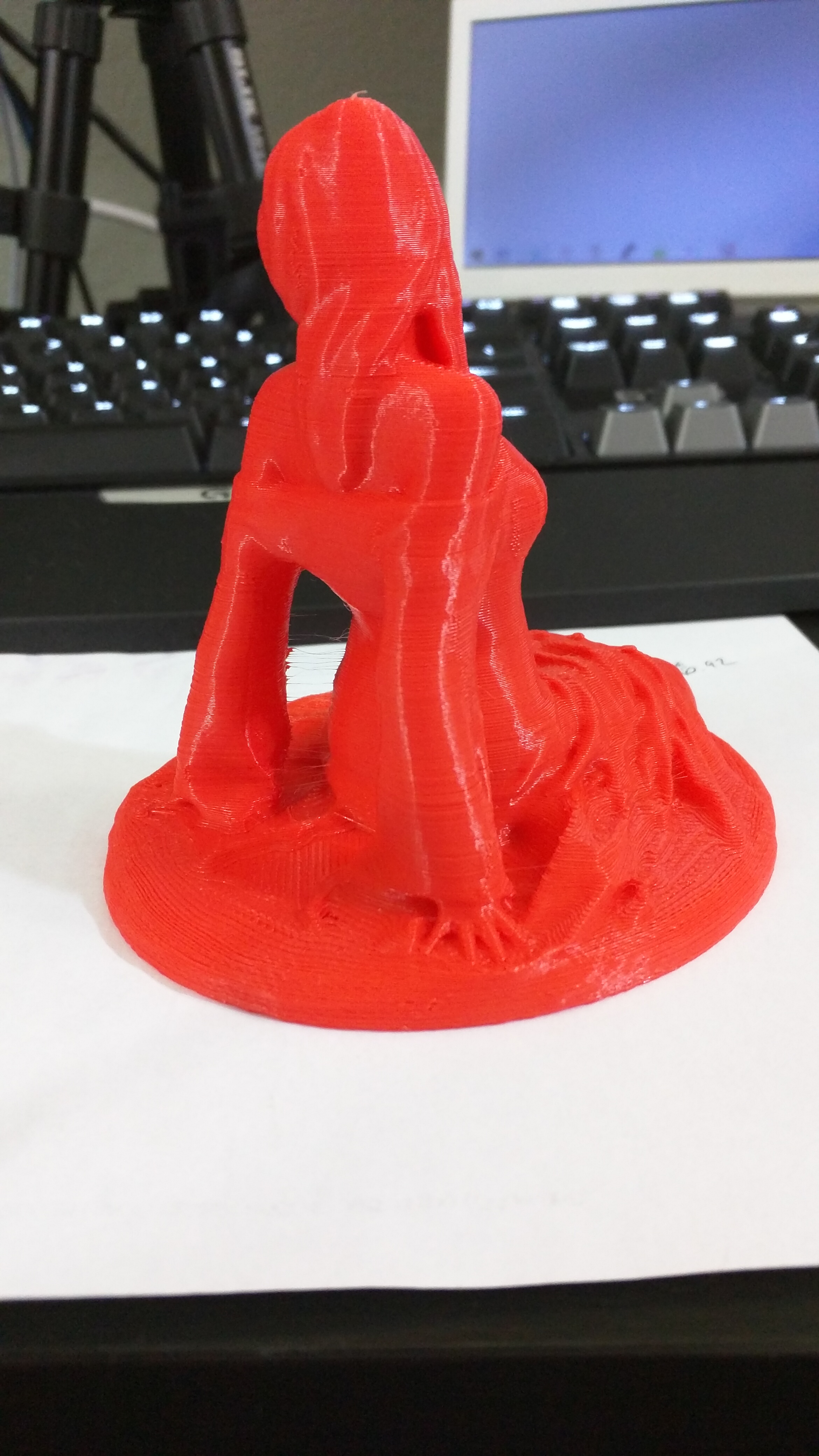

Printed using my s3d profile set to about 30mms and temp at 215c for this Filament. Not enough infill for the base though.. but not bad. As was off the print bed not clean up.
I been getting better results without the print mat myself..
Flipped the bed over to bare glass side.. put hairspray on a paper towel and blotted the glass with it so it was textured.. let dry completely.. print!
Credit to designer: fantasygraph @ https://pinshape.com/items/5696-3d-printed-love-me
