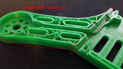

So I am currently working on a quad copter frame, because its finals week and modeling/printing is my stress reliever, and my printer has been making it not as fun recently!

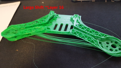

Basically the print will be just fine for the first 15-30 layers then all of a sudden the effector will start printing anywhere from .5mm to 5mm to the right (negative X direction) of where it should be. Ive had my printer for over a year now and have seen almost 5km of filament through it. The only time ive seen this issue is when I still had the original arms and the hotend would hit the print and a belt would slip. Now the interesting thing is I have since upgraded to magnetic CF arms, so theres no way the hotend could hit the part with enough force to cause a belt to slip, because if it did the effector would just pop off, since its magnets (trust me its happened). This issue happens mostly with ABS. If I use PLA its like the filament jams for a single layer and then unjams for the next which causes the print to also mess up, but stays in the correct place.
I am really at a loss and would love absolutely any suggestions, I have 6 or 7 error prints and the layer it messes up at isnt consistent, or even how badly it messes up. It might even be specific to this part because I was able to print something for a client that was only 15 layers high with absolutely zero issues.
Possible Issues I think it could be:
-Damaged belt (I dont have the time or patience to rip them all apart at the moment)
-Cheapskates too tight?
-Loose gear on stepper?
Ive included one of the parts from the quad frame that are giving me issues. If someone has some extra filament and time and want to try, Id be in your debt. (I'll send you the rest of the frame when Im done finalizing it!) Also there is a picture of a less drastic shift, and one of the worse ones, I can just peel off the shifted layer on the bad ones

I'd guess that either you're getting cross talk (interference from motors or heaters) on an endstop or two at some point and it is causing it to trigger and skew, or your motors are skipping a few steps, getting caught on something. Make sure the bowden tube and wiring aren't getting caught on anything.
To fix the endstop problem, grab the firmware you last uploaded to your machine, go to the configuration.h file, do ctl-f (or cmd-f if on OS X), and search for "always". It should come up with ALWAYS_CHECK_ENDSTOPS, and if it is 0 set it to 1 and reupload your firmware. If it is 0 already then you have another problem. Be careful with this set like this though, you can easily crash your machine since it will only check if the endstops are triggered on a home all move.

Finally got it fixed! Im still not quite sure what caused the layer shift, but this last time I printed there was a small layer shift, and then 3 layers later the head rammed into the part.
I think the issue was that the slicer was having trouble with the amount of moves that were required for the piece and the quick changes in direction were causing the belts to slip (or something to slip atleast)
Because after I watched the video there were about 3 seconds worth of jumpy back and forth moves without any printing before it went straight down into the print.
I switched to the CuraSlicer and I printed both halves without any issue!
