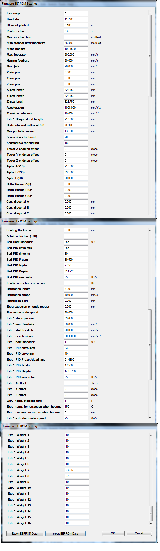

Horizontal Radius missing in EEPROM
Post by Cobaltrod »
I have a Rostock Max V1. I replaced the Rambo with an Azteeg X3pro, and the LCD display with the Viki2 display. I use Repetier version .92.
I'm trying to calibrate the printer but I can't because "Horizontal Radius" is not present in EEPROM. Making changes to "Printer_Radius" in firmware appears to have no effect in calibration despite turning turning EEPROM support on and off and going through the calibration again and again.
I have a "horizontal Rod Radius at 0.0" in EEPROM but changes to this don't persist through firmware updates. Can someone please help me figure out a way to calibrate without being able to change " Horizontal radius"
Thanks, Rodney

Have you tried changing the value in EEPROM and now worrying about reflashing? Generally people flash the firmware once and just change the value in EEPROM thereafter. Also the point of EEPROM is to prevent a reflash from reseting calibrated values. If you want to reset them then upload the EEPROM_Clear program in the IDE (file->examples->EEPROM->eeprom_clear or something like that)

I have never seen "horizontal radius" in EEPROM or anywhere else, and have never been able to calibrate my 3D printer, even with the original Rambo installed. Another thing I have never been able to do is Print with EEPROM mode set to 1, z-height is all screwey,head crashes happen, homing issues occur,
For Once I'd just like to be able calibrate and print like everything should as documented, by have literally tried to fix things to calibrate and successfully print.

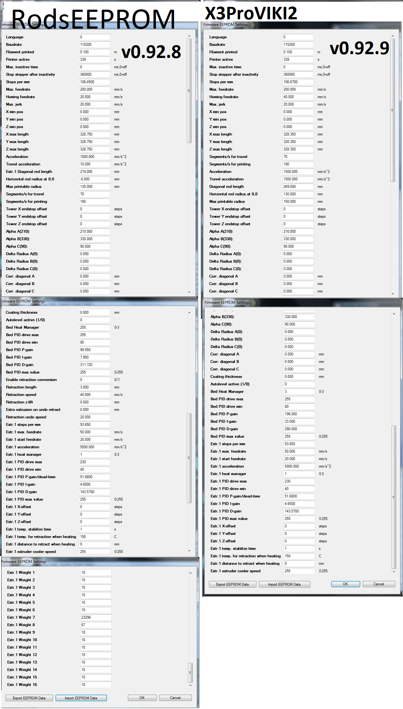

Where are you getting your firmware from? Can you post the config.h file thats apart of it?

I can post the config.h. I'm not sure where this version of of FW came from. I think it was originally from a link in the Rostock max v1 assembly guide, then maybe imported in the Repetier FW config tool, updated to my config with Azteeg x3 pro and viki2 But over the years I have tried many Repetier FW versions, and like I said, I've never been able to never find or set horizontal radius or been able to calibrate my printer. Id love to find a solution. I'll add my config.h and EEPROM config. Thanks for the help.~ Rodney

Okay, Here's my config.h
COPY 2
4/25/16
Copy with working Homing

And Here's my EEPROM Settings...

Your problem is right up at the top, EEPROM_MODE should be any value between 1 and 255. 0 disables EEPROM. I would just set it to 1. All the EEPROM_MODE means is if its > 0 then it is enabled, and it stores the value in EEPROM. Then if you reupload the firmware with a different EEPROM_MODE value (say instead of 1 you do 2) it will see that the number has changed and it will rewrite the current EEPROM values with the new flashed values. If it is the same number it will just keep the old settings.

I installed the v.92.9 firmware you created, made a few changes to Baudrate and MaxLengths, and compiled and uploaded the Firmware and EEPROM. I've attached a side by side of my v.92.8 FW and your V.92.9 FW below for your review. They both contain some, but not all, of the same setting names and the listing order of the settings is different. But most importantly, Neither contain the setting for "Horizontal Radius", which is what we're trying to find, so we can change to calibrate the printer. Any idea why it'snot in your v.92.9 either and/or how we can get it in EEPROM settings?

I was able to use .92.9 FW generated. I followed the calibration steps in the appendix of the 4th Ed Users manual as instructed and changed "Horizontal Rod Radius at 0.0" when the calibration steps specified changing "Horizontal Radius". the Initial value there was 130, and I did two .5 increments to reach calibration at 131. Finally calibrated and printing better than ever. Thanks for the help. ~ Rod
