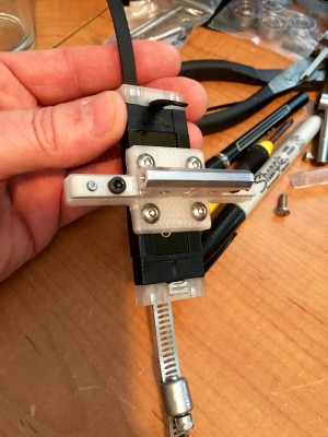

Here is the belt attachment and tensioning mechanism I designed for the carriages. I also printed this temporary mount for the TrickLaser carriage arm mounts. I'll likely cut these in aluminum at some point but may commission the printer with the printed parts as they turned out really nice and are rigid.

Michael,
I'll be stalking you on this site.....I sort of am confused how you are using a ss hose clamp flattened as a tension-er for the glide, or why it needs to be there. Keep in mind that I have only built an Prusa I3 type machine and my other machine I own is a Cartesian type Wanhao D5S, so I do not yet pretend to understand the dynamics of the Delta yet. I am reading through the Rostock Delta's latest build guide to educate myself a little and of course eating up as much info as time will allow on this and other sites. I love the passing of knowledge and different views.
I got the bug to start a new build on the Delta side of the fence when I just went to the Goshen, IN MWRRF a couple weeks ago. I saw TrickLaser"s booth and did not realize that they live so close to me as I live in Niles, MI. I was very impressed with how tight the build was that I decided that was the frame to start with. I also thought I was going to go with his tricktrucks and MaxMetal Platform, but now after reading about Brian and you discussing the linear slide rails, this is the way I want to go. I would like to go with magnetic arms so I do not know yet how I will attack the attachment to the slides and what type of effector platform to use, I would prefer it out of aluminum than plastic.......time will tell. Thanks again for your assistance
Re: Trick Laser MAX METAL with Linear Rails
1) you need a way to tighten the belts
2) on the Rostock and Metal Max, the pulley at the top of the tower is slotted so the belt can be tensioned
3) on my build with linear rails, I use 2 pulleys at the top to offset the belt to be parallel to the travel of the carriage on the rails, I prefer to have this securely mounted requiring an alternative belt tensioning mechanism
4) I "open" the hose clamp so you have a 4" long x 1/4" wide slotted strip with the adjustment screw in the middle. One end off this attaches to the bottom of the carriage as shown in the photo above. The other end is attached to the belt. I am making a little clamp that the belt inserts into and folds over for security.
Hopefully that explains things. Your machines must have some way to tension the belts, even if it is crude. I wanted to build a more reliable tensioned for this machine.

I understand and thanks for explaining it. I am very impressed with the upper tower, double roller guides that you built. I cant see another way to do it than that. Is there a possibility that I could pay you to make another 3 aluminum cutouts for those? I totally understand if you are too busy...
