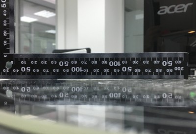

Hello forum,
I'm pretty happy with my ROSTOCK Max V2 (and even prouder to have put the thing together) but I can't print anything larger than 1/3 of the diameter of the bed or so because I have this huge arc on my Y tower. This is the biggest issue, even if there are some other smaller things I wish I could fix. I have tried calibrating many times but this problem persists. The other two towers seem to be alright but if I set the maximum Y tower hot end distance to match the center, the hot end runs way too close to the hot bed when it arcs and doesn't even lay any plastic down.
Does this mean I have to check the tower is orthogonal to the hot bed? Would that also explain why my X tower's stop screw is set way lower than my other two towers? Are there any additional calibrations I can do to fix or measure this? Thanks for any and all help.

Yea, I'd check it with a square, could be leaning a bit.rhoded wrote:Hello forum,

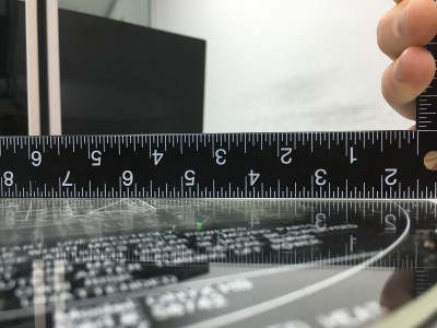

Below are pictures of what it looks like with a square. I guess that would be the problem, right? Is there an "easy" way to adjust the towers? Do I have to suck it up and take off the top part and do it like is in the instructions?

You should be able to loosen all the screws that hold the tower and tweak it a bit. It doesn't need that much of a movement.

Before messing with the towers, remove the glass and loosen the screws mounting the onyx to the snowflake/base.
Heat your bed to 70c then torque down each screw so that the onyx bed is the same height at all mounting points. Use the depth gauge of a caliper/micrometer to determine the height. Don't crank they screws down to much as it can warp between mounting points.
Also verify your square is actually square. It looks a bit wavy although that might just be the images.
