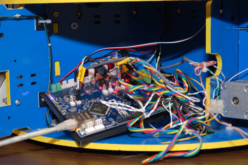

Here's a few observations of the adventure so far...
The "default" thermistor configuration is pretty spot-on with the stock SeeMeCNC hot end. I get a 2 to 3 degree difference between the stated temp and what my thermocouple tells me. My sampling point is the 90 degree corner made by the vertical nut flat on the nozzle and the horizontal flat face of the heater block. The temperature control is very tight - even with the PEEK fan running, I've not seen it over-shoot more than a few degrees before settling down.
I've done ZERO calibration on Blue MAX. The only things I've set were the diagonal rod to 269 (Blue Max has the TL arms, stock carriages) and the delta/horizontal radius to 135, which is ballpark-ish for the v1 & stock arms. I wanted to see how really good the "magical" auto calibration was.
I didn't even bother trying to calibrate the extruder - it's at the 92.5 default for the EZStruder.
My first successful print was a 25x25x6mm test cube. I didn't record the orientation on the build plate. I sliced it using Kisslicer with a .20mm layer height and a 20% octagon infill. I replaced the normal G28 in my start g-code with a G32 in order to kick off the auto-cal before the print begins. (Mhackney is right - there's no reason not to run auto-cal before each print - the amount of time it takes is trivial.)
The test part measures out at 24.96 x 25.23 x 5.94. That's pretty damn impressive for a printer that's had ZERO manual calibration done!
Just to see if it would change, I printed a 50x50x6mm test part and remembered to label the axes before I popped it off the build plate.
Measured along X/Y it's 49.73mm and along Z to X/Y it's 50.00 on the nose. Thickness varies between 5.89 and 5.93, depending on where I measure it. I toyed with the extrusion temp to get it to quit skipping during the print, so that may have had an effect on the end result.
The next print I'm running is Mhackney's Duet Flat Mount. I'd printed it once on Blue MAX as calibrated by OpenDACT some months ago and the mounting holes are off - the scale is wrong for the part by enough that I could really only use two diagonal holes, and even then one screw goes in at an inward-facing angle. We'll see how it goes with the Duet auto-cal.
Keep in mind that this is a minimum-effort configuration - I don't even have the layer fan hooked up and the PEEK fan is hard-wired right now. It's UGLY. (http://www.geneb.org/images/duet-rats-nest.jpg)
So my conclusions are this - the auto-calibration is near enough "magical" to not make any difference. :D (that being said, I am noticing some "too close" issues with the first layer of the Duet mount - may be due to either surface thickness changes in the glass or not enough calibration points, I don't know enough to declare for either at this point.)
Second, you can have my Duet when you pry it from my cold, dead, hands. :) I'll be upgrading Red Sonja asap and as soon as I can scrape up the cash for another board, Orange Menace is getting a Duet & FSR update. (Steve, if you're reading this please get that accelerometer probe done! You don't want me taking up a collection to hire random strangers to picket the SeeMeCNC offices holding signs like, "WE NEED TO BE PROBED, STEVE!", etc. :D :D :D )
My ferrules & crimp tool won't show up until tomorrow, so I won't be able to really get into the refit until then. There's also been some discussion of making a branch of the dc42 firmware that will drive the LCD displays that come with the Rostock MAXen, so that would be nice to have.
If you're on the fence on buying a Duet and you've either already got FSRs installed or have some other Z-probe, BUY. THIS. BOARD. You won't regret the upgrade. :)

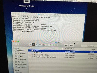

I am trying to update the RepRapFirmware. Downloaded all the files mhackney posted (bossac application, firmware.bin, and the flash duet.sh), updated my port information.
Attached is the error received.
What am I doing wrong?
Thanks.
Re: Duet setup - instructions in progress
3D-Print - don't do it that way. The shell script has a problem so run bossac from the command line as per my original blog post here: http://sublimelayers.blogspot.com/2015/ ... -os-x.html
Sorry for the confusion. I need to sort out the problem in the script. Here is the actual command you run in a Terminal window (assuming bossac and the firmware .bin file are in the same folder and you 'cd' to that location:
/Applications/Arduino.app/Contents/Resources/Java/hardware/tools/bossac --port=tty.YOUR_PORT_# -U true -e -w -v -b RepRapFirmware-1.09o-dc42.bin -R
Replace the parts in bold with your specific port and firmware.

I'm not sure what arguments and/or permissions that shell script might need. The instructions I've been using to flash mine came from the RepRapPro site, where they call bossac directly, the Mac command being:
Code: Select all
/Applications/Arduino.app/Contents/Resources/Java/hardware/tools/bossac -e -w -v -b RepRapFirmware-XXX-DD-MM-YYYY.bin
The arguments are -e[rase], -w[rite], -v[erify], -b[oot] and the path to the firmware image you want to flash.

Thank you!!
Used your command as detailed. Now I don't have the correct port. :(
What do you mean by "do an 'ls' in /dev to find see the ports before the Duet is connected."
