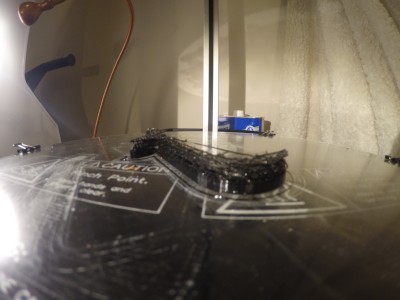

Re: Extrusion fails
Here is a picture of what just happened. Starts out just fine. then poof.

Re: Extrusion fails
Put my spool on a spool adapter to get better movement. Will try again.

Re: Extrusion fails
When it stops extruding, is the ezstruder still turning?
How hot is the stepper running?
If you push the red release lever, can you push filament through the hot end without much resistance?
What if you disable the stepper and manually turn the ezstruder cog? Does it extrude?
Smoke me a kipper, I'll be back for breakfast.
Re: Extrusion fails
When it stops the extruder is still turning, yes.
To get it going again I have to pull the filament out cut a new end then start again.
No clue how hot the stepper motor is running. When I first got this printer built I was having overheat issues with the stepper and was told to turn down the stepper motor current. It was running great from then till now.
As for the last questions yes for both but only if I do this before the jam.
I am pulling my hair out over this because it happen overnight and I have yet to be able to figure out why.
To make matters more confusing it seems that it does not always happen. I printed the same print you see above twice today. One came out fine the other failed. Two before those prints failed as well.
It seems to be happening during the infill portion. First few layers go down smooth. You may still be able to see it on my ustream listed above. I left it on the printer with the stream running.

Re: Extrusion fails
What are your retract settings like? Is the end of the filament slightly bulbous before you cut it off? It may be that you're retracting too much, and the end is getting far enough out of spec for it to jam/bind somewhere. Retracts should be in the neighborhood of 2MM or lower with an E3D, and retract speeds not too fast. Which would explain why it's inconsistent. semi-fluid plastic isn't exactly predictable in these conditions.
Re: Extrusion fails
Here is what my retraction setting are. To answer your other question, yes, ever time I pull it out there is a bulbus tip. I have changed the retraction length and lowered the retraction speed to 60mms. testing now if you want to watch.

Re: Extrusion fails
Go ahead and shorten them to 2 MM, and slow it down to 30MM/s or so. See if that helps. E3D's are a little finicky on their retract, so you may have to tweak more. But don't make it too long, or it causes problems. 2MM is about as long as you should go.

Re: Extrusion fails
Should I be changing all the retractions setting to 2mm? What is the tool change one?

Re: Extrusion fails
No, the tool change is something completely different, and does not occur in simple one-colour prints. I don't mean to undermine Xenocrates's expertise (at all! He has much more experience than me..) but I doubt if it is because of retraction. In my view there is always a little bulb at the end of the filament because... well... it has been melted...
All the times I had jams due to retraction, the filament was completely stuck and I was not able to pull it out lightly because if your retraction is too high it wil pull the melted filament up into the cold-end of the hot-end (...?!) if you know what I mean. So, if you are able to pull the filament out without much resistance, and are able to push knew piece of filament completely through the nozzle, in my opinion there is no jam or clogg. Which makes you problem not any easier... I would advise you to touch the extruder motor at times this problem occurs. If it is so hot that you need to pull back I guess you have found the culprit.
