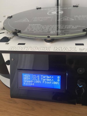

I'm also receiving this message now
Killed
Killed
