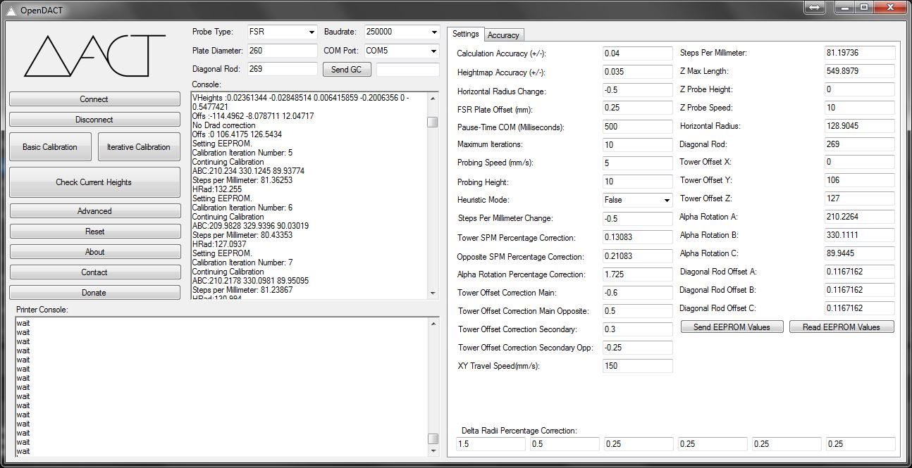

Hmm, this seems to be an exercise in frustration. When the tool does start behaving (see above post), it makes changes that are too drastic, ie a horizontal radius change from 127 to 134, which is way too high.
I'm also not sure why its necessary to change the steps per mm, as I've measured the movement of each axis and used that for my correct steps/mm.
Anyways, if it helps, here is the output from the console and printer console:
Console:
Spoiler:

Drad correction: 0.2749332
DRad: 0.6586004, 0.6586004, 0.6586004
Setting EEPROM.
Calibration Iteration Number: 5
Continuing Calibration
VHeights :0.293382 24.34864 0.146691 48.69497 0 48.50904
Offs :3778.03 3885.292 3924.998
Drad correction: -0.3667275
DRad: 0.2918729, 0.2918729, 0.2918729
Setting EEPROM.
Calibration Iteration Number: 6
VHeights :0.01845704 -0.1188768 0.001572028 -0.2007148 0 -0.5013885
Offs :-110.3297 -15.49543 13.0888
No Drad correction
Offs :0 94.83423 123.4185
Setting EEPROM.
Calibration Iteration Number: 7
ABC:210.1207 330.1639 89.91806
Steps per Millimeter: 81.46575
HRad:132.2069
Setting EEPROM.
Calibration Iteration Number: 8
ABC:210.2242 330.1121 89.94393
Steps per Millimeter: 80.78448
HRad:130.3144
Setting EEPROM.
Calibration Iteration Number: 9
ABC:210.1207 330.1552 89.92237
Steps per Millimeter: 81.40382
HRad:130.0064
Setting EEPROM.
Calibration Iteration Number: 10
ABC:210.1725 330.1811 89.90943
Steps per Millimeter: 81.19737
HRad:128.0801
Setting EEPROM.
Calibration Iteration Number: 11
ABC:210.1897 330.1466 89.92668
Steps per Millimeter: 81.15608
HRad:128.6242
Setting EEPROM.
Calibration Iteration Number: 12
ABC:210.1466 330.1165 89.94177
Steps per Millimeter: 81.17673
HRad:128.6756
Setting EEPROM.
Calibration Iteration Number: 13
ABC:210.1725 330.1639 89.91805
HRad:128.6423
Setting EEPROM.
Calibration Iteration Number: 14
ABC:210.1552 330.1984 89.9008
Steps per Millimeter: 81.11479
HRad:128.4351
Setting EEPROM.
Calibration Iteration Number: 15
ABC:210.2242 330.1208 89.93961
Steps per Millimeter: 81.38317
HRad:129.2351
Setting EEPROM.
Calibration Iteration Number: 16
ABC:210.1897 330.1725 89.91374
Steps per Millimeter: 81.21802
HRad:128.1182
Setting EEPROM.
Calibration Iteration Number: 17
ABC:210.2329 330.1596 89.92021
HRad:128.5982
Setting EEPROM.
Calibration Iteration Number: 18
ABC:210.11 329.7294 90.1353
Steps per Millimeter: 81.58962
HRad:129.0014
Setting EEPROM.
Calibration Iteration Number: 19
ABC:210.3299 330.1369 89.93153
Steps per Millimeter: 81.1148
HRad:127.335
Setting EEPROM.
Calibration Iteration Number: 20
ABC:210.7385 330.5105 89.74474
Steps per Millimeter: 84.04631
HRad:134.1114
Setting EEPROM.
Calibration Iteration Number: 21
ABC:210.2663 330.186 89.90701
Steps per Millimeter: 79.48389
HRad:122.7032
Setting EEPROM.

Jrjones
Posts: 106
Re: OpenDACT(Delta Automatic Calibration Tool) - For Repetie
Post by Jrjones »
After 64 iterations, the program froze, or does that mean it was done calibrating? Also, I think every iteration was worse than my initial height map.
Console:
Spoiler:
