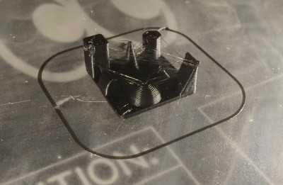

Guys... I need your help... :cry:
I've had my RMv2 for 5-6 weeks now, and I have spend the last three weeks trying to get rid of stringing with PLA. This is the best my printer can produce:
I feel like I've tried everything:
* Tried every temperature ranging from 160 to 210 degrees.
* Tried four different kinds of PLA
* Tried every extrusion multiplier from 1.1 down to 0.50.
* Tried Z-lift from 0.2 to 6 mm
* Tried with and without Wipe
* Retraction speeds from 25 to 100 mm/s
* Retraction lengths from 2 to 10 mm
* Slow and fast print speeds
* Small and large layer heights
* Tried Slic3r, KISSlicer and CURA
* Cleaned the extruder
* Lubricated the Bowden and nozzle with Canola Oil (yes, Canola Oil... https://groups.google.com/forum/m/#!top ... 5-false%5D)
* Polished the outside of the nozzle (thinking that the PLA might stick to the outside of the nozzle)
* Machined my own nozzles with different orifice diameters and lengths
* Machined a new PTFE liner
NOTHING helps :cry:
To start somewhere I have a few questions, which you are probably able to answer:

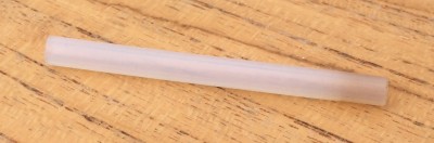

1. I took the hot end apart (again) to check the PTFE liner. Does this liner seem wrong to you?
2. When I assembled the hot end, I noticed that the nozzle is not completely perpendicular to the heated bed. I took the hot end apart again, and it seemed that the threaded part of the PEEK is a bit "crocked". Does this PEEK look wrong to you? Will issues with a molten PEEK result in stringing?

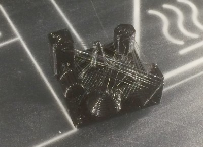

3. I have found that I have to print at about 175 degrees (the first picture was printed at that temperature). Isn't that kind of low?
4. I also see a lot of oozing. Is this related to stringing in any way?
5. By accident I found that if I turn the layer fan completely off, I get no stringing (??). Of cause that is not feasible, because the object will look awful. Any thought on that? What is actually the effect of too much cooling?
Please, answer any question you can - I really need all the help I can get :cry:

9. The PFTE liner doesn't look too bad. A little tapered but that shouldn't matter.
10. The peek part looks a bit mangled, probably from disassembly. Not terrible though, I don't think that should matter.

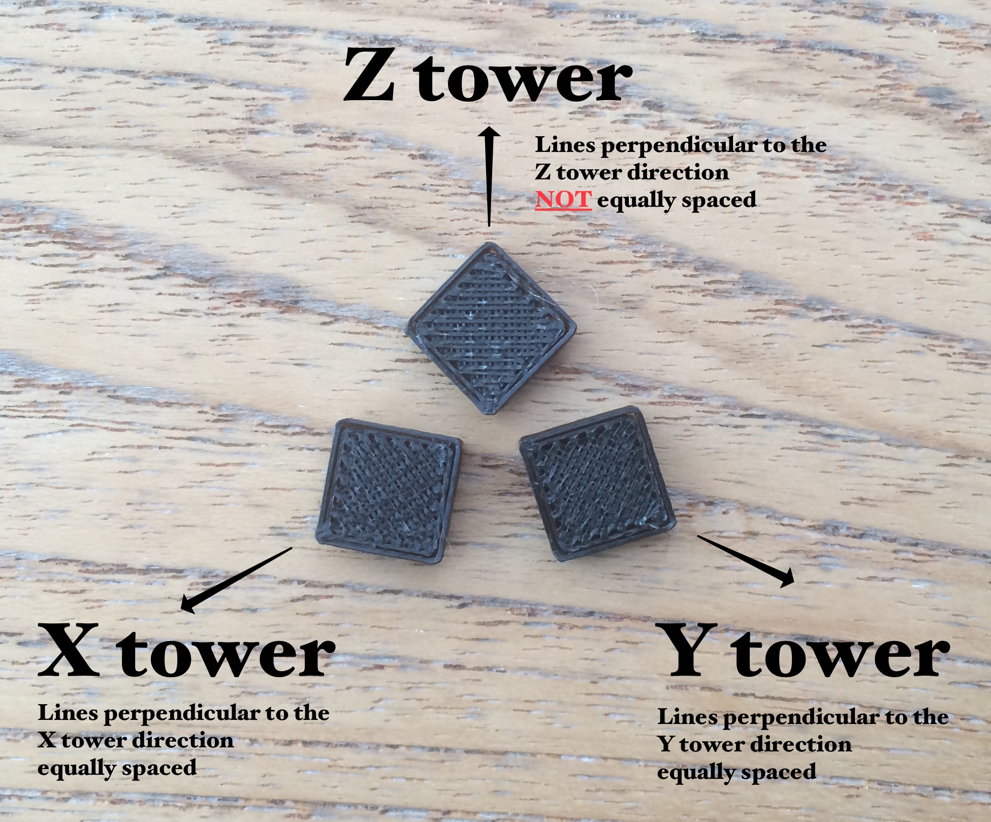

I went ahead with determining the best extrusion multiplier, so I drew a 10x10x3 mm solid box and printed it at various extrusion multipliers down to 50% (with KISSlicer and the settings that McSlappy suggested). I started to notice something "funny": The (clearly under-extruded) lines on the top surface were not equally spaced. So I rotated the box 45 degrees and printed it again, and now the lines were equally spaced. My printer seems to have a geometric problem, which I have to solve before I can determine the correct extrusion multiplier.
So... I printed three boxes each rotated so that I had the top layer lines perpendicular to each tower, and this is the result:
My guess is that my Z tower has some kind of problem, and I will take a deeper look into it. Do you agree with me on this?
Sadly I still saw a lot of stringing between the solid layers, but that will come in second...
BTW: I have attached the three GCode files (with 50% flow to exaggerate the lines), if anybody else wants to do this test ;)

I finally found the culprit causing the last bit of stringing that I've been struggling with: Z-lift, Z-hop or whatever it is called. I disabled the Z-lift (lifting the head when retracting), and ALL strings disappeared. For some reason I thought that Z-lift was invented to decrease stringing (because the strings would break), and to avoid having the nozzle bump into corners curling upwards. The latter is true, but Z-lift turns out to be causing the stringing - at least with my printer and my filaments.
My theory is that the hot plastic just printed "sticks" to the plastic inside the nozzle orifice, which is pulled out of the nozzle, when the nozzle is lifted. The plastic sticks to the outside of the nozzle, and this becomes strings, when the nozzle is moved somewhere else.
Now, I am able to print every kind of PLA I throw at it using the same settings without having ANY string. My settings are:
