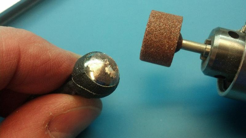

Sure thing Flateric, I will show you some pics I think you will see. The balls are the magnets. JB weld to Adhesive glues the mags to aluminum.

The magnetic ball ride on a Teflon bearing pad. With 2-3 pounds of force there is almost no measurable friction. Something that I think is important to pay attention to is the positioning of the balls when JB welding them to the aluminum sockets so that they are located naturally north or south on the poles. You can feel the difference it in the way of counter force if they are not in alignment. When you watch it in action you can see that they move so little I am thinking they will last for years. Then the bearing replacement is nothing more than a small Teflon disk I punch out of this material I purchased from McMaster Carr: 76025A333 Its enough for material for 10 lifetimes! I believe there is nothing that will come close to giving the precision the magnet joints can provide for so little money?

Glad to help Buddy! I made mine with these: http://www.fridgedoor.com/maspd03.html These are very special!! Super mags. And some of these from McMaster Carr: 91259A546 I just used a 1/2" ball endmill to machine the socket in them. Post link of the ones you found and let me take a look?

I like the Teflon bushing. Pretty simple solution to friction. Any issues with the Teflon being cut from a flat sheet then placed in the cup of the socket?
Out of curiosity is there a reason why the ball is magnetic versus the "socket"? You mentioned a polarity influence on the joint. If the ball was steel and the socket was magnetic there would be less influence to polarity but not sure how to accomplish that with off the shelf parts like you have.
