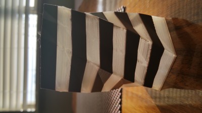

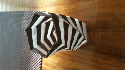

got the cyclops up and running, after figuring out chimera with s3d, this is my first attempt at a print... no tweaking has been performed yet.
[img]https://lh6.googleusercontent.com/-l7ov ... 001759.jpg[/img]
[img]https://lh4.googleusercontent.com/-lW8F ... 001921.jpg[/img]
[img]https://lh4.googleusercontent.com/-aZGU ... 001859.jpg[/img]
[img]https://lh4.googleusercontent.com/-gwvM ... 002533.jpg[/img]
extruder 1 is clear and doing perimeters, extruder 2 is brown doing infill.

rpress
Posts: 178
Joined: Fri Oct 03, 2014 1:35 pm
Re: man sized
Post by rpress »
Nice job, good to see some more cyclops prints.
The volcano seems like a great fit with your machine. What kind of mm^3/s are you getting out of it?
bubbasnow
Posts: 1061
Location: Dayton, WA
Re: man sized
Post by bubbasnow »
Seems like the actual velocity of the head hasn't changed much. But if u take pla for example and increase the nozzle temp to 250, I am easily able to extrude heights up to. 8mm at 30 mm speed with the 1.2mm nozzle. Which would be 4 to 8 times faster prints. I hooked it up and started printing with minor changes in s3d so since further optimization is still require.
rpress
Posts: 178
Re: man sized
Post by rpress »
So 0.8mm * 1.2mm * 30mm/s = 28.8 mm^3/s which is great! I can get maximum maybe 13mm^3/s from my v6.
I'm building a new printer and it's going to get the Volcano, I'm excited to try it out!
