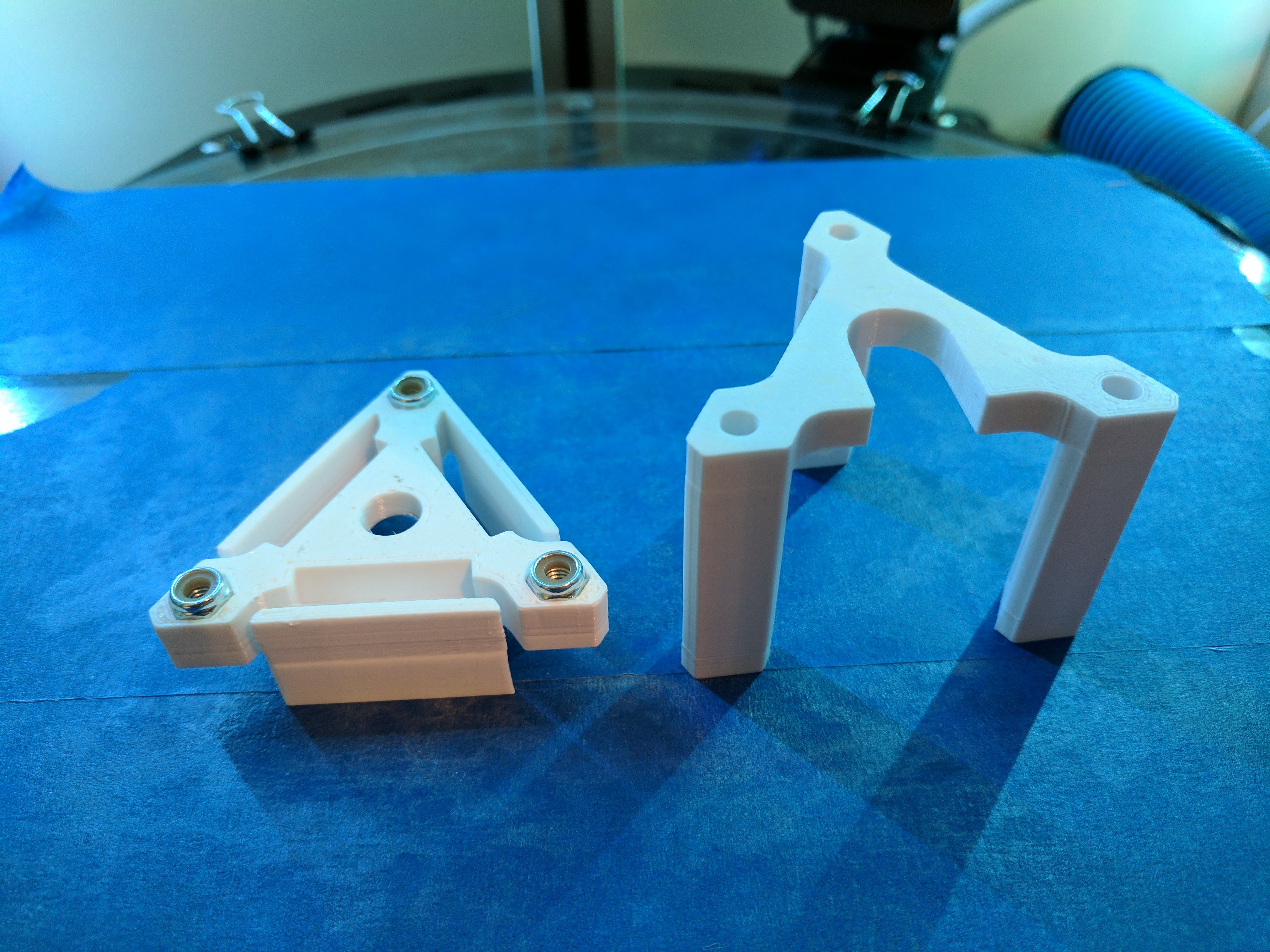

Well Since we're in the spirit of giving, I'll throw out my effector as well. It Doesn't have any cool tricks up it's sleeve. just small light and full of mounting hole options. If i ever stop printing ABS i may do something different.
- Effector V2.stl
- (1.97 MiB) Downloaded 1012 times
Thanks for sharing, those look great!SEBRET wrote:Well Since we're in the spirit of giving, I'll throw out my effector as well. It Doesn't have any cool tricks up it's sleeve. just small light and full of mounting hole options. If i ever stop printing ABS i may do something different.

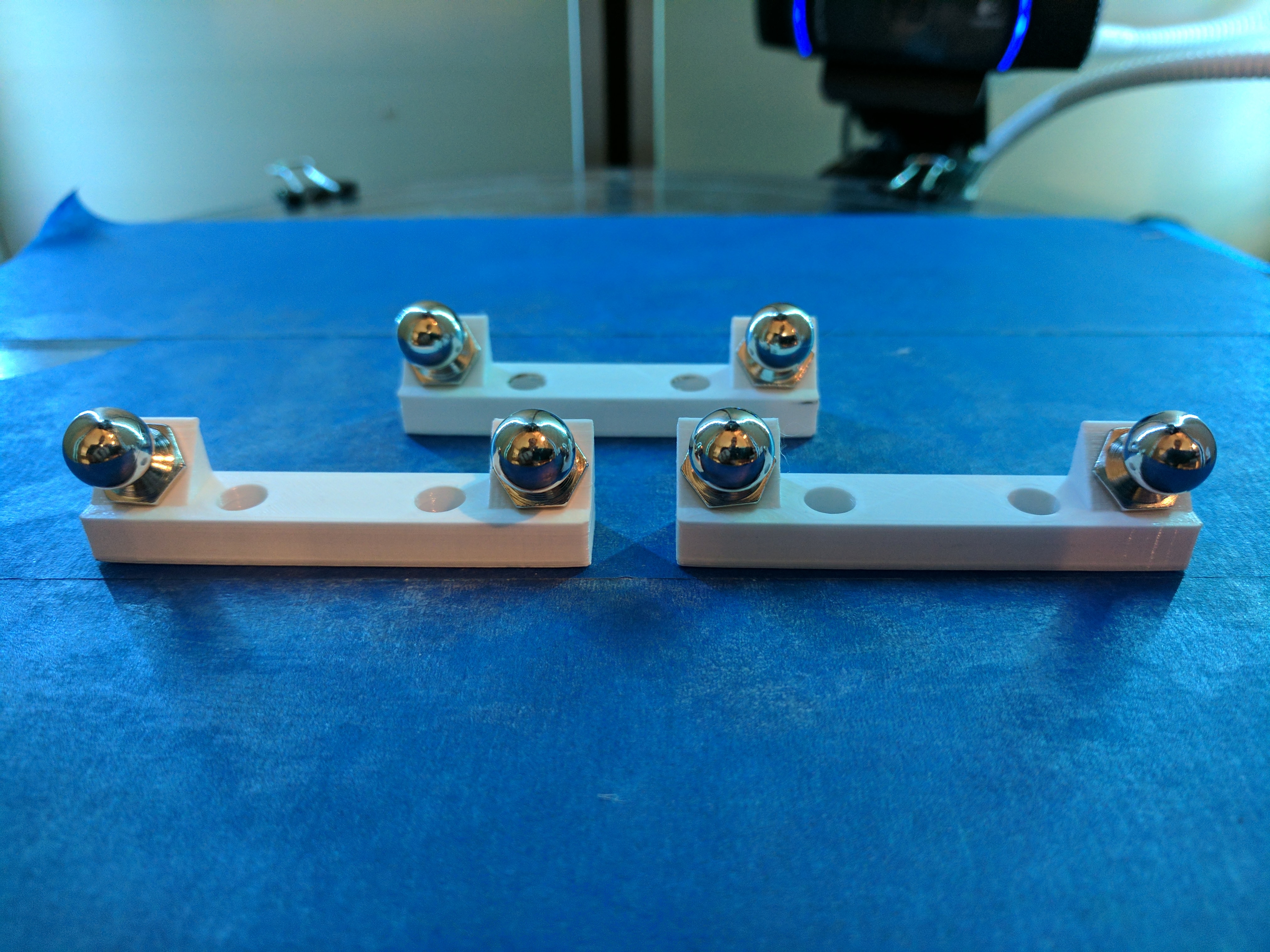

Anybody using the new cheapskates with the mag arms? The holes to mount the magarm holders to the cheapskates are in the wrong places for the new cheapskates.
I believe most of us just whipped up an adapter. I did this as well but moved to the new ball cup arms rather quickly. I may revisit the magarms soon thoughFiddler2070 wrote:Anybody using the new cheapskates with the mag arms? The holes to mount the magarm holders to the cheapskates are in the wrong places for the new cheapskates.
Here's another example. I used the cheapskate.scad from Xnaron's github as the base. You can modify the ball_sep variable from 46 to probably 50 mm without modifying the file further. Right now it's set to 48mm.

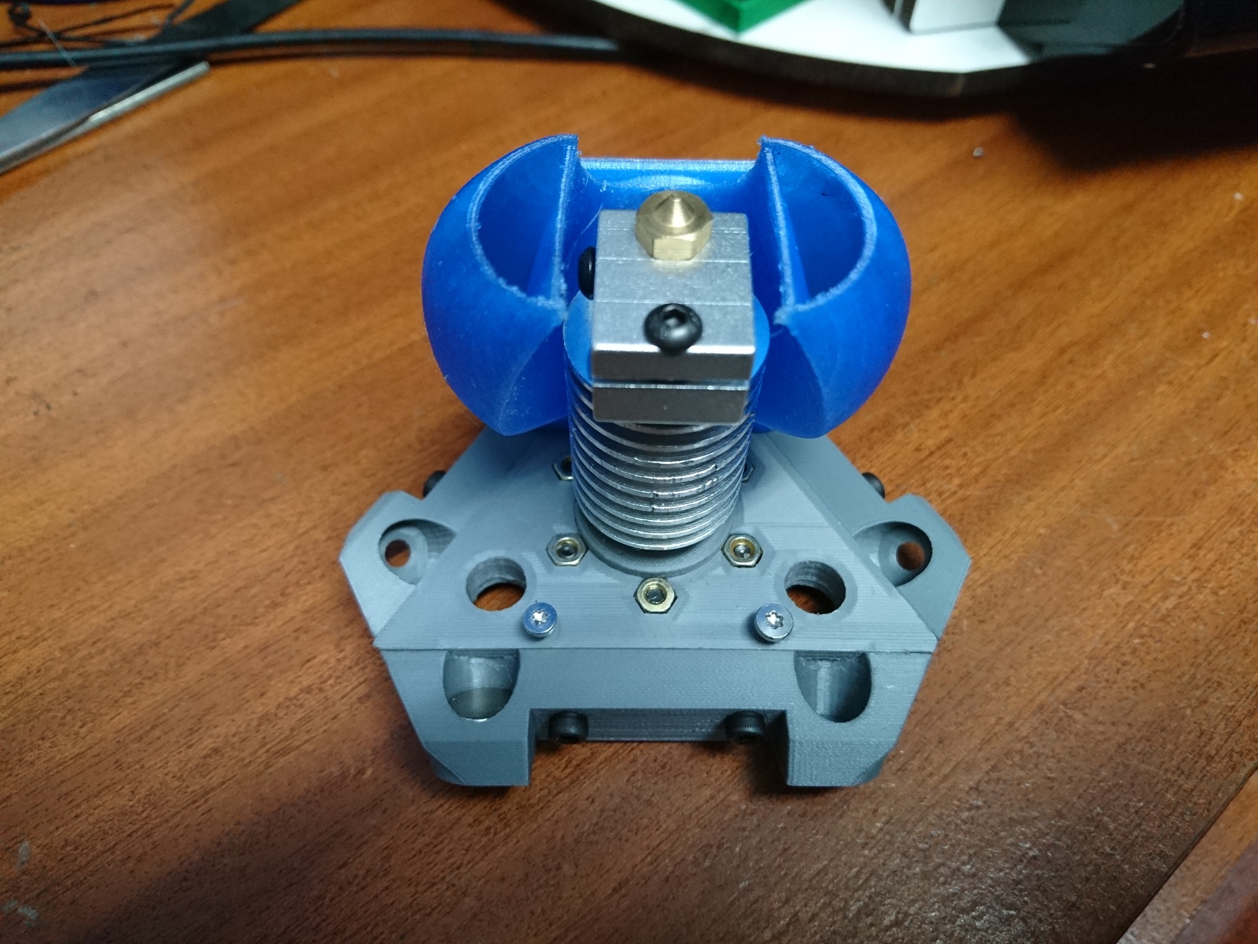

Can someone mod the effector from bLITzJoN or Jimustanguitar to be used with Xnarnon's magnetic arms = http://www.thingiverse.com/thing:153055.
My cad skills arent what they used to be 15 years ago.
BTW if all of you are running 3 fans at say 15% why not just design one where one runs a 40mm fan at a higher % and adjust the airpaths diameters to equalize the air pressure.
Save weight and wiring or would that create an imbalance at the effector level.
Figure pick one side and make the fan vertical in front of the hotend fan to assist or above it to cool the filament tube as well, mostly centered to keep its mass between the arms and within the effectors ring.
Vertical like this; http://www.thingiverse.com/thing:1792867 but one bigger fan ducted into the effector base, like the upper half of this: http://www.thingiverse.com/thing:431310
