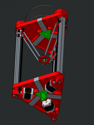

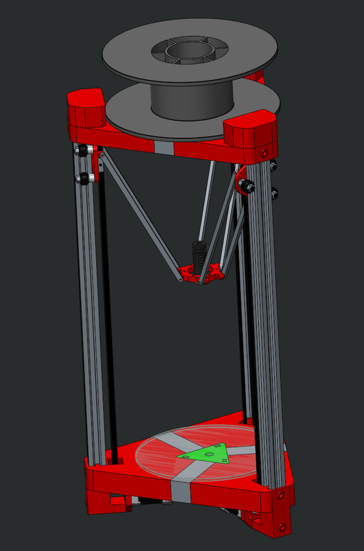

Anyway...here are a couple of rendering of the printer as it is right now. Definitely not complete yet, but I was itching to show off the work so far.

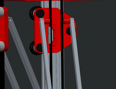

My new belt clamping design for open ended belts...
Even with the 25mm extensions to the 3 main frame plates, the entire printer still fits inside a 290mm circle (or a 10.5" x 9.2" rectangle if you prefer).
