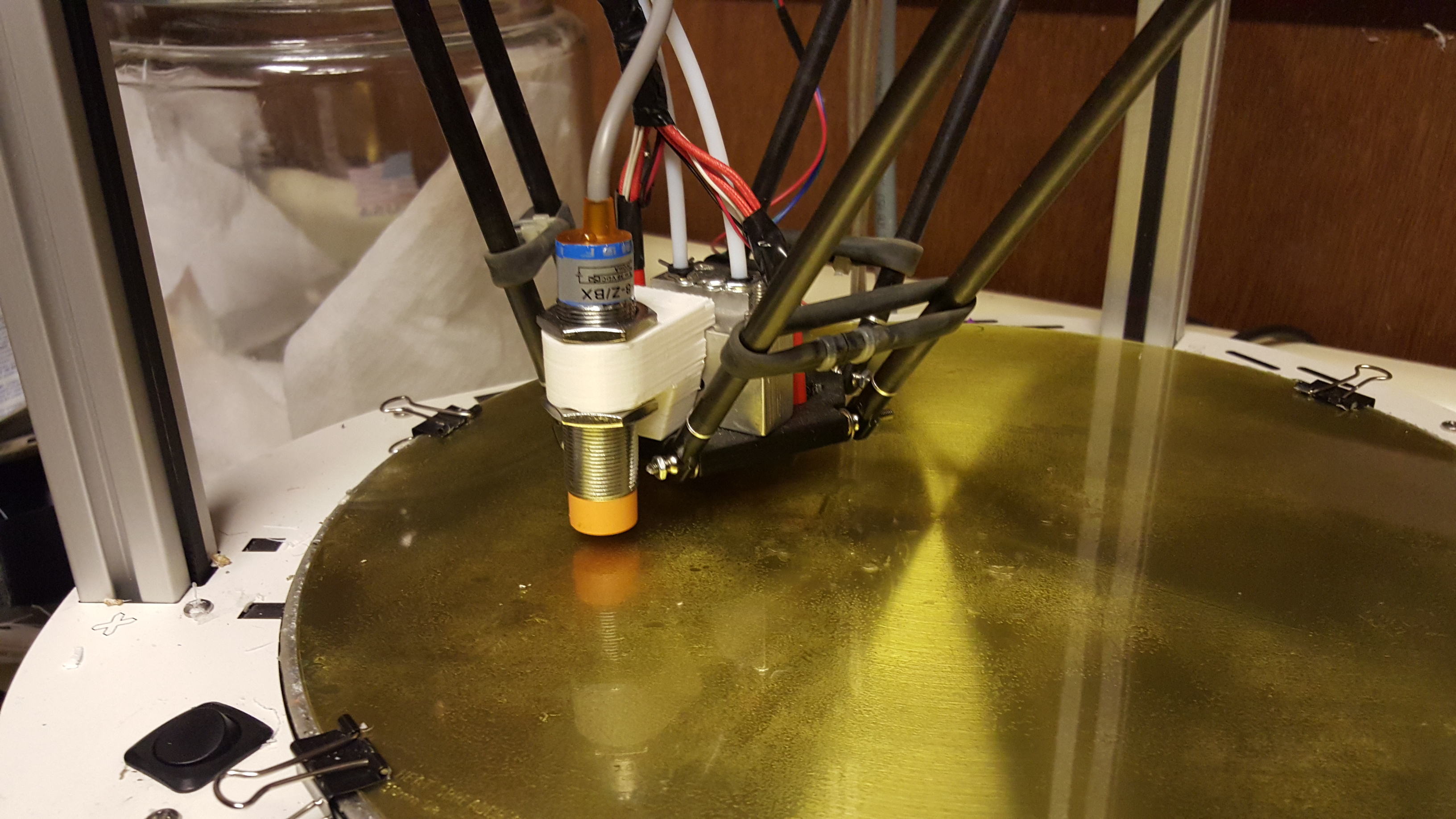

Well I got my inductive proximity switch ($4 from amazon :D ) installed and working as a Z probe, and I think I have the calibration working... sorta....
As far as i can tell, the probe is functioning properly, plus it can ride along during prints since it is ~1.5mm above the nozzles :D
I think i got it to calibrate decently, within whatever default tolerances. And my prints seemed to improve quality as far as smoothness and such.
Couple questions:
First things first, I need to redesign my sensor mount and/or platform since when it is extremely left or right the arms will hit the mount if i have the "build diameter" in opendact set where it realistically should be, currently i am using 150mm as my diameter. Does the build diameter box just tell the magic program what diameter circle to probe points on? such that obviously spreading the points out further will give a more accurate calibration to scale the movements off of. Or am I basically just making it look like its doing fancy stuff for science and not really accomplishing what I hope? haha.
My probe switches approximately 1.4mm from the nozzle, (i.e. when the probe is triggered, the nozzle is at 1.4mm above zero.) can I adjust this with a probe offset? I tried simply putting 1.4 or -1.4 in the probe offset in the firmware or in the program advanced settings, but I'm not sure if by putting the -1.4 the firmware and/or program was like ERR-RORE. ERR-RORE. DOES NOT COMPUTE. and at one point set the arm length and horizontal radius to 0 and just kinda gave me the finger until I reset the eeprom values to 325 and so on. Currently I just put all the probe height offsets to zero and let its do its thing, and then set my z-height with a feeler gauge since it thinks zero is 3+mm in the air.
Is this making sense or am I reinventing a dead horse mid-stream?
It seems like I'm close to having it working all hunky dory but I'm just not sure if what I'm guessing at what settings impact what effects the outcomes the way i think they do.
So, when i open the program, i enter build diameter, arm length, com port, connect.
open advanced, change to z probe, zero out probe height and fsr plate offset,
then i hit set variables - do i need to do this? like its an "apply settings" sort of button?
then i hit calibrate, and it homes off the top endstops, and travels down at probing speed (5 mm/s) until it touches once, and all the way back up, then the second and so on times, it rapid travels to my "z-probe start height"
does the same thing if i hit calibrate, or A.I. or H.A.I. doesn't seem to make much of a difference.
Since my sensor is approx 50mm (y-) away from the nozzles, i put that offset it so that the point circle is centered on the plate. this causes it to move to point, then compensate for my nozzle 1 offset, and then the 50mm probe offset, (at least this is what I'm guessing its doing) not a big deal, I'm just curious if it's like, oh no I definately have 3 offsets that are conflicting and fighting each other.
I would attach the console text but I don't want to post a mile long of it if its totally useless if I'm doing something way wrong, but if you guy's have any pointers for me I would be very grateful!
Keep up the good work!
-Peter

I seemed to have best luck with my inductive sensor with only the Y offset, i left the z height offsets at zero and manually set my height after, otherwise i think it was compensating (or trying to?) for the height offset in the math and was generating some 1.21 gigameter offsets.
I will hopefully be at it again tonight so I will post any updates.

So wait, quick question, I have an inductive prox sensor on my platform that "switches" when it "probes" the bed, I have been using the "z-probe" setting. I have the sensor wired in as a "Z_min endstop" and still have all my upper travel endstops in place and unmodified. Should I be doing something different? like, by telling it to use z-probe vs FSR, while still being equipped with endstops, is this contributing to adverse side effects?
Well if I were to assume the issue is coming from the probing choice, then it would most likely be that the Z-Probe method has an error - which I am fairly sure it does. You can use the FSR setting, but you will most likely have to modify the FSR offset to find your specific offset - i.e. the distance from the bed that it triggers. Or just calibrate with the default and set your zheight manually after the calibration has finished.

What I did was brought the platform down to the bed, and adjusted the sensor so that it trips when the nozzle touches, such that the sensor is theoretically zero with the nozzle. So you think I should try the FSR option when I get home from work?
RollieRowland
Posts: 226
Joined: Fri Jul 17, 2015 5:30 pm
Location: U.S.
Re: OpenDACT(Delta Automatic Calibration Tool) - For Repetie
Post by RollieRowland »
CaptainMerica wrote:What I did was brought the platform down to the bed, and adjusted the sensor so that it trips when the nozzle touches, such that the sensor is theoretically zero with the nozzle. So you think I should try the FSR option when I get home from work?
Yes, try the FSR option and let me know what you find out.
