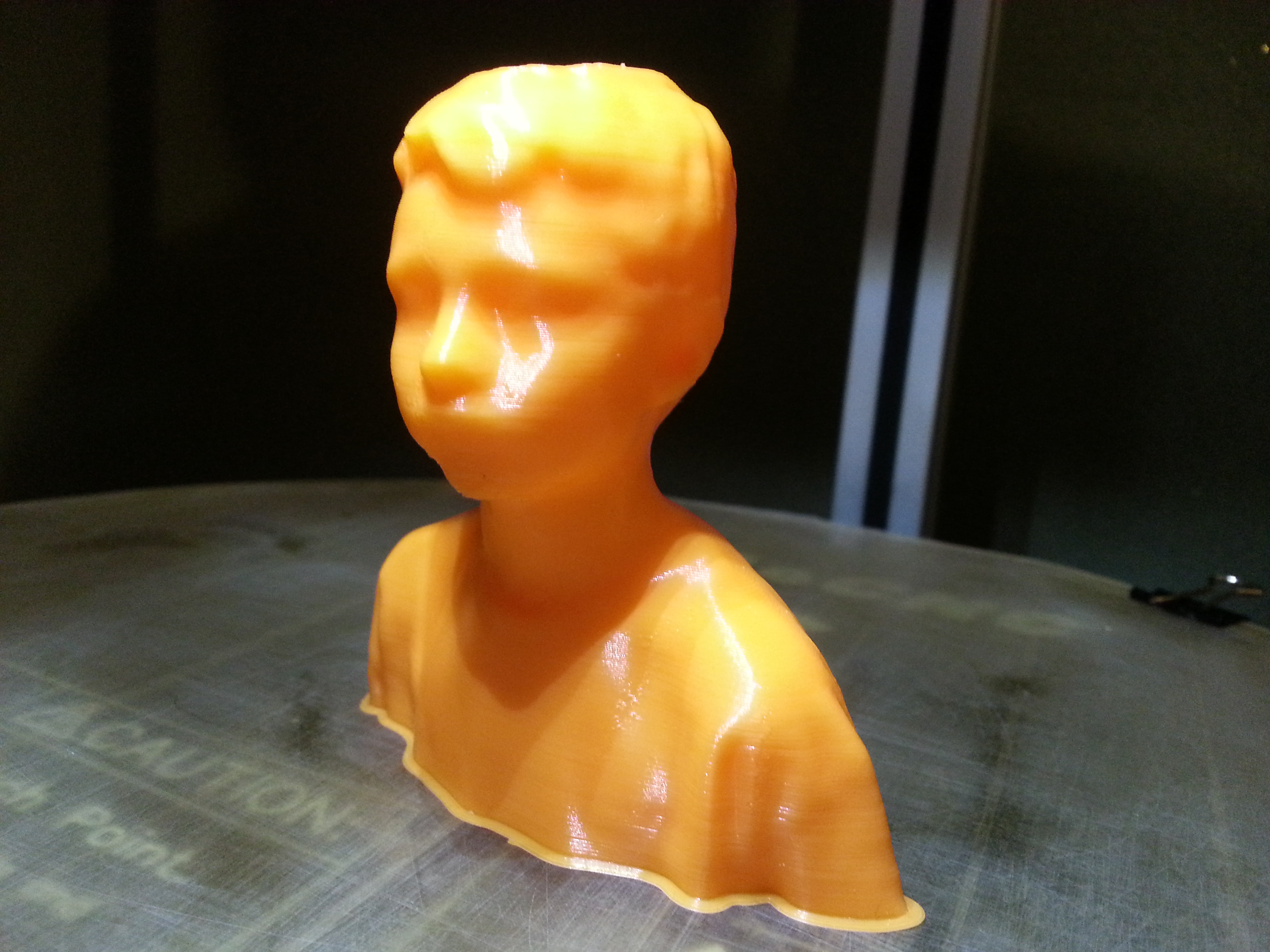

I have the structure sensor. It works fine as long as your expectations are reasonable. It helps if you have a pretty high power laptop to pair with it for better quality.
This is a scan of my daughter at about the best resolution I could get. Ignore the banding, was having printer issues.
