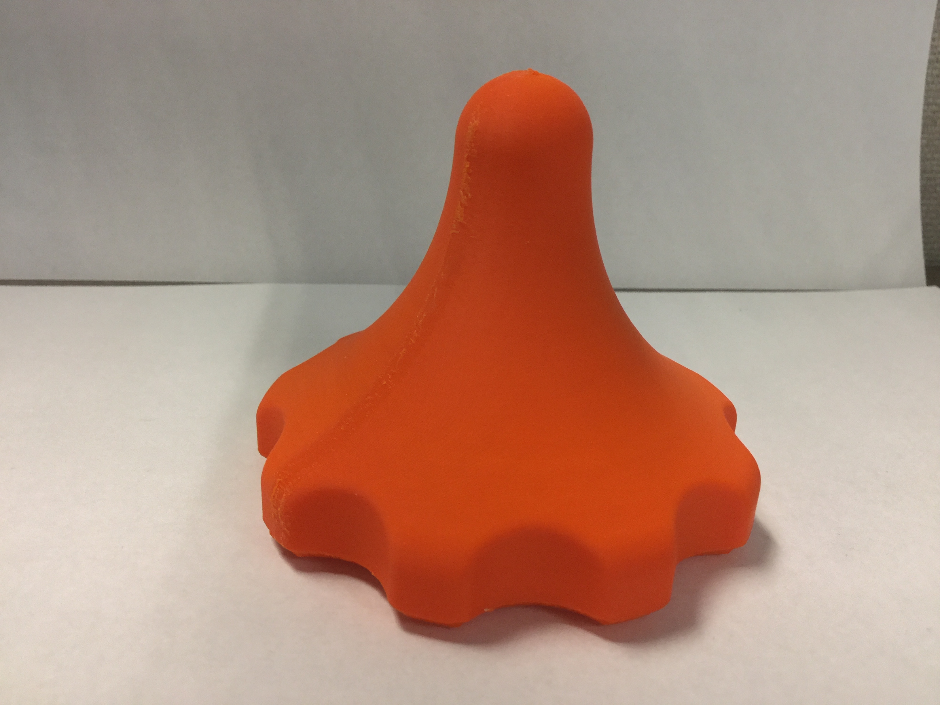

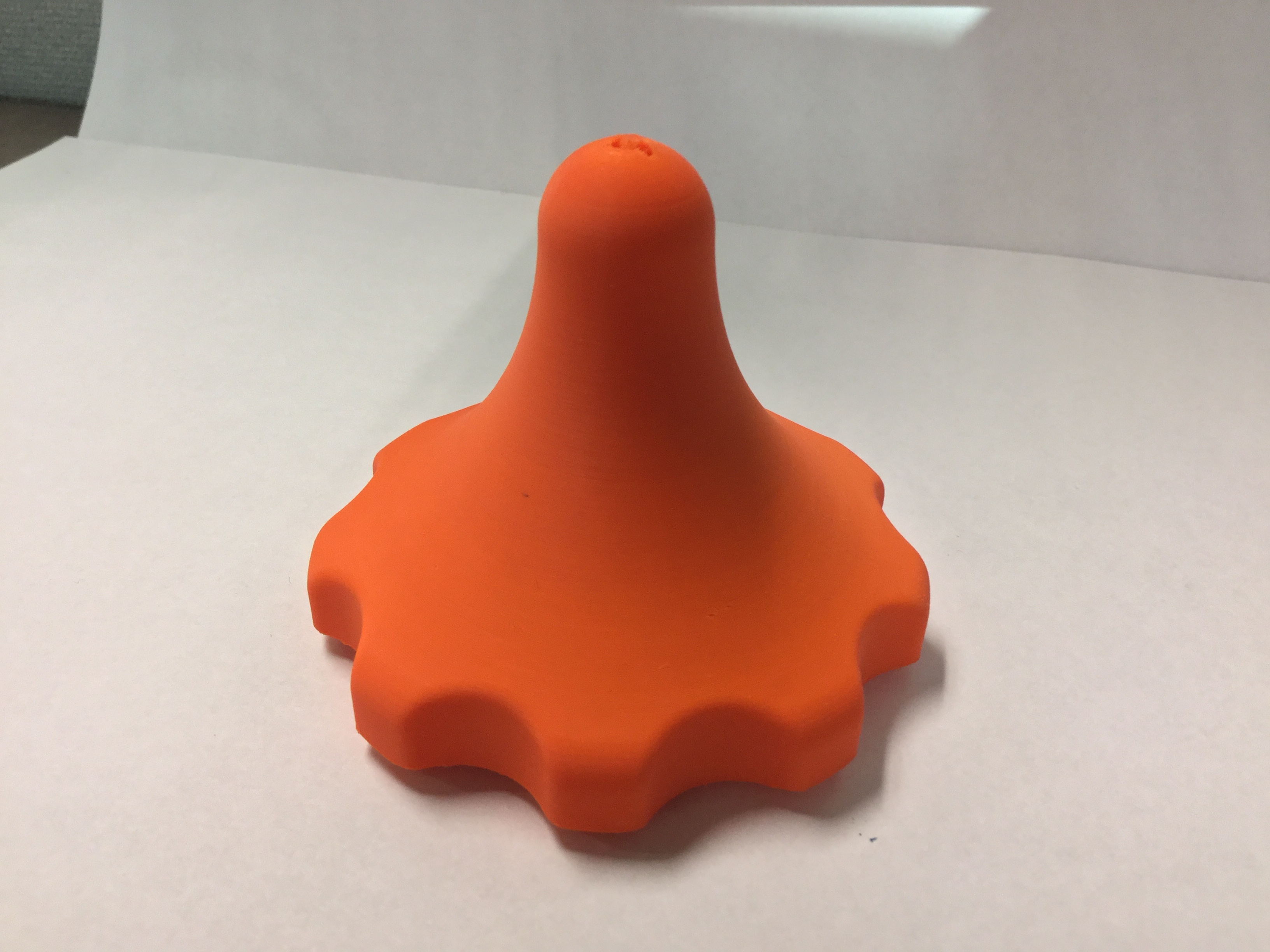

So far I've only printed the knob. This is by far the smoothest finished part I've printed. It came out great. I may reprint with a higher infill and more retract to smooth out the seam. I also need to slow the speed and lower the temperature on the top (Didn't come out perfect).
The Nylon lock nut fit perfect, just snug enough to hold it in and require some force to be pulled out. I think when I get I get it assembled, I'll glue it in.
Some of the settings I used.
Prometheus V2 Hotend 0.4mm Nozzle
2.30mm Retract 30mm/s
5.00mm Wipe
0.15mm First layer
0.10mm Layers
3 Shells
25% infill
35mm/s
100C Bed
237C Nozzle
This was also my first print on PEI, stuff is amazing!

Thanks about the print. This is the largest 0.10mm print that I have done. I guessing the geared stepper has something to do with it because I've never had a finish like this before. I would do all my prints this way, but 0.10mm layers do take a while to print. That knob took about 7 hours at 35mm/s.
