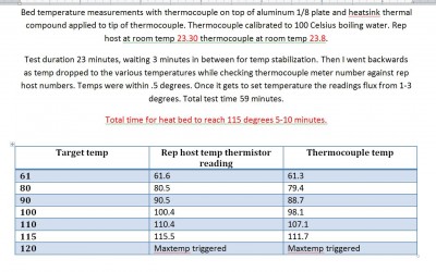

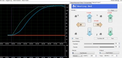

So I redid the bed temperature test after some changes here is the result. Will redo the hotend temperature test. later tonight.
Edit: got side tracked and didn't get to the hotend test, will pick up again tomorrow.
temperature graph, waited for the bed to reach room temp. rep host temp 24, thermocouple temp 24.5
Total actual time shown from room temperature to 115 degrees. Note: I am using a dedicated 24v 750watt 31amp Meanwell power supply with ssr to control power to my onyx. rambo board is run off stock 12v power supply and using marlin firmware. (stock firmware with no changes) I did another test with repetier firmware installed. Heat up to 115 took about the same amount of time. One thing different about repetier firmware (stock firmware with no changes) is that it did a better job of keeping the temperature steady. less temperature flux. graph shown below.

WOW!! 110 degrees in just over what 4 or 5 minutes?!?! Awesome, looks like that one is dead on.

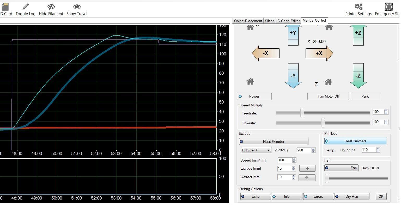

I read another post that repetier firmware has faster heat up times. Although 4 minutes to 110 is pretty good for me, I might try it just to see the difference.
when i was troubleshooting my lcd issue, swapping firmwares around, I'd forgotten that marlin firmware was reinstalled.
this gives me a good baseline reading to determine what temperatures i need to set in the host software to get my bed to required temperatures.
for example: if I wanted a bed temp of 110, i would need to set the temp in host to 115 or so because actual bed temp of aluminum is a little lower.(with marlin firmware)

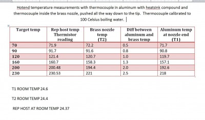

Alright i finished up the second test for the hotend measurements according to forum suggestions. This time using repetier firmware because it just seems to hold temperatures better.
Something to note from the measurements is that the temperature inside the brass nozzle starts to drop off at higher temperatures, Maybe because the aluminum is doing its job and acting like a heatsink to take away heat?? or some other factor is at play here.

FWIW the AL heater on my hotend is wrapped with silicon tape and I find it seems to perform better.
I didn't really wrap it to improve performance, I did that because the rather large fan I had blowing across the print was preventing the hot end reaching temperature.

That looks a lot more "normal" to me, changes to the Therm table or just altering the expectations should get you there.

foshon wrote:That looks a lot more "normal" to me, changes to the Therm table or just altering the expectations should get you there.
I just complete the pid autotune for both hotend and heatbed. now the temperature stays more linear. nice

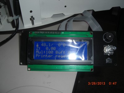

Cambo3d,cambo3d wrote: ....now all i need is my lcd to work..
So you've checked your connectors soldered to the RAMBo to SmartController Adapter and they showed continuity. And you're getting text in the upper leftmost corner of the LCD but "the dreaded white boxes" everywhere else?
You might try removing your adapter from the RAMBo board. Then, look carefully at each connector on the Adapter to ensure that a pin/socket is not bent or deformed. Then, look carefully at the headers on the RAMBo board to ensure a pin is not bent or "pushed" down through the board such that it might not contact its mating socket on the Adapter.
I work with LCDs frequently; I have not looked closely at the ones we have on our Rostock MAXes. But the fact that yours is "trying to work" suggests an incomplete connection/circuit.
You might also look at your solder joints with a magnifier. A "cold" solder joint may demonstrate continuity but might not work in a live circuit. A solder-starved joint can behave similarly. Touch-up each solder joint with a "pencil tip" on your soldering iron just to ensure the solder "flows" into each connection.
Just a couple of thoughts. Good luck!
Bill
Re: Another rostock max build
ive done all of this..

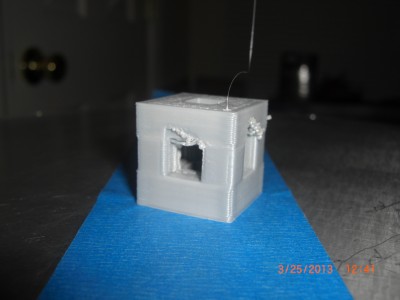

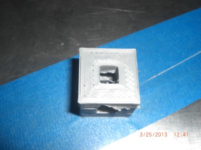

just did my first print, the calibration cube following geneb's manual. This is where all the 2 weeks of assembly time start paying off. While the print isn't perfect. I'm excited that it printed something.
for some reason i had to add in a z offset, otherwise it would get to close to the print bed, I put in 1 mm as a guess it seems to print it. probably need to adjust that.
Please critique this print and recommend suggestions on how to get a better print. THIS IS MY FIRST PRINT EVER!!! WOOHOOOOO

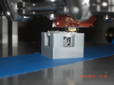

started to print another cal. cube today but it started off worse than before.
so after spending some time troubleshooting I found that the screws for the heatbed were loosening up. probably due to the heating of the bed.
darn.. now I have to recalibrate the bed height again...wtf. this time i'll throw some lock tight on it.

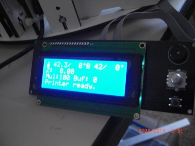

Good news though I GOT another LCD to try out, from a local 3d printer dealer here in florida, before I sent the seemecnc lcd back.
The new lcd works. SO YES I DID HAVE A BAD LCD! http://forum.seemecnc.com/viewtopic.php ... &start=130 SEEMECNC YOU HAVE A RETURN ON THE WAY.
Glad you got it working! Had to be quite frustrating.
Good job!
Good job!
