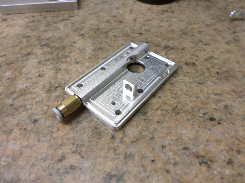

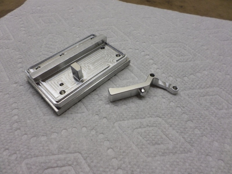

I managed to break away from my normal production parts and make a little progress on my extruder project. Just a couple of update pics.

A little more progress tonight. The back plate is 6 different ops (setups) and 16 tools. Seems like a lot for such a small part, but necessary nevertheless. All I need to make yet to test it is the pin that the quick release lever pivots on. Hopefully tomorrow.

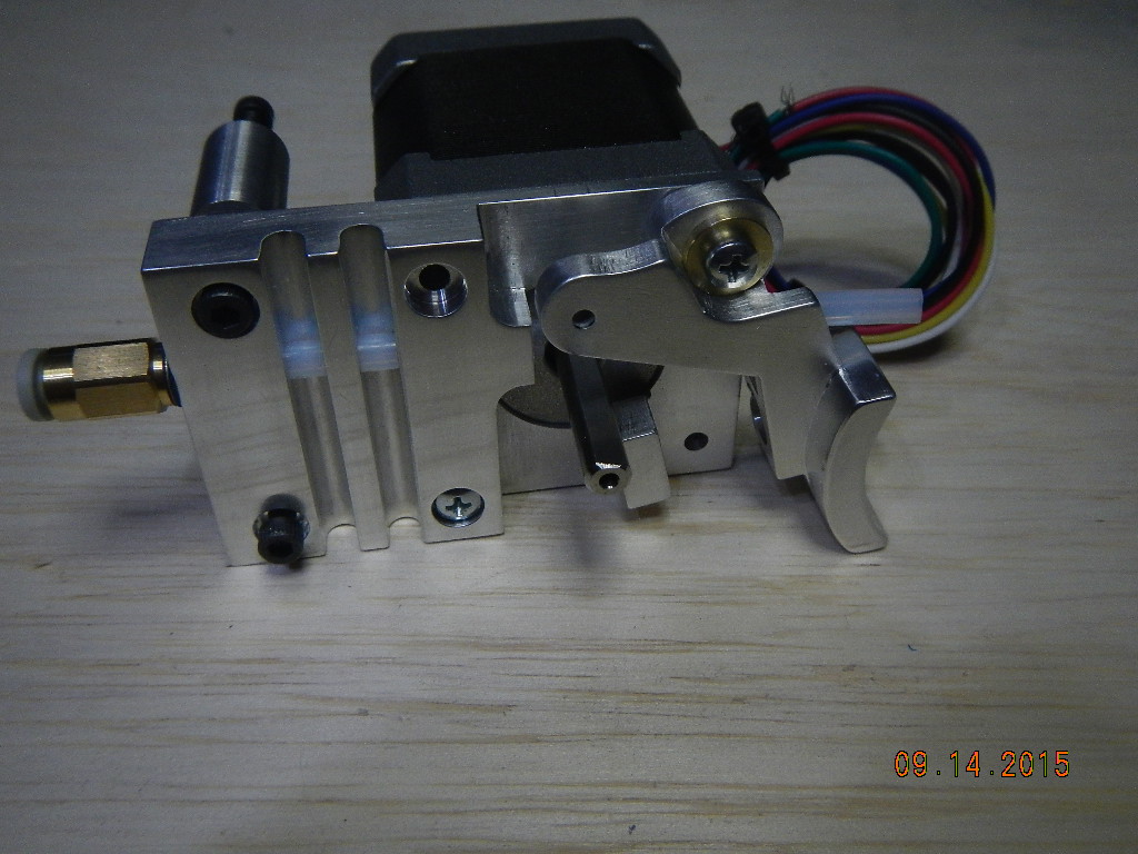

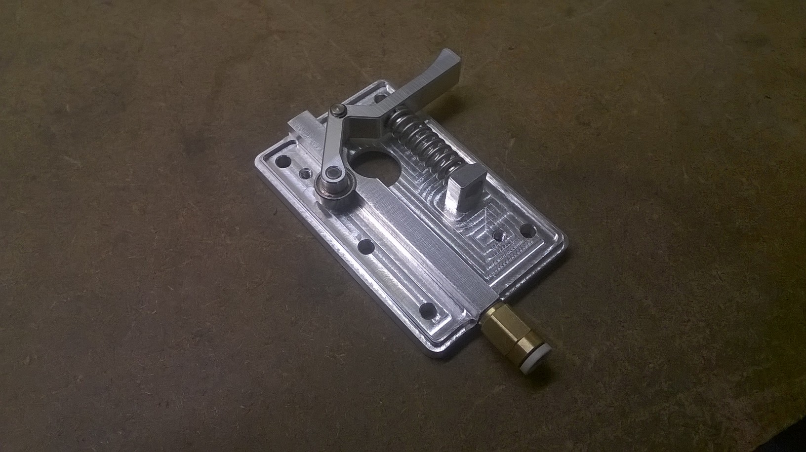

I got it to the point of where I can actually test it out. I think a couple tweaks will be necessary, but nothing major. The filament is truly encapsulated entirely. This should help greatly with jamming of flexible filaments.
http://www.benchtopprecision.com" onclick="window.open(this.href);return false;
E3D V6 Mount -->> http://benchtopprecision.com/e3d-v6-mou ... tockmaxv2/" onclick="window.open(this.href);return false;
BTP
Posts: 44
Joined: Sun Nov 23, 2014 11:44 am
Re: All Metal Extruder
Post by BTP »
Okay so a little update. I mounted the extruder to the printer for testing and everything fit great. However I highly under estimated how much pressure needs to be applied to the filament so that it doesn't slip and has enough grip to force it thru the hotend.
The next iteration will need two design updates. First being the spring seat will need to be moved up towards the stepper motor more to compress the spring resulting in more pressure on the idler bearing. The second change will be the cutout for the idler bearing. The idler bearing needs to be touching the hobbed drive gear, it currently does not touch.
I think with these two improvements it should work flawlessly. More to come soon.

draw-tech
Posts: 44
Joined: Fri Apr 10, 2015 5:23 pm
Location: Brooksville FL
Post by draw-tech »
Hi BTP
Funny you should mention spring tension. I have been using my extruder and working great,______ Until i tried to print some T-glase, it started to slip. It did not take much movement of the spring to increase the pressure on the idler bearing. So I added a .05 thick disk under the spring, and put an adjustment screw to accommodate any filament.
The second change is the release arm, to expensive to make, so I made it CNC friendly and the pocketbook a little fuller.
You can see the pad under the spring.
Jack
