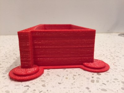

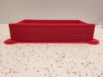

Mouse Ears worked great! Big print--my best results so far
Happy with results.

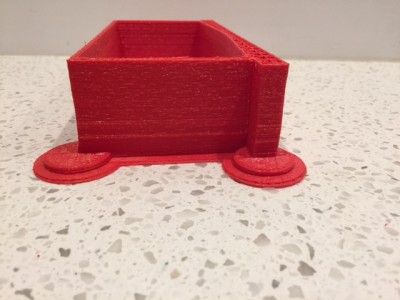

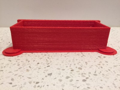

The walls and edges are a bit wobbly--is that because I had the "refinement" (Fusion 360) set on "medium"?

0.5mm layer height is really high unless you have a large diameter nozzle. What size is your nozzle?
If you are using the stock 0.5mm nozzle, I would suggest a layer thickness between 0.2mm and 0.35mm. The general rule of thumb is max layer height = 0.8 * nozzle diameter.
Lower layer height will increase the "squish" between layers which should improve layer to layer bonding.

Yes, 80% of nozzle diameter is the community standard for max layer height.
It isn't all about cosmetics either. It makes a stronger and more dimensionally accurate part.

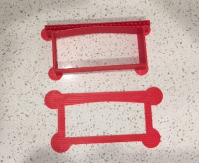

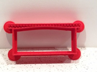

Also, you can go thinner with the mouse ears. Diameter is fine, but the thickness looks about 2x thicker than it needs to be.
Re: Mouse Ears worked great! Big print--my best results so f
Okay.
They're 3mm.
I suspect I don't need the raft, as well...
They're 3mm.
