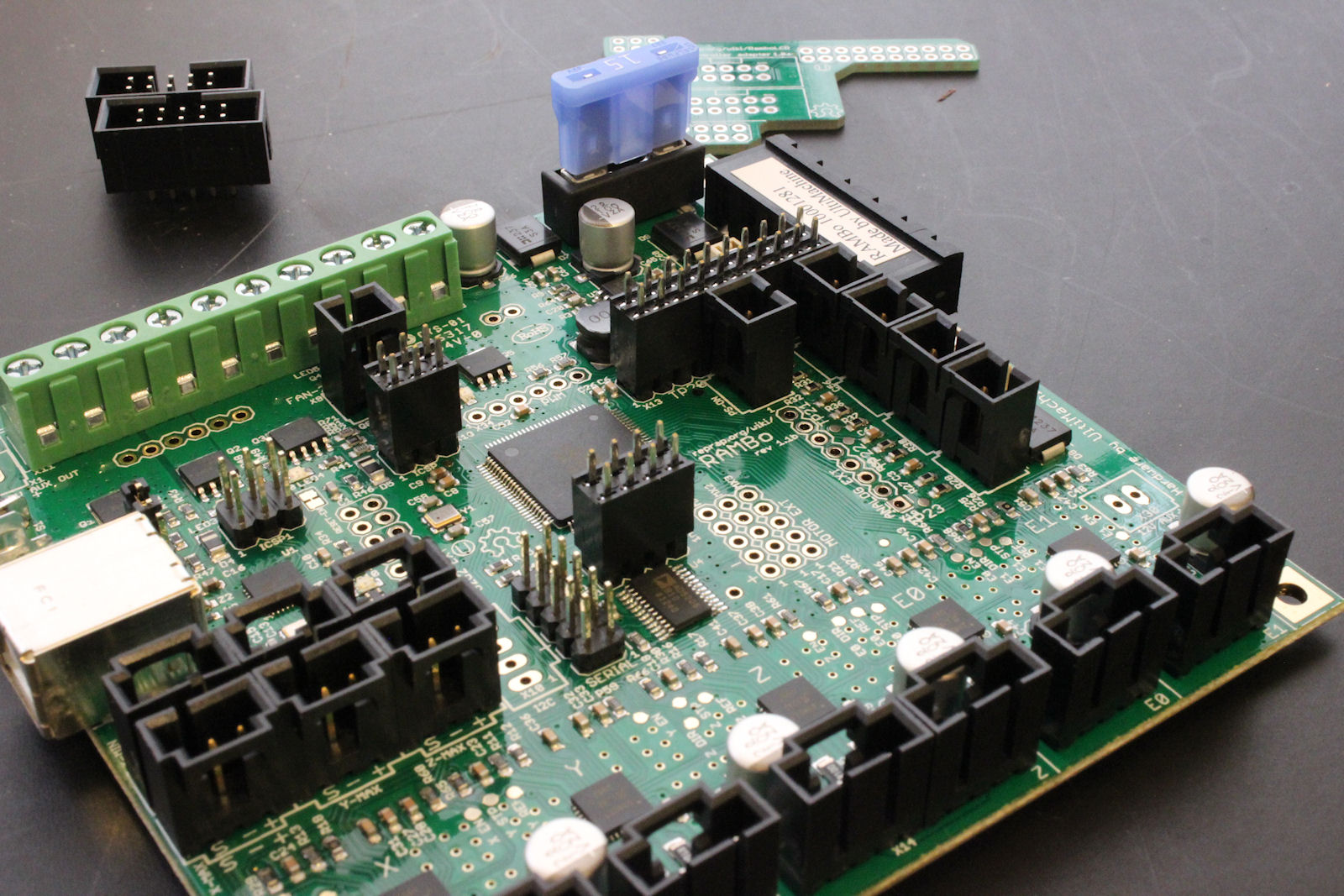

Here is a quick photo of the new RAMBo to LCD SmartController adapter (version 1.0a):
The two 5 pins X 2 rows shrouded headers mount to the silkscreen side of the board (you can see their outlines on the silkscreen). All of the other connectors (the ones I have "standing on their faces") attach to the bottom of the board.
I'll have complete build instructions available later today.

Here is how I constructed the board. I used a Weller WES51 soldering iron fitted with a long reach conical tip (a needle-looking tip). I set the temperature to appx. 720 degrees F. I used .022" diameter solder.
I slipped the 3 X 2 connector onto the ICSP header on the RAMBo. I then slipped the 4 X 2 connector onto the SPI header and the two 1 X 10 connectors onto the EXT-2 header. Here's a photo at this stage of construction: I then slipped the adapter PCB over the pins of the four connectors to ensure that the pins were centered: Once I was satisfied that the "fit" was good I soldered each of the pins to the PCB. Fitting and soldering these parts this way ensured that each of the connectors was precisely aligned to the headers on the RAMBo. Once I had all of the pins soldered I gently removed the pcb/connectors assembly from the RAMBo and soldered the two 5 X 2 shrouded headers to the silkscreen side of the board. I then inspected the solder joints under magnification to ensure they were all good. I then trimmed the excess from the connector pins close to the surface of the board. Here's a photo of the completed assembly as it fits over the MCU on the RAMBo board. Hope this helps!
Bill

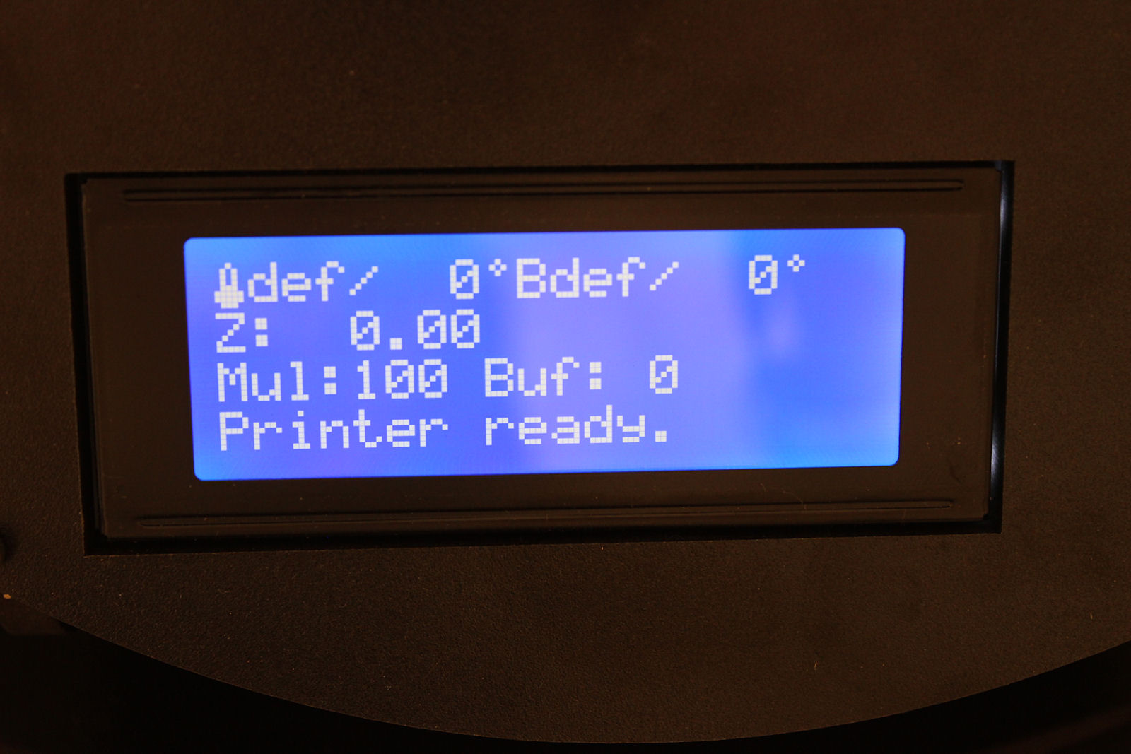

Re: RAMBo to SmartController Adapter 1.0a
There have been posts on the forum indicating that some are having troubles getting their LCDs to work when connected via the RAMBo to SmartController Adapter 1.0a. I now have mine working and it displays correctly. At his point I don't have anything plugged in to the RAMBo board other than the LCD cables and the USB cable. I have not turned on the 12 volt supply.
Finding and flashing firmware that would work was an ordeal. I am using Windows XP Pro on a Dell Workstation so some of Arduino's routines are not as elegant as they are when using a Mac. I am using Arduino 1.0.4 for Windows. I tried using Jon Oly's recent adaptation of Marlin and got nothing but the "dreaded white boxes" on the LCD. I then spent considerable time reviewing the LCD Assembly Manual and attempting to correct the Marlin code as indicated. In places the Marlin code appeared to already be "corrected," and in other places it didn't look like the examples. I chose to take a break and went for a walk.
I later chose to download Polygonhell's adaptation of Repetier and it compiled and uploaded without a hitch. The display came on, and, like any good display, demonstrated I had no thermistors attached (zeroes displayed for all temperature readings).
I come from a PIC Microcontroller background so "shuffling" may way through the Arduino IDE was a bit of a challenge. Fortunately the IDE cued me to select the 2560 board under the Tools menu. After I did that things went pretty quickly.
So, we know that at least one of the Adapters is working. I sure hope all of the others come on line soon! (I do need to go back into the firmware and turn off EEPROM references, etc. But, at least I got it to this point.)

@gsnover - in answer to your last question correct, don't edit microsteps in configuration.h - changes to that file only work if you have disabled eeprom. Enabling eeprom overwrites that data. You will need to update all 4 steps per mm settings in the eeprom.
Guys, I have the LCD adapter finally up and running, but it only turns on when the USB is plugged in! How do make it stay on all the time?
Do I need to remove the jumper on the "PSEL USB" on the RAMBo? Or is there a setting in the firmware/eeprom that enables this?
move the jumper to 12v power supply
You need to move the jumper. Posted by johnoly99:
