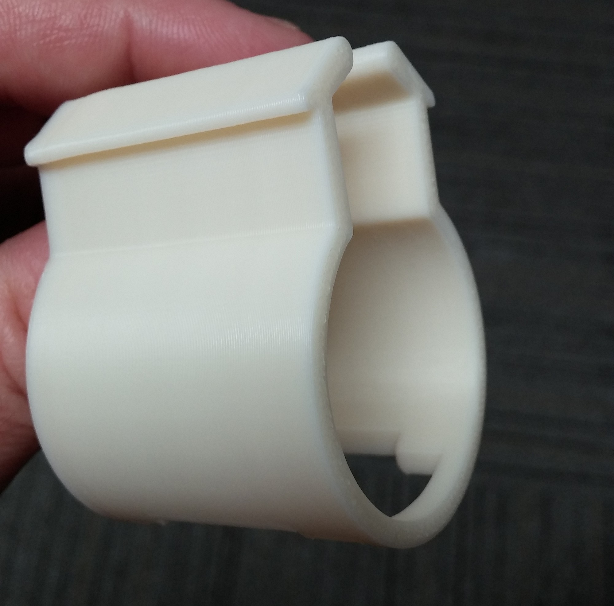

You got a hell of a deal on the one of the best printers on the market. I own a Creator Pro and a Creator Dual (Woody). As for my Creator Pro, I haven't leveled the bed since last March and every one of my prints has been outstanding. Combine that with S3D and you'll start to get cocky. ;)
Here's my latest print today (ABS). Did my best to focus on a white part.
