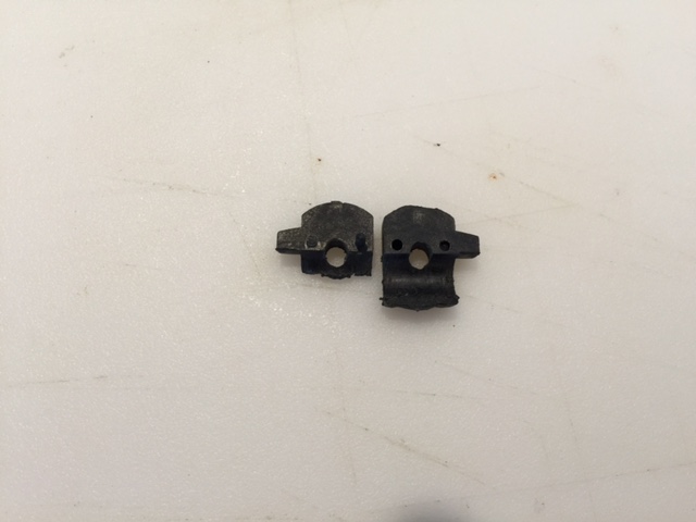

How cool is this:
My desktop lamp broke--the little thing here : (these are supposed to be mirror images of each other. One side is obviously broken.) So I designed a new one, printed it, and Viola!
How cool is this:

Nice fix on the lamp.
