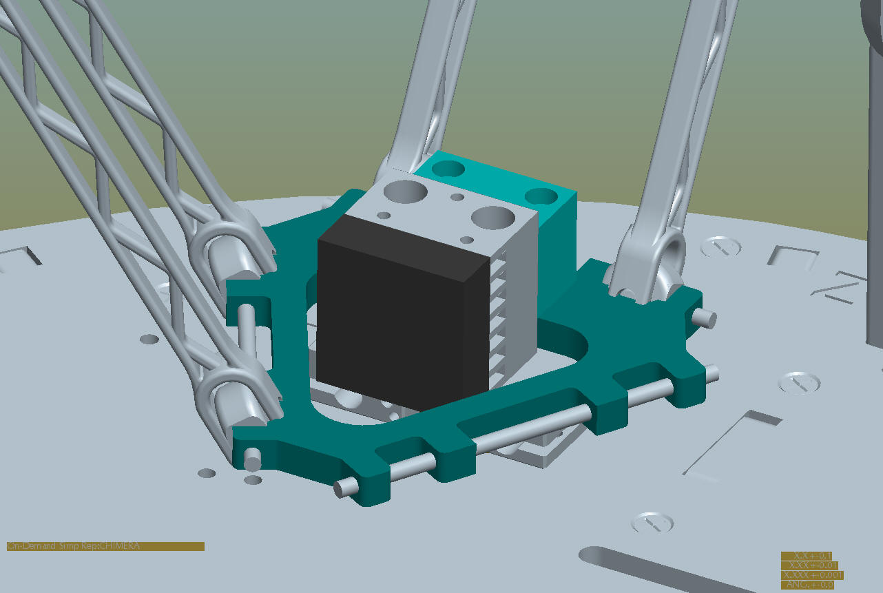

Designing a dual tool platform was reasonably straightforward if you can also print a new effector plate. (With all the important dimensions stolen from the SeeMeCNC STL files.)
This one is intended for the Trick Laser arm attachment, where I can screw the threaded rod through the blocks, then screw the ball end attachments on either side.
[img]http://gchristopher.net/3dprinting/cust ... st_try.jpg[/img]
The major difference to the effector platform is a larger inner radius. This pushes the support columns out a bit. Since this is printed especially for these hot ends, it wasn't too much extra work to integrate an airflow shroud into the design of the effector platform and tool attachment piece. The effector platform has a solid plate keeping the fans from blowing directly onto the hot ends.
The little extra printed material on the support columns is intended to help with getting the hot ends exactly level. I figure I'll file down a tiny bit off the left or right to get them as flat as I can measure. Sort of a one-time-adjustable setup?
I wish I knew if this was an intrinsically stupid idea before I print, assemble and test it all! Does anyone know if I'm missing something basic here?

I really love the innovation! I'm just wondering why not go with E3D's Cyclops?
gchristopher
Posts: 175
Re: Yet Another Dual Extruder Design Attempt
Post by gchristopher »
ZakRabbit wrote:I really love the innovation! I'm just wondering why not go with E3D's Cyclops?
I think I bought the E3D V6's last year before the Cyclops/Chimera were for sale and the V6's are already here. Were I starting from scratch, I'd buy a Chimera, to permit printing materials at different temperatures.

Everyone has found that there's just no way to cram two heater blocks through the opening in the stock effector platform. So one early goal of this design approach is to create an effector platform with enough interior space.
Aluminum would be the material of choice, but I don't have access to the machinery, so let's try to make a printable effector platform for the V2!
A few revisions down the line from the initial design above, here's the first version. It's printed with a E3D volcano, .8mm nozzle, and .6mm layers. (Btw, loving the volcano, my prints are faster than my bed heat time nowadays, need a 24V PSU, I guess!) The results are a little coarse-looking, but should be fine mechanically. The only part that needed any filing was the 6-32 screw holes to attach the tool holder, and that was intentional to keep close to 0 play.

ZakRabbit wrote:That's what this is all about, finding something different! Looks great. It appears the motors will be end to end: if you're worried about heat, why not design a fan shroud that will actively cool both motors? We can all guess and give you our opinions, but you'll never actually know until you try it. Give it a shot and let us know how it worked out.
You were totally right! The ends are too close and the fan cooling blocks will collide. (The water cooling blocks would fit, but that'll be a ways in the future.) I'm reprinting the holder blocks to go back to the 45 degree mount angle and move them a little farther apart.

Okay, here's a little bit back on the original topic!
The dual extruder holders are printed and installed. The big effort here was a substantial teardown to add t-slot trim and run all the extra wires to support dual extrusion. So far, so good! Here's the current revision of the holder, design view, and printed and installed:
[img]http://gchristopher.net/3dprinting/dual ... design.jpg[/img]
[img]http://gchristopher.net/3dprinting/dual ... t_look.jpg[/img]
I'm not sure I'll stick with them in this location in the long term, but I think those extruder holders definitely achieve the goals set out for them! After a couple more tweaks and some code cleanup, I'll be publishing those.
I need to either find a darker background or stop printing in black all the time. Also, they form a very solid frame; those suckers are some beefy rigid extruder holders!
Regression testing (making sure I didn't break anything) has started, and one test print turned out fine.
Next up will be installing the second hot end and working on firmware changes.
Here's the current design idea for the dual tool holder:
The immediate problem is fan placement. In the pictured position, they'll get in the way of the lash straps on the arms. It'll either have to change to a single fan, or else offset the hot ends some to make space, or both.
The pictured effector platform was been printed and seems to be working great after several prints. It differs from the test print above by adding some support material around the M3 threaded rods to keep them from being bent by the lock nuts when they're tightened down.
So, as far as printer modifications go, things are going pretty well. The wiring is in place and at least didn't break anything. The new extruder holders and effector platform look good to go.
