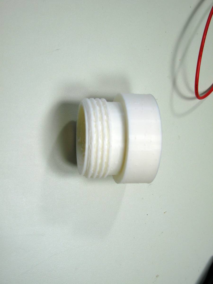

I am having problems printing threads (like on a bolt). It just doesn't come out right. The threads come out blobby. I'm using kisslicer.
8 loops (4mm skin), 0.2mm layer thickness, 0.5 mm nozzle. Infill set at 33% (but it never infills anyways because the loops and skin thickness takes care of it). I've tried a bunch of settings and it just doesn't come out right no matter what I do.
Everything else I print comes out great. The twisted vase looks incredible. I just can't seem to print threads for some reason. anyone have any experience with this?

The most common issue when printing 100% infill, either withe the setting or just lots of perimeters as you are is over extrusion, it only has to be very slight to mess up a print.
Having said that threads aren't a particularly easy print, they require a very well calibrated printer, and good cooling.

I find that threads go to crap if I don't have at least 10 layers per revolution and, even then, it's a bastard of a compromise with ABS. Nice and hot (around 260º) means layer adhesion is really nice BUT it sags worse than grannie's bewbs. So when the layer comes around to that next bit of overhang, it droops. And the layer after that drops on top. And so on. On the other hand, printing at 230º means the overhangs cool quick enough to not sag so much. But the inter-layer adhesion is rubbish.
Go with a layer height of pitch/10 (ie a 1.0mm pitch needs at most a 0.1mm layer height) and slow the print down. If it's blobbing out looking like some case of boils then polygonhell has identified the most likely cause: you're overextruding slightly and that extra goop has no-where to go. Definitely worth doing another filament length calibration (extrude 100mm, measure it eg 100.3mm, change your stepper ratio for the extruder by 100/100.3), definitely worth doing another filament diameter calibration (measure 4 times along a 100mm length with a micrometer, load the average into your filament settings, guaranteed it won't equal 1.75mm).

Ok here's the pictures. I think you guys may be right. It's over extruding on the threads.
So this is a print from the same printer. No changes except to the slicer settings. The inside is just as clean as the outside. A little acetone vapor and it would look like it was injection molded.
Here's the frustrating parts.
It's gets all blobby on the inside and the threads are blobby. Not only that the printer is doing some sort of circular fill in the wall. It does these little circles inside the walls of the cylinder. I've never seen it do that before. So it makes the wall layers uneven layer wise.
Here are some prints of the Xnaron mag arm parts for comparison. Again no changes to the printer extrusion settings, just the slicer loops, skin width, etc.
Here are more thread type prints. You can see the size in comparison with my hand. These are a little bigger than the one above so theoretically it should be better or easier. I went from 4 loops to 8 loops to 10 loops and it doesn't seem to help.
So I can't seem to figure out the settings. I will check the extrusion and the size of the filament but it has been very even. The only trouble I have had is with the threads. Everything else comes out great.
