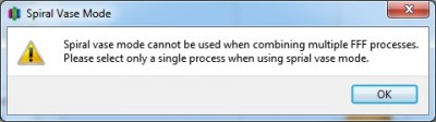

Based on a comment read elsewhere, I'm lead to believe that S3D can run two (or more) slicing strategies on the same part.
If this is true, how could I go about using a "normal" slicing strategy for the first 5.5mm of the print and then change to a single-wall spiral strategy for the remainder of the print?

insert another process, on the last advanced tab you have the start and stop heights. configure each for the same model.
Re: Two slicing strategies?
brute force the spiral, single perimeter, stop retracts/wipes yadda yadda should work.
I've tried - the model won't produce output past the 5.5mm mark where it transitions to a .7mm shell (even with a .35 nozzle). The only slicer that will do it properly (so far) is Slic3r.

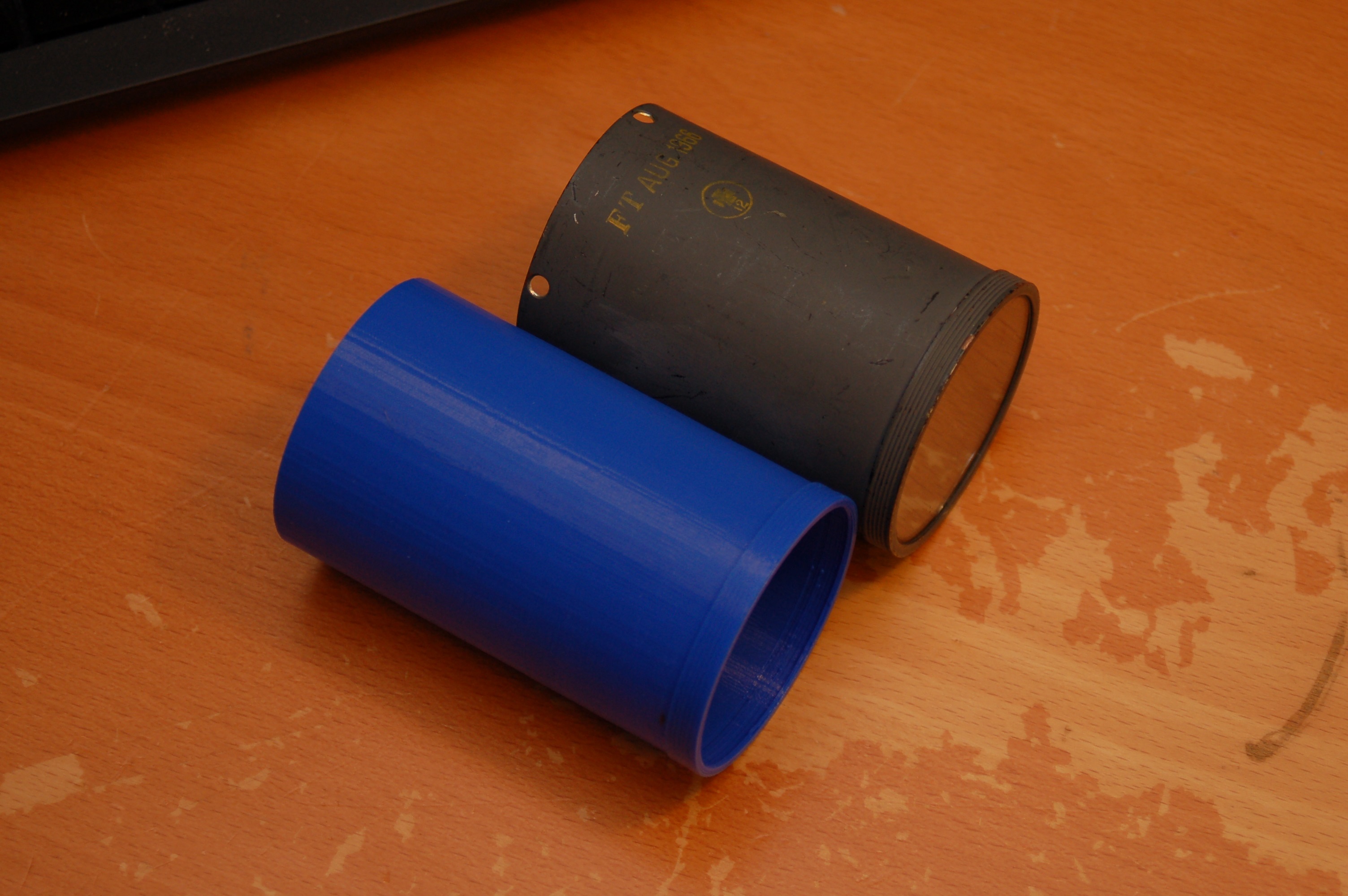

Slic3r prints it just fine:
[img]http://www.geneb.org/images/ins-body.jpg[/img]
I'd like it to use a spiral for the tube portion to get a better look to it.
I'll look into Slic3r a bit more to see if it'll do that. Thanks for the tip Brian.
