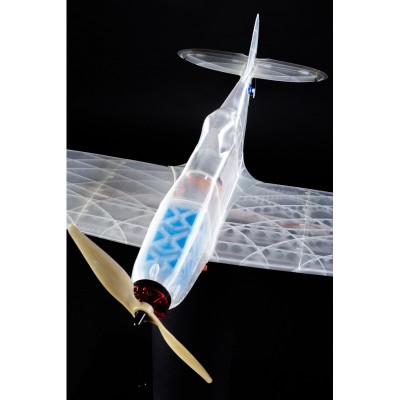

Ran across this website that is selling a VERY highly structurally detailed set of .stl file to print a 1:12 Semi-Scale Supermarine Spitfire.
http://3dlabprint.com/index.php?
Details and video of flying model are really impressive. I purchased the files and threw them on the printer to run in background. The interior detail and structural member are awesome. May end up being a rafter queen but it definitely does show promise.

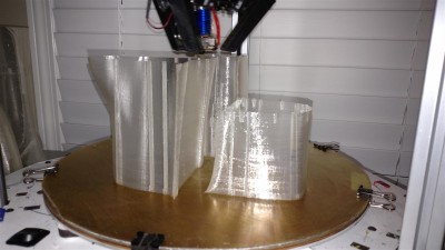

I have been playing with clear PLA. I am using S3D to prepare and have found a reasonable for me set of parameters to print with. Initially the part was not clear, had holes at the start/stop point on the layers and was very overweight. I now print both ends of a section 2 layers thick and the body in between at one layer thick. This is easy with S3D.
My parameters are:
Bed 70C
Extruder 210C
Layer .25mm
Width.42mm
Nozzle .4mm
first layer 90%
Extruder multiplier 100%
Retract 5mm (using E3D, no jamming occurring and no stringing)
Extra feed before start .4mm (solved the holes at start stop)
0-5mm print 2 layers
5 - top-5mm print 1 layer
top-5mm to top print 2 layers.
The PLA is glued with CAA. I also want to print a few test parts from ABS. I think it is more durable in a rapid disassembly event and I have better results bounding or weld sections together with acetone.

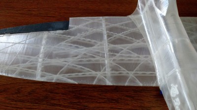

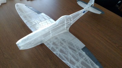

Well I have a Spit printed. May not be the final version but it actually looks pretty good! The internal structural details are very impressive.
The majority is printed one perimeter thick with a 0.42mm layer width making it very thin. The wings are internally braced and trussed making them stiffer than any other plane I have ever assembled be it foam, stick built, etc. The fuselage is also a single perimeter thick and is pretty good but a little squishy. No doubt it is strong enough to fly but not real firm to handle. The fuselage would benefit from a frame former on each section splice.
The files were sliced with S3D taking advantage of their multiple Process capability in the Factory Files. The first 5mm was printed with two perimeters to produce a good gluing flange, the main body with one perimeter, reinforced areas like the bellcrank connection on control surfaces printed with 100% infill and solid, the remainder of the body printed with one perimeter, and the last 5mm printed with two perimeters producing a mating glue flange for the next section. This requires five Processes in the Factory File to produce. Printed parts fit perfectly, assembled wing slides snuggly into assembled fuselage.
Haven't decided if this will fly or hang. It is definitely outside my skill set. Level flight with a 4008 motor is 85mph. I have a box full of 4114's that I will likely use pushing speeds to 90 or 95mph. Only saving grace is the low speed stall of 20mph.
