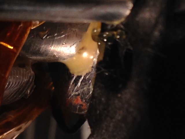

Hi All,
I've got a stock machine/software, except it came with the different stepper motors, where you had to adjust the BAUD rate (I think)
Tricklaser's 325mm FC arms http://www.tricklaser.com/325-MM-Carbon ... FTX325.htm
and my bed is elevated on 2" stainless steel circuitboard spacers (explanation here: http://forum.seemecnc.com/viewtopic.php ... 393#p73393 - the 325mm arms have rendered this mod obsolete, but I haven't bothered to remove it yet.)
Here's what's up:
I recently installed those 325mms, and did a calibration using RollieRowland's killer .html calculator http://forum.seemecnc.com/viewtopic.php?f=36&t=8698 and a depth gauge mounted in place of the hot end.
Before I could print more than a calibration tester, my stock power supply blew a capacitor.
Replaced it with a 4-year-old Antec Earthwatts 650W yesterday (oh, so that's another mod...)
This has a thicker gauge wire, and I added an extra set of yellow and blacks to each hot-end port to allow it to draw more amperage if
need be (perhaps that's the problem, though I can't figure why it would be...)
Anyway, suddenly my nozzle seems to be leaking PLA around its base, which eventually drips down and fouls the print.
PLA accumulating around the nozzle base - for some reason the forum is rotating it 90 deg counter-clockwise.
The PEEK fan is going full tilt. Could the leak be from a flaw in the nozzle? Do I need to replace it?
Thanks a ton for any help!

You've greatly exceeded the maximum hot-end temperature of 247C and have destroyed the PEEK section in the hot end.

Weird - the thermistor was reading 209-211 the whole time when this happened.
Guess I need to get a thermocouple to correct/check the thermistor reading from now on...?
And a new hot end?
Do you think that was due to wiring to allow for extra on-demand amperage draw from the power supply?
But if so, why wouldn't the thermistor have read the increased temp...?
Posts: 2417
Location: Redmond WA
Re: Troubleshooting Forum - Please Read Before Posting
Post by Polygonhell »
The usual cause of this is the thermistor creeping out of the hole in the hotend. The Silicon is not intended to secure it in the hole.
What happens is it works its way loose and as it does so reads progressively lower temperatures relative to the actual, you can't tell at room temperature, because it reads correctly there.
It's how I lost my first hot-end several years ago.

This is why I have builders tape the thermistor leads to one of the power leads on the hot end as well has wrap the hot end heater block in Kapton. The only 100% sure fire way I've seen to guarantee that the thermistor will never come out is to install a threaded unit like this:
http://www.ebay.com/itm/Modular-Screw-I ... 19fb5489f2
While you're at it, you can replace the two resistors with a single 6mm heater cartridge like this:
http://www.ebay.com/itm/5pcs-Reprap-Cer ... 4d2a9151cb
(I'd try to find the 15mm long version)
Here's a video I did that shows the upgrade process:
https://www.youtube.com/watch?v=xvXKt3xDt4E
You can replace the PEEK section without much trouble.

Oh cool, thanks again Gene, it would be nice to avoid the expense of an upgrade.
I actually did tape the thermistor leads to a power lead too - I think I probably loosened it while
repeatedly fuddling with installing/uninstalling the depth probe for Rollie's html calibration script.
I have a supply of 10 thermistors I got for $5 on ebay last time one crapped out on me,
so will have to exhaust them before going to the cartridge.
Do you know of any tutorials/directions on how to swap out the PEEK section?

It just unscrews. You'll probably want to get a tap of the right size (I don't know what that is) in order clean the slagged PEEK out of the heater block's threads, just make sure you're chasing the threads and not trying to cut new ones. :)

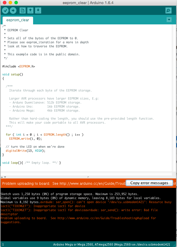

We'll here's a new development:
I was having problems with Rollie's HTML script crashing my hotend into the bed after I reset to defaults.
It even persisted when I set Z height at about 1cm below the end-stops.
So figured I'd clear/restore the EEPROM to defaults through Arduino.
Got this error message:
Arduino Error trying to run eeprom_clear (if too hard to read, I can PM it to you.)
Then I noticed only the upper-left green LED is on on my RAMBo - the others that usually
are flickering away are all off. Also the print time and filament used fields appear to be stuck in loops.
All the printer's control functions seem to work though (the ones I can test w/o a nozzle, anyway.)
Any idea what's happening - do I have to replace the RAMBo?
-Eric

Looks like the instructions should have included an instruction to start a new post for your issues rather than replying to this one.
Anyway, your program failed to load to the Rambo because the usb/serial port was busy, which means nothing got changed. Perhaps you still had the host program running when you tried this?
If your eeprom clear HAD worked, then nothing would have worked anymore, as you would have successfully overwritten the Rambo firmware. You have to follow up by reloading your firmware to get it to work again. Make sure you're prepared to do this!

Yeah, if you've got MC connected to the printer, the Arduino IDE isn't going to be able to use the port.
Leave it up to MacOS to identify a regular serial port as a "usbmodem". *rolls eyes*
