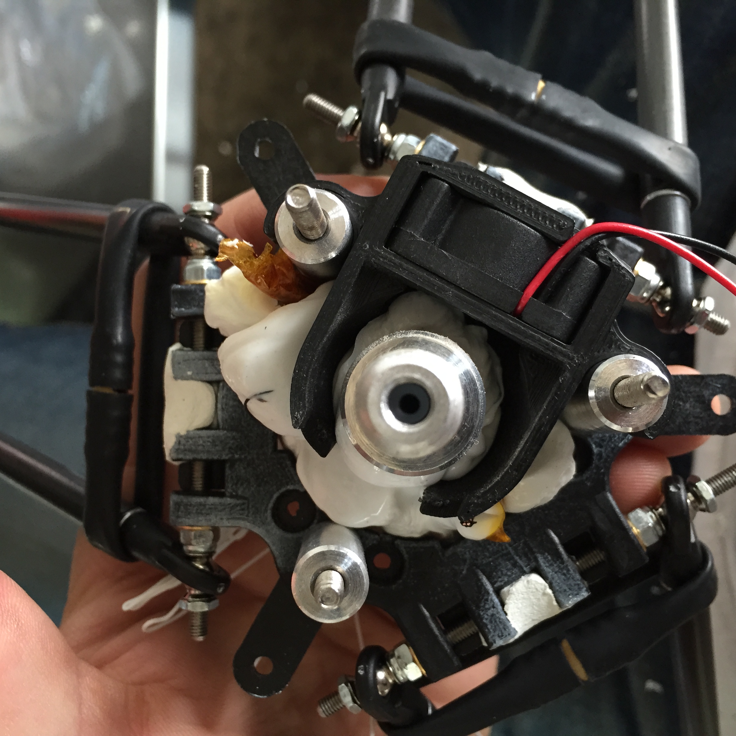

I had just put on some trick laser arms, and done a few great prints with them. I've had an E3D sitting around too, that I've never hooked up because I've never had a single problem with the stock hotend.
until now
major bummer, because I'm in the middle of fulfilling some orders for 3D hubs. This started as an adhesion problem, I had run out of gluestick and had just re-wet what little there was on the caption tape. shoulda run out to the pharmacy and bought some more glue. Instead I went for a 35 mile bike ride...
Looks like I'll be installing that e3D tomorrow... btw, any good tutorials out there for this?
this is my first major fail, and I feel like I've hit some sort of milestone or something...

There's nothing fatal going on there. Just remove the layer fans and heat up the hot end. You should be able to pull the blob of plastic off quite easily.

Ok, I will try that. however, it mushroomed out the top too, creating a sort of big plastic rivet.geneb wrote:There's nothing fatal going on there. Just remove the layer fans and heat up the hot end. You should be able to pull the blob of plastic off quite easily.

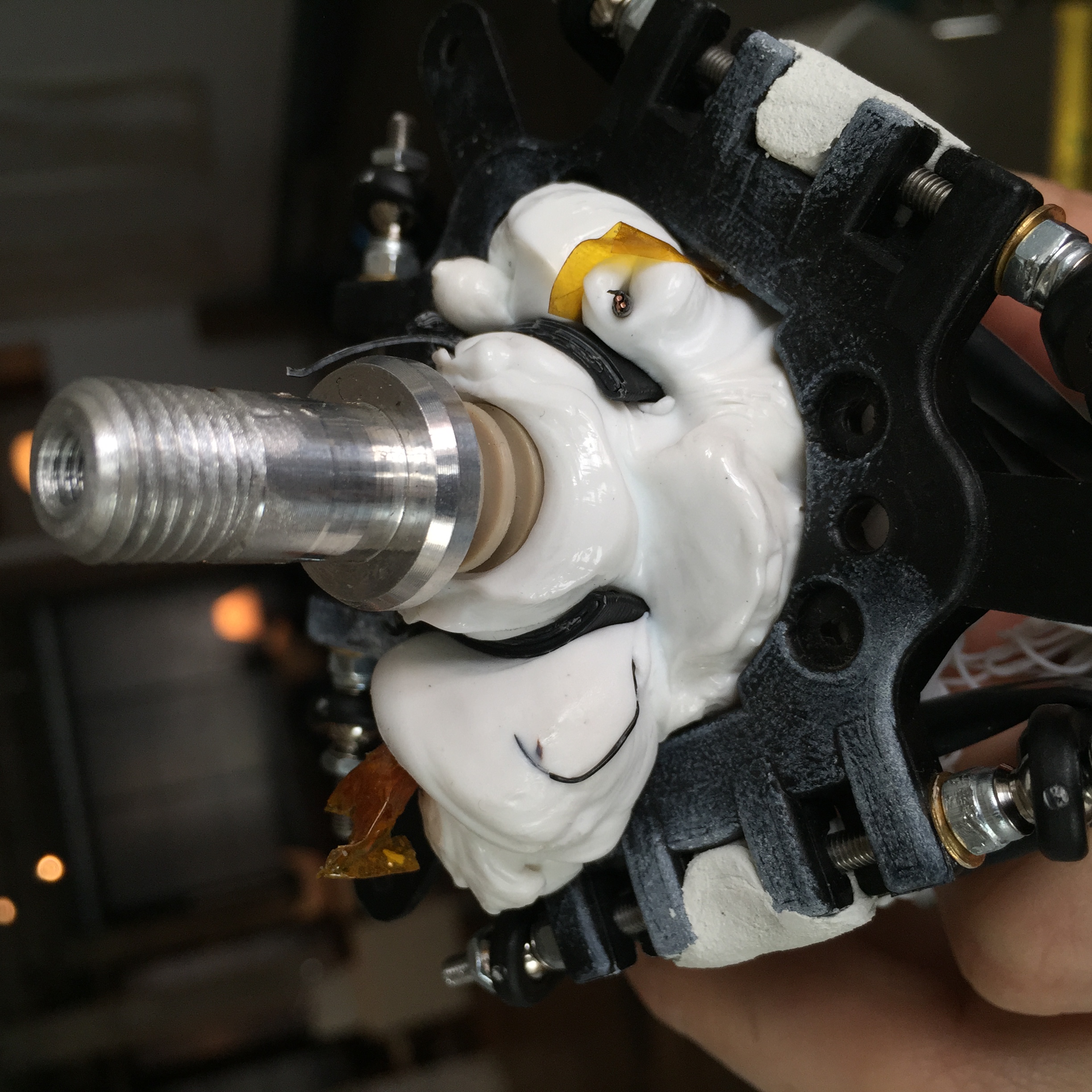

This is not fixable. I tried heating it up, prying it off, not happening.

It's not a total loss though - you should be able to disassemble the hot end (top section, peek, heater block) and using needle nosed pliers and wire cutters, get it free from the block of plastic. You'll of course need to replace the resistors & thermistor, but that's pretty simple.

Even if you decide to replace the hot end, you still want to save the effector if you can. If you remove the arms from the effector as well as any other disassembly possible you will have greater access with tools. A hot knife (I have knife blade for one of my soldering irons) may help...but dont let it touch the effector itself.

What material were you printing with? I did this with trimmer line (nylon) and cleaned it up. It did take a few hours, and a dremel, and a car battery.

This is PLA. It was really stupid of me to leave the printer knowing full well that the bed adhesion was sub optimal. Now I've a good excuse to rig up the E3D tho! I was hoping to print a mount for the e3D. or can I theoretically reuse this one if I can free it that is?
I gotta say, 1300M of equal parts ABS and PLA, not a single jam with this stock hotend. That why my e3d has been sitting around for so long! I figured I'd set it up once I had a good reason... and I guess this is it. But it is not the fault of the stock hot end. ...user error

Ok, well I got it taken apart, and the effector platform is still intact. Now, how to mount the e3D...

Could you stick it in your oven at 450 degrees? That should be low enough to not melt the stock hot end, but heat up the part to remove the filament. Just a thought. I agree though, that is massively impressive and I feel terrible for ya.

Put it in a tupperware with a few caps full of the non acetone nail polish remover. It makes PLA gummy (wait 2 days or so), and it might be enough to give you some flex and help you get it off of there.
