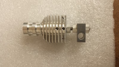

I'm getting ready to install a Prometheus Hot End v2 into a new build.  This assembly configuration is based on my experience with a v1 Prometheus build.
I had to deviate a little bit from the stock build but ended up with a very flexible configuration. The cause for deviation was an occasional jam on PLA under heavy retracts.
With this configuration, I get no stringing with PLA and ABS and only need short 3.5mm retracts. Nylon is working quite well also and requires 5.5mm retracts with an occasional string.
I've had over 450 hours of run time with this configuration without any jams.
Bellow is the configuration I am using.
Instead of double nutting after the heater block, I moved a nut to the top side. I am also using a nut at the bottom of the heat sink to create a 2mm heat break.

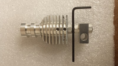

To get an exact 2mm gap at the heat break and maintain a desired heatsink to heater block orientaiton, you can try out different nuts in the kit or if needed, file a nut down on thickness until you get the 2mm.
Also, A nice trick that may not be evident, is to use the included 2mm hex wrench as a gauge instead of trying to sight the gap with a pair of calipers.
When building a v2 this way, be careful not to tighten the top set screw too much or you risk crushing the entry of the barrel. Having used a jam nut against the heat sink, the set screws can be omitted it desired.

Interesting! What's the thought behind the nut above the heater block, and the one below the cooling fins?

using the 2mm allen key as a gauge is clever!

Initially, I was having PLA jamming issues under heavy retracts with 2 nuts on the bottom per the build guide. I also had about 2.5mm of exposed barrel.Glacian22 wrote:Interesting! What's the thought behind the nut above the heater block, and the one below the cooling fins?
My thought was to create a bit more of a temperature gradient towards the cold end by moving a nut on top of the heater block instead of two at the bottom. A jam nut is needed to secure the heat sink to the barrel on the v1. The v2 uses set screws now, so this is not required. But, it was working before, so I left it.
Hindsight, the extra nut at the heat sink helps create enough height to keep the Prometheus installed in a relatively same manner as the SeeMeCNC hot end and provide enough clearance for the fan. Without, I think I would need to place it underneath the platform or mount the cooling fan differently.
I'm currently printing PLA at 75 mm/s without issue with a v1 and v2 and will try increasing before too long. I've yet to have a jam with this configuration and no need for cooking oil voodoo that some E3D users seem to need.

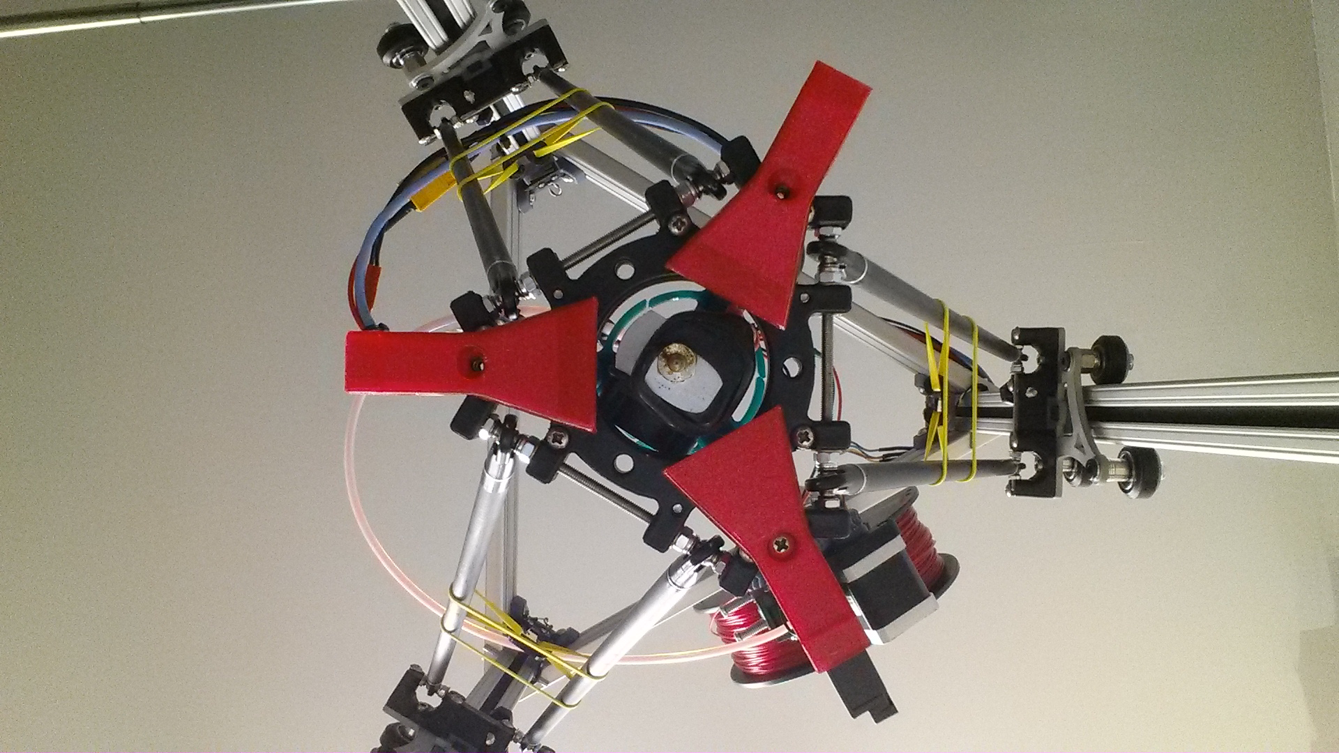

My configuration for printing ABS with a 0,4m nozzle is the following:
Cold Zone
2,5mm Transition Zone
Heater Block
Hex Nut
Hex Nut
[img]http://abload.de/img/wp_20151205_14_09_18_nesqd.jpg[/img]
I use 1,5mm retraction @60mm/s.
I print up to 100mm/s (but usually slower).
I use the stock extruder of Rmax V1 with my flying extruder mod (bowden lenght ~75mm).
Works well!
						Cold Zone
Heater Block
Hex Nut
Hex Nut
Works well!

That heater block looks awfully close to the effector platform.
The heat could make it go soft or distort.
				ccavanaugh
- Posts: 297
- Location: Indiana
Re: Prometheus Hot End v2 Build
Agreed. I reduced my spacer height so the hot end fan was just a smidgen above the platform to allow room for layer fans. I also wrapped the heater block in F4 tape to add some additional heat protection.teoman wrote:That heater block looks awfully close to the effector platform.
