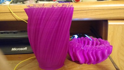

Hello, I've been having some issues with backpressure on my rostock. I recently upgraded to an e3d v6 lite (I had some issues with the stock one). Small prints seem to work fine but anything larger seems to build up backpressure and eventually causes the filament to get ground out by the drive gear. This happened pretty quickly on my first print. I was printing PLA at 45mm/s at 210 C. The second print made it much longer Printing at 35mm/s and 195C. I also decreased the acceleration of my extruder to 4500 (as was recommended in another forum). Anyways let me know if anyone else is having this problem and any solutions anyones found. I'd eventually like to be printing much faster.

so printing again last night, I was able to finish the vase by uping the temp to 225 and lowering the speed to about 30. However the filament was still slipping on the drive gear causing some bands in the print. (the filament was definately slipping, I felt it by hand as it printed). So printing way slower and higher temp I was still having some issue. Theres gotta be something else wrong. any other ideas?

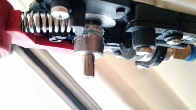

So after trying to recut the ptfe I am still having the same issues. on longer prints the drive gear starts getting all gummed up with filament bits. any other ideas?

After some more experimenting I'm beginning to think the issue is with the ezstruder. This problem has occurred with e3d lite, e3d lite with volcano, and now e3d v6 with volcano hot end and with 0.4mm and 0.8mm nozzles.
I have reduced acceleration to 3250 for extrusion. my motor current (wantai motors) is set to 200 and I have tested with extrusion temperatures ranging from 185C-240C with PLA. Every time I print the filament slips and the ezstruder gear starts grinding it until it fills up.

This has happened with every filament I have tried, PLA, ABS, Woodfil
The extruder is not jamming so yes I can still push it through by hand
The drive gear is coverd in debris (see picture two posts above). It starts off clean but during printing the drive gear starts grinding away at the filament until the gear is too full of debris to extrude.
