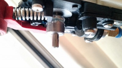

So I got and installed the volcano heatblock. Unfortunately I am still having similar issues. It seems I am getting some back pressure in the hotend. It prints fine for a bit but on longer prints the drive gear starts chewing up my filament (I'm guessing this is due to back pressure). Eventually the teeth get so filled up that the filament just slips
