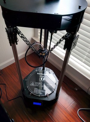

This is my first printer. A buddy asked me what I was going to use it for and I said, "Fun."

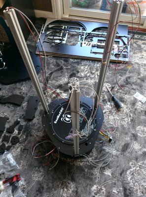

Got through my cataloging of the parts and wasn't short on anything, but had a few extra screws and odds and ends.
And finally... jesus, that's a lot of tape to remove. Working my way through the five stages.

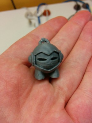

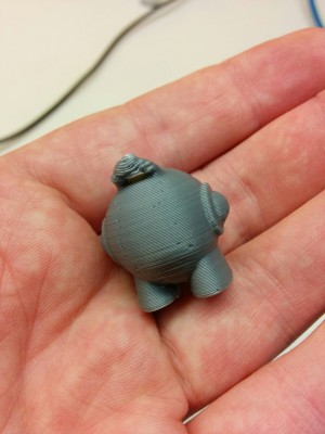

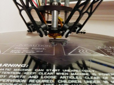

I find that when I print small object the top layers do not quite cool before the next layer is placed and and there is some sagging/distortion. Slow your print, add a fan to blow on the print or most helpful is to add a waste print to delay the next layer of your print of interest.crim wrote:Thanks!

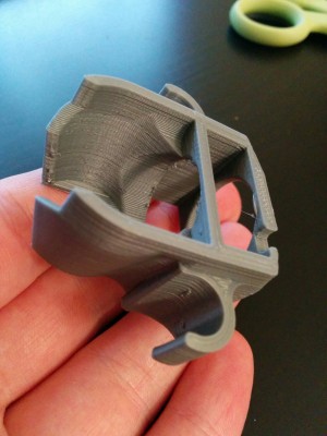

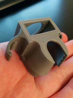

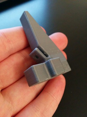

Here's the layer fan shroud and Marvin.
The shroud came out fine enough, but Marvin's a little rough.
