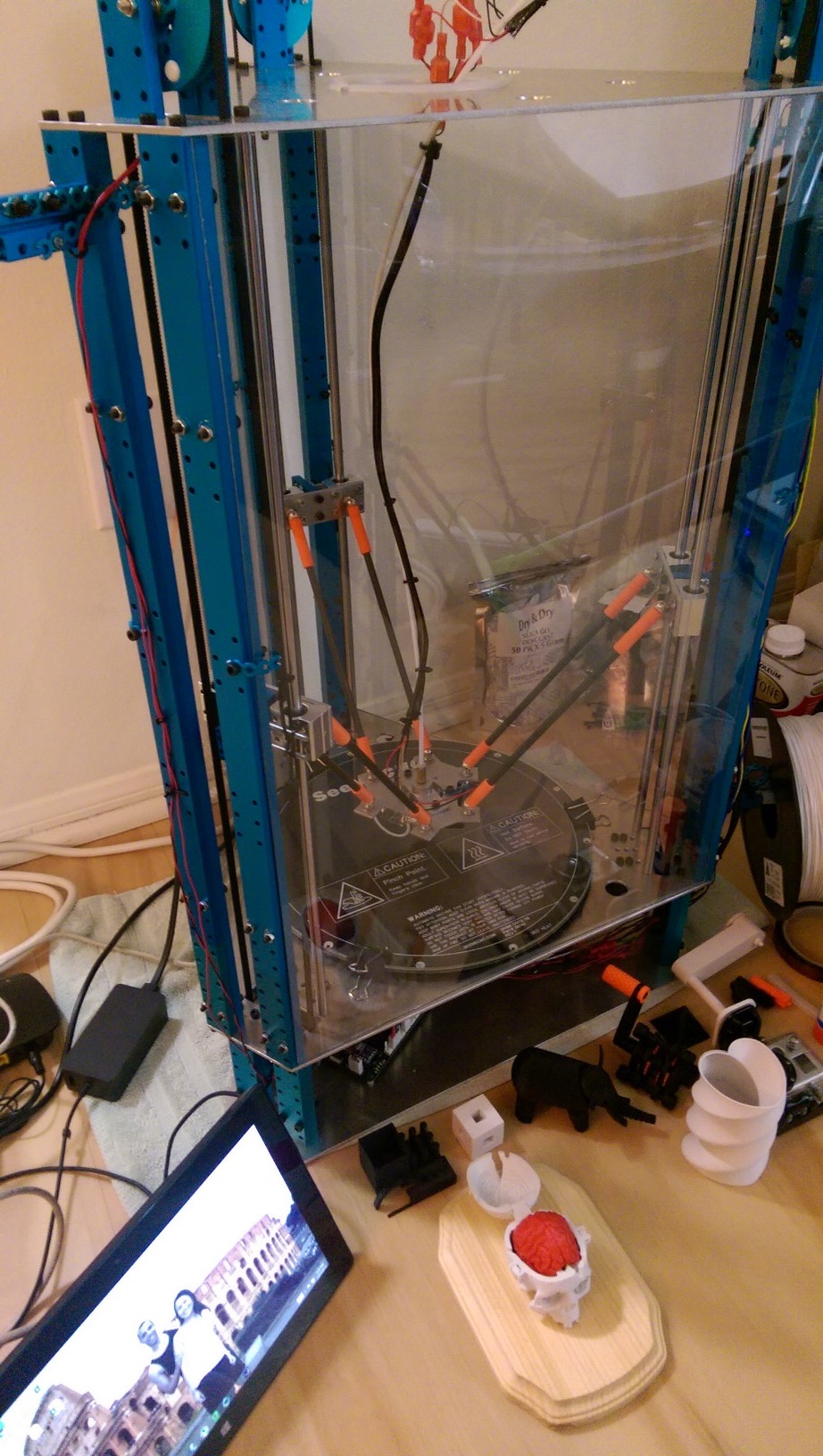

I designed this in FreeCAD. For structure and linear motion I used MakeBlock (blue parts) and a friends CNC machine (naked aluminum). The hot end is the B3 Innovations PICO. The heated bed is SeeMeCNC and the extruder is the EZStruder from SeeMeCNC.
Well, let me know what you think!
In action: https://www.youtube.com/watch?v=qRJZMgfJjHo
Overall Build:

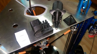

Resultant prints:

Electronics:
BeagleBone Black rev C
BeBoPr++ cape
DRV8825s (at 32x)
Running LinuxCNC on the Machinekit image
Motors:
Kysan 1124090 NEMA17 Stepper Motors (54 N-cm) with heatsinks and fans

I saw some people wrapping their kits in plastic. I'm sure this works great, but the sexy factor just isn't there for me. I bought "Lexan Sheet - Polycarbonate - .060" - 1/16" Thick, Clear, 24" x 24" Nominal" from Amazon. They also sell a cutter for it... 3-5 passes on the polycarbonate against a straight edge makes for a easy snap.
This is fairly inexpensive (compared to the overall cost), and looks pretty sexy (imho).
