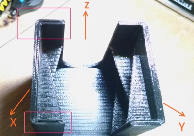

Rostock Max v2, with Rev 6 heated bed. Purchased August 2014
As I have tried to start printing out things with fit together parts I have noticed nothing is dimensionally accurate. Up until now I've just dealt with it. Que massive amounts of sanding and filing to make parts fit together...
I have tried a few things to fix this, based on searches on this forum:
Calibrated the bed to print flat multiple times, just to make sure. Have tried using the end-stop screws and the software offset method.
Calibrated the E-Steps (using the helpful doodaddoes video on YouTube)
Measured every filament roll's diameter 10+ times and use the average in Slic3r.
Made adjustments to the delta rod diagonal length. (using this page: http://minow.blogspot.com/ as a reference)
I've checked and rechecked belt and cheapskate tension.
Checked that the stepper pulleys where aligned and set screws properly tightened.
Objects are still coming out with the wrong dimensions. And oddly enough, everything on the left side of the print bed (looking at the front of the printer) is much worse than the right side.
I have been using a 100mm X 6mm X 3mm calibration object made in OpenSCAD. Printed at .2mm layer height, with the first layer at .3mm. Using Slic3r. Using RepetierHost 1.0.6 and current firmware from SeeMeCNC's website.
Top view. Excuse the crude MS paint notes.. As you can see, some of the dimensions are off. Length is correct enough (only after adjusting the diagonal rod length). Z/height is off, but consistent across the entire object. And the width is off, but it varies from one side to the other.
Bottom view. You can see right in the middle of the object where it starts to really change. Looks good on the right side, and gets progressively worse to the left. Even though the right side looks good, it is still .36mm bigger than it should be.
I've printed multiple objects now. The actual print quality is generally good. Infill meets the walls, outside walls look great, top infill looks good. Things just never fit together!
Any help is greatly appreciated!

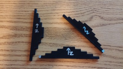

I did a quick test, printed at 0, 90, and 45. The 90 degree print is the same on both ends, and the 45 degree print is large at the opposite end! X positive, Y negative from zero instead of X negative and Y0. Kind of strange in my mind.
Z arrow is pointing towards the z tower.

Printed the same object as in my first post. Same results. The right side (towards the Y tower) measures almost spot on, 6.08mm wide while the left side towards the X tower is 6.6mm wide. The height and length of the object is spot on as well.
I have also noticed that on the left side, the object gets wider as it gets taller! At the bottom it measures 6.09 and increases in width as it goes up, measuring 6.6mm at the top. The right side of the object is uniform!
Below is a top down view of another object I printed. A small AAA battery holder from Thingiverse.. Notice the gaps between the walls in the purple boxes? When the object starts these walls meet, but as it gets taller, the gap/distortion also gets bigger. On tall enough objects, some distortion also starts to appear in the bottom right... It is not a slicer issue, I get the same results no matter the slicer used.
Any one have any more ideas? I am really at a loss here. I can print trinkets and vases all day long, but anything that needs to be anywhere close to dimensionally accurate is out.
