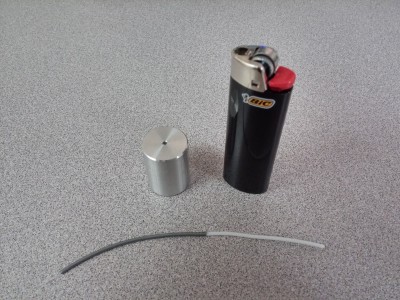

I built a filament joiner last year out of an aluminum rod with a .063 hole in it. Just like mhackney, use a lighter to heat and fuse together.

Sure but you'll have to wait until tomorrow. It's at work.
Re: Multi-Filament Joiner
so do u melt the filament then stick it into the rod or what? i couldnt fit my melty abs thru the end of the ptfe tubing after i held it to a candle, it deformed too badly
Pull one piece thru the cylinder and expose just the tip. Light it and pull the filament half way down. Immediately push a cold piece into the hole and apply pressure to both pieces. Hold it for a few seconds and pull it thru the cylinder. Takes a little practice but you'll get thing of it.
