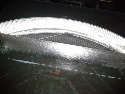

T glase is light, and you should print it in slic3r using the 1 perimeter no infill settings with the fattest nozzle you have. I'm not sure that xtc from smooth on is the ideal way to join pieces together due to its price, you would be better off getting some clear 2 part epoxy glue for 5 dollars at the hardware store or walmart for something like that. I just had a large print with my 2mm nozzle that had one layer separate but all in all it was a nice experiment:
2.5 mm/sec print speed at 225 using 3.0 mm diameter filament on a lulzbot taz 3
