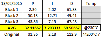

Essentially it outputs 3 blocks of data and you use the average for each P,I or D value and upload these new values to the Eeprom from either Matter Control or Repetier.
Below are the values I got and how much they changed from the stock original ones(note I did my tune @ 230 DegC as I generally always use ABS).
PID Values.png (5.75 KiB) Viewed 21935 times
So as can be seen above my I & D values were significantly different and changing them to the new calculated averages did fix the issue for me, mine was holding 3 DegC below target.
Turning on the layer fan will depress your nozzle temp a bit but 15 DegC sounds like a lot to me, I usually see about 5 DegC drop at 100% fan. Personally with ABS I only use the Layer fan on bridging and depressing
the Nozzle temp helps a bit also.. hopefully the tune should help...

I don't know if it's the resistors burning in or what, but I redid the PID tune and the numbers are way different than the first time I ran it when the v2 was new. It regulates better with the new numbers.

jdurand wrote:I don't know if it's the resistors burning in or what, but I redid the PID tune and the numbers are way different than the first time I ran it when the v2 was new. It regulates better with the new numbers.
Might be, but IME running autotune is like running a random number generator, result is heavilly depends on the environment. It also generates values with way to much I and D IMO, which is why you get the I can't reach the temperature I'm requesting issue.
