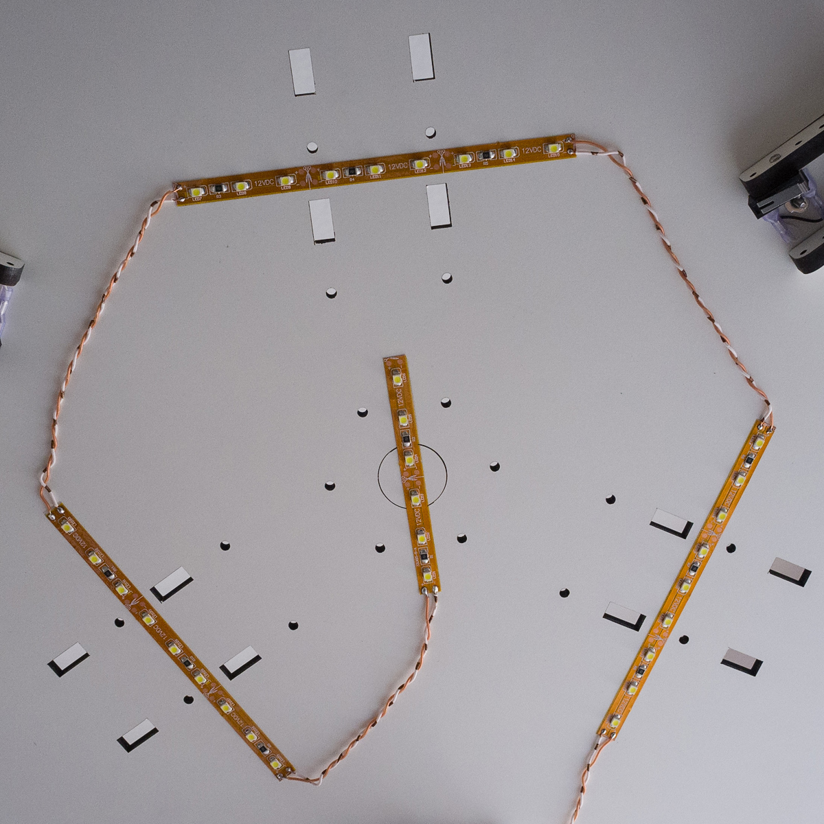

Lights
The wires are going through one aluminium rail. Extruder stiffener

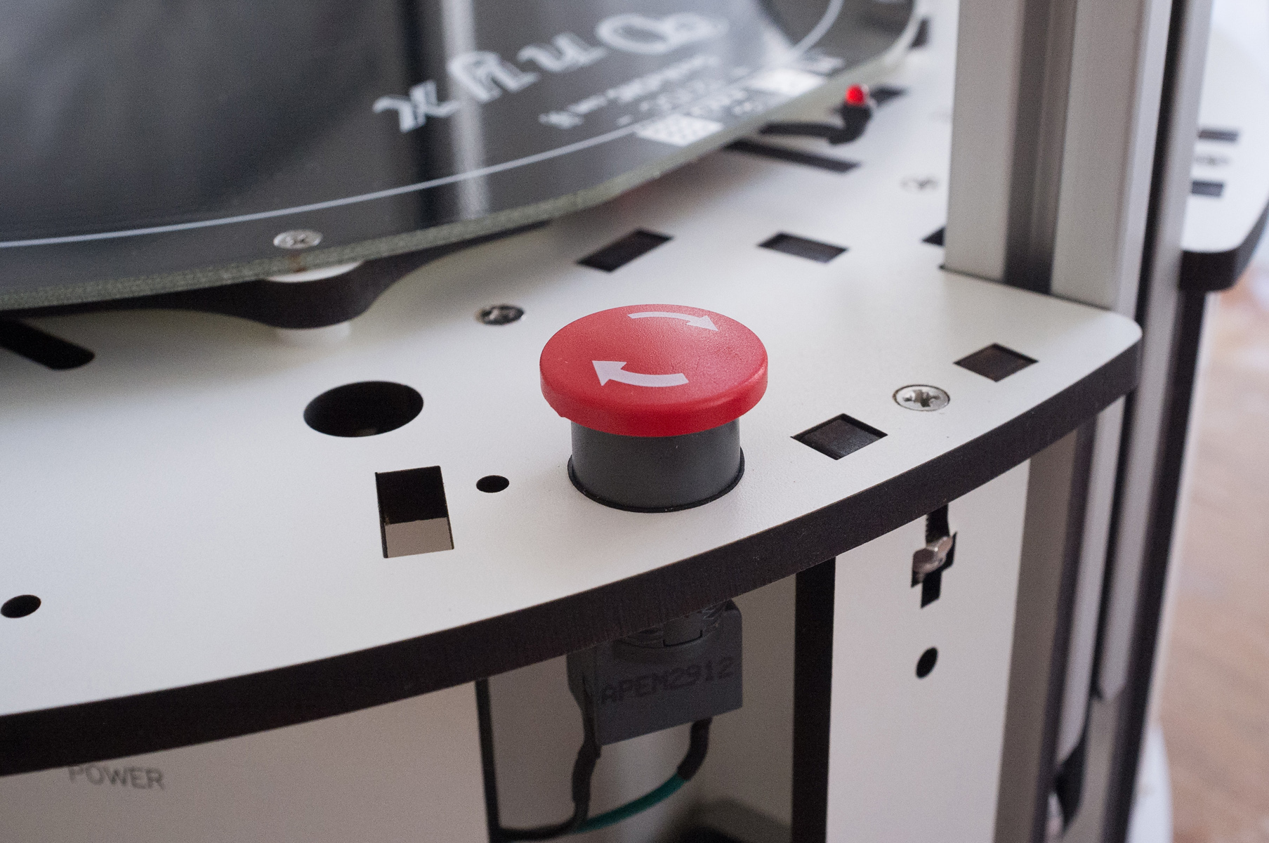

It is connected to the green wire of the PC power supply and switches off the power for the stepper motors (and hotend). Switches
The small one switches the lights the large one the power to the heatbed.
