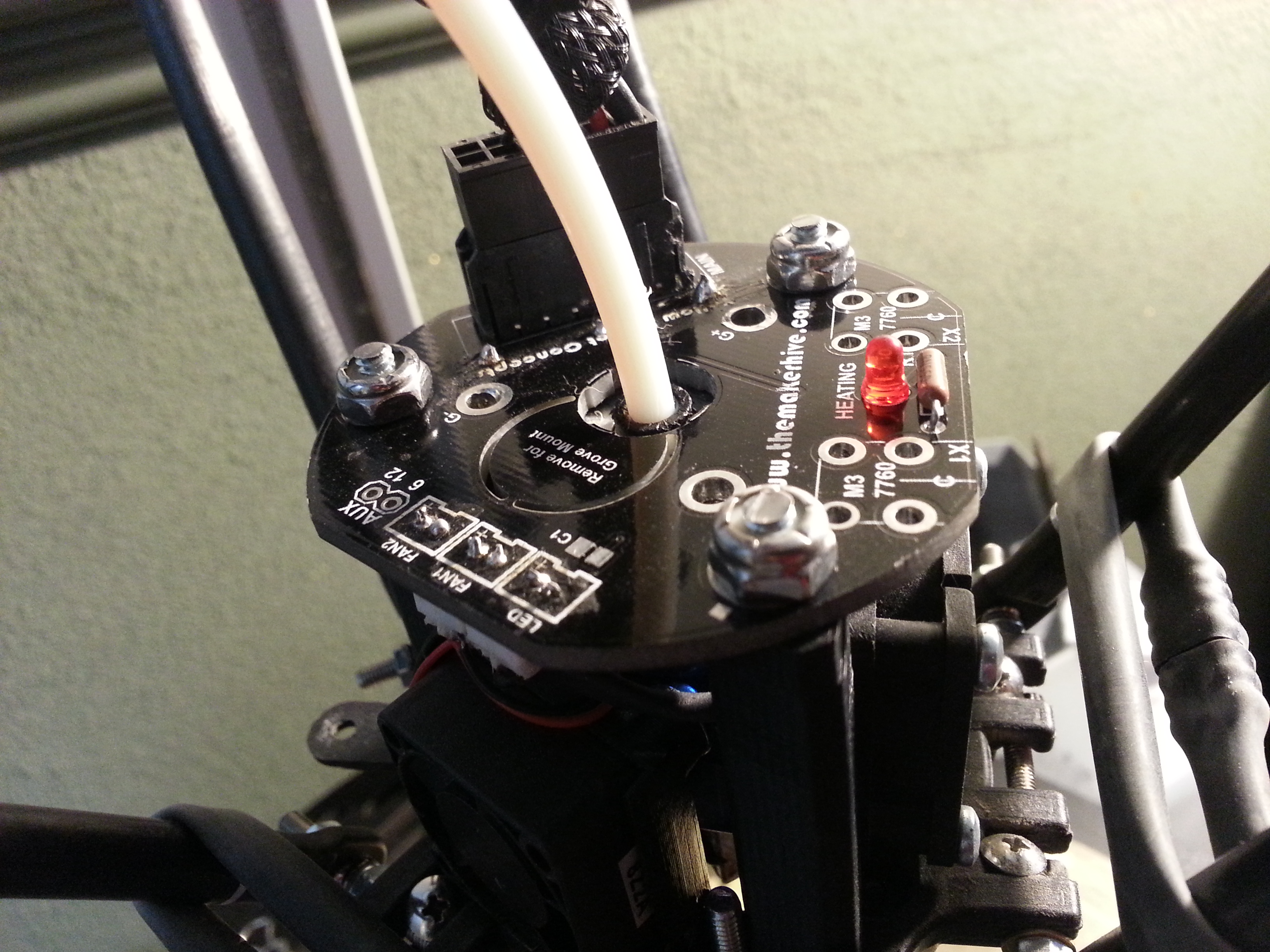

This is a pic of how i have mounted mine and without that bowden extension these is no way you can get your fingers in.
Re: New E3D V6 mount?
I gotcha, I didn't even bother printing that one to test. The small top mount sits flush with the top of the E3D v6.
