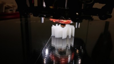

So S3D crashed and burned on my latest print. For some reason it's all blobby.So I switched over to KISS version 1.5 beta 2.16 and it printed much better, apart from some sparce infill and a shit ton of really fine strings. The strings aren't causing any part functionality problems. It just looks bad. I'm not quite sure what to set my prime/suck/wipe values. I'm printing PLA at 200C. Any tips?

This probably falls into the "blind leading the blind" category of advice but to me, 7mm prime/suck seems pretty high for PLA. I would try something between 1 and 3 (maybe 1.5 would be a good starting point?), maybe increase vS a bit and reduce vP. You could also try bringing wipe up into the 8-10 range. Also maybe reduce your trigger - possible that those short jumps are under the 5mm threshold?

Alright. I had no idea what those settings should be so I took the scientific approach. I guessed. :)
Re: Strings galore!
Firstly, you should take a look at the KISS manual that a fellow is doing (there is a link on one of the posts here). It will explain what all the settings are and how to use them.
So, here's what I recommend...
1) 200°C is a bit high (depending on your temp calibration, etc) so, do the test to find the minimum extrusion temperature. It is in the "Strategies" guide in my link. Low temp PLA results in less stringing.
2) what hot end are you using? In any case, suck/prime are very high. Lower them to around 2-3mm. They should both be the same.
3) your suck/prime speeds are a bit low - but it is better to err on the low side with PLA. Try vP=45 and vS=25
It really comes down to a suck/prime and temperature optimization to eliminate PLA stringing. That said, I can destroying almost all of my PLAs but I have 1 that still strings a bit no matter what I do.

1.) My EZStruder usually skips at around 195C but I'll try it there and see what happens.
2.) Using the stock SeeMe hotend with .35mm nozzle.
3.) Roger that!
4.) One more thing that I noticed. My nozzle was set to .35 in KISS. I just changed it to .38 and I'm getting beautiful results at the moment. I'll try your settings above next and post a pic when done.

Yes, I measured the filament. It's 1.73mm and that's what I have plugged in.
This isn't exactly an apples to apples comparison. I tried the mhackney settings BUT I tried to print at 100 micron. I noticed that it was really getting stringy so I stopped the print. I was squirting at 195C.
The next one I did, I moved to 5 prime, 5 suck, 5 wipe, 45vP, 25vS, 2 trigger, .4 z-lift, and 200 micron layers. I ran half the part at 195C and then bumped it down to 190C on the printer. No skips. Reduced strings but they are still there. Obviously, I broke the cardinal rule by adjusting more than one setting at a time. I'm happy with the quality of the print. Not a single blob anywhere. Only the strings.

Better. Now you can play with seam hiding on the Style page.
Also, because I'm printing precision reel parts, I turn Perimeter speed down on the Printer->Speed tab. I like to print the perimeter no faster than 30mm/s. This also reduces stringing as it gives suck a little more time to do it's thing.
