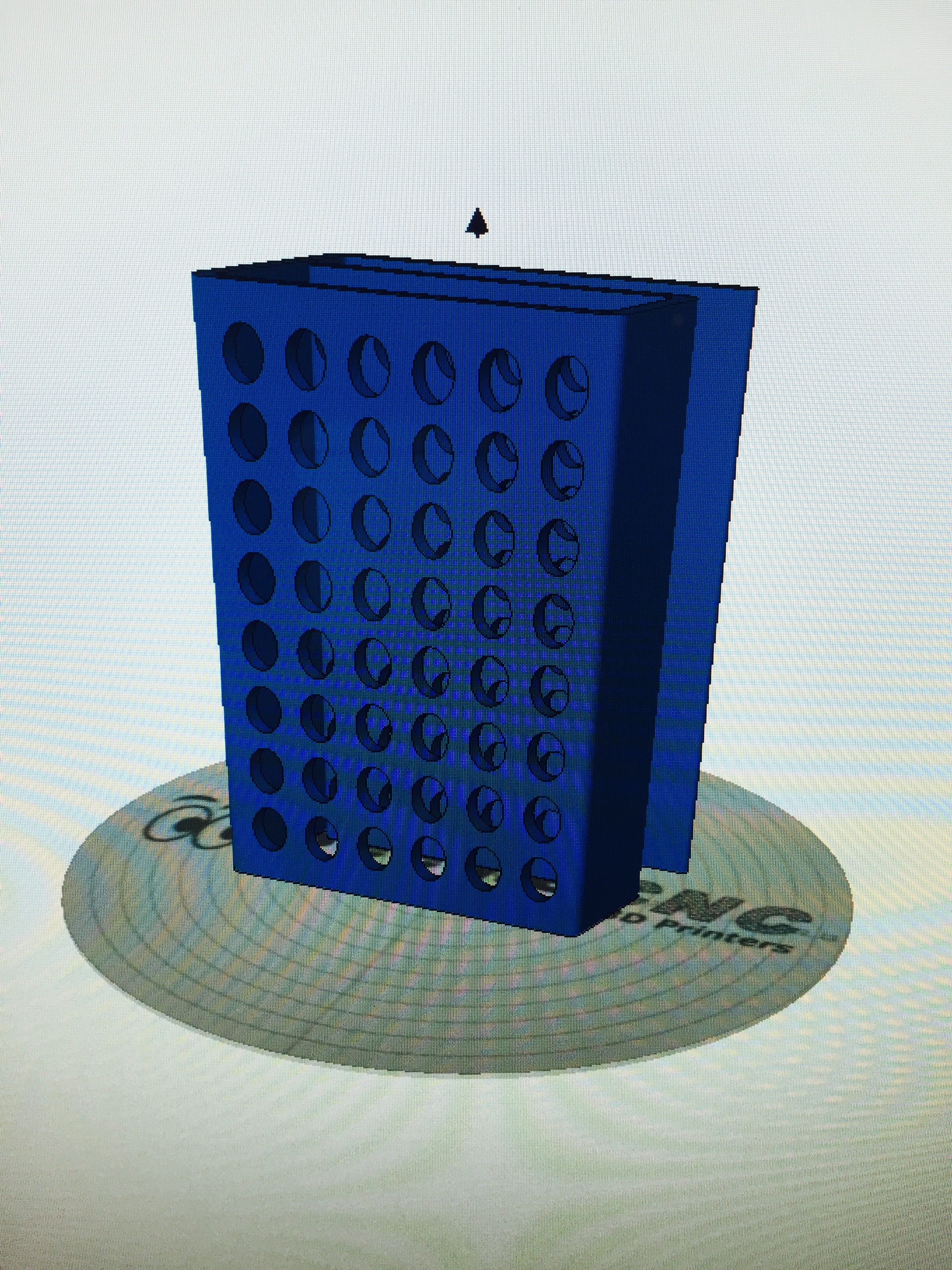

Just started a 20 hour print.  This is Copic Pen rack my daughter designed and made on 123D.  It is a 1000 layer print which is 15x20 cm.
Fingers crossed. Will see how it goes with the enclosure.

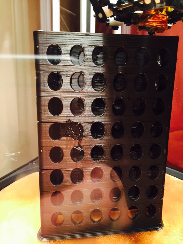

An update.   My first print failed.  You can see the separation which occurred even after changing the extrusion multiplier back to 1.   I should have stopped this print earlier since when it was sliced with MC when using MC slicer and Cura doesn't didn't build the infill which I set at 30%.   I also stopped my second and third print again because of no infill which I changed to 40 and then 50%, respectively.   I'm not sure why MC does not build the infill on occasion .  This has happened to me multiple times even with reprints or different prints. Once MC quits building the infill all prints fail in that regard.  When I changed the infill to 80%, it build the infill.
   Gremlins or something live there!!!  As well Slicer has never worked for me in MC even with default setting.
I will post this in the MC tread as well. I've downloaded Repetier and may try that. Havent decided!
Here is the no-infill fail. Overall it looks terrible.

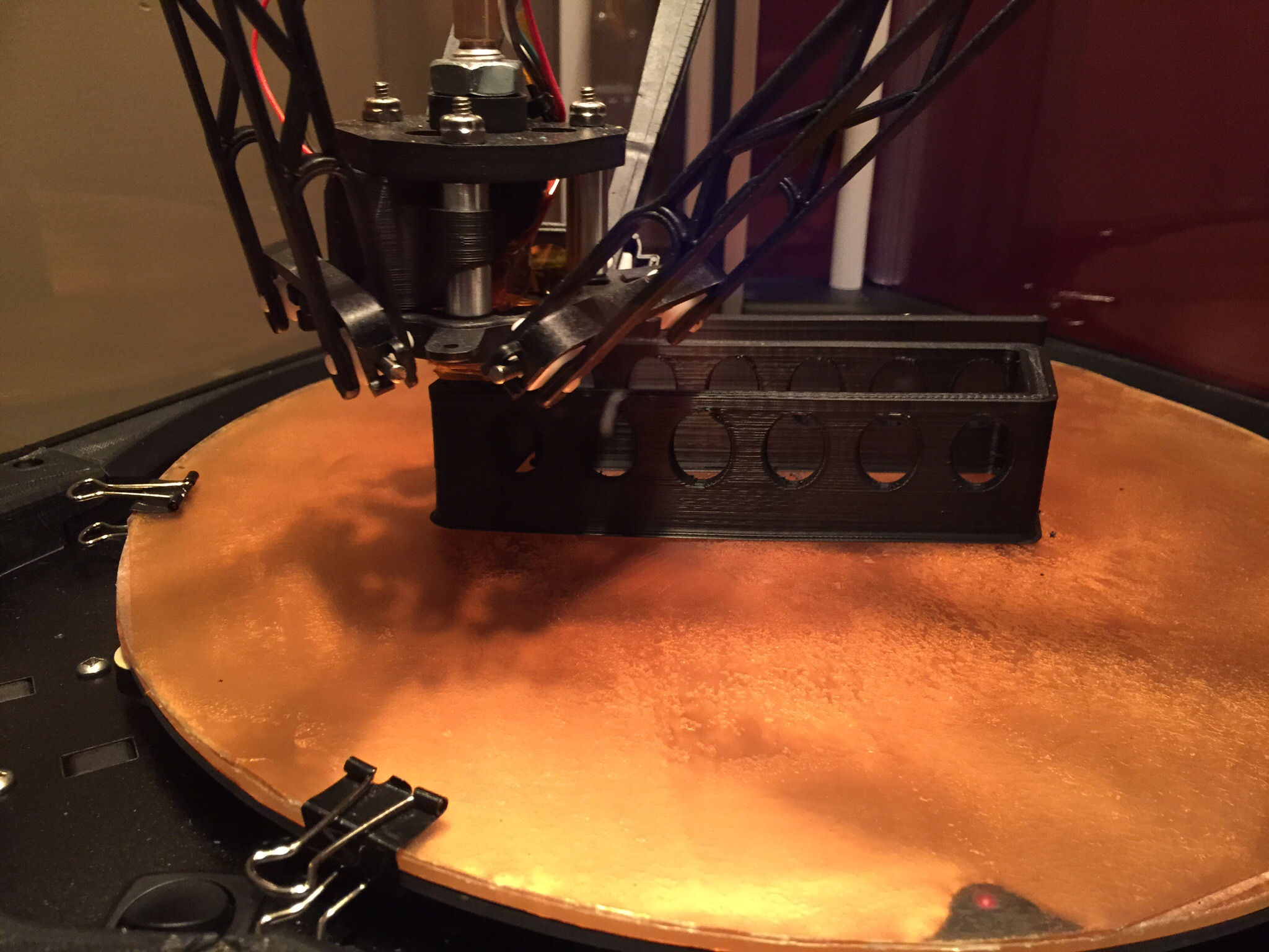

Here is my current print with 80% infill.  So far the only thing I see is that the left corner has lifted off the PEI slightly.  Not impressed with my layers which are not well lined up. With the thin wall, when the printer is laying down the infill the whole printer is shaking.  I suspect/wonder is this is where TrickLaser Arms would help.
Off to work. We will see how it looks tonight.

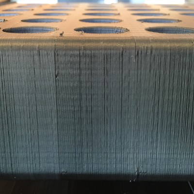

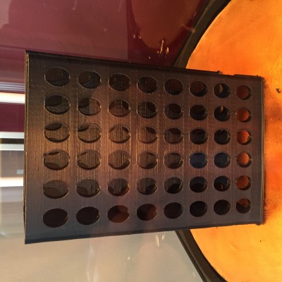

						38 hour Print.
It isn't perfect but not bad.  38 hours. Wow
Re: My "BAP"
Getting better all the time!  Great job!
						Re: My "BAP"
Thank you.  When I look close you can see where there is almost some or very subtle separation.  Is that just ABS?
Re: My "BAP"
It has more to do with it being a Delta, all produce those lines some not to bad like yours or some that have very pronounced lines.3D-Print wrote:Thank you. When I look close you can see where there is almost some or very subtle separation. Is that just ABS?
Re: My "BAP"
Do you think the TrickLaser arms would clean that up a bit.Eaglezsoar wrote:It has more to do with it being a Delta, all produce those lines some not to bad like yours or some that have very pronounced lines.3D-Print wrote:Thank you. When I look close you can see where there is almost some or very subtle separation. Is that just ABS?
Re: My "BAP"
The TrickLaser arms will help but they do not go completely away. See this topic http://forum.seemecnc.com/viewtopic.php?f=37&t=76053D-Print wrote:Do you think the TrickLaser arms would clean that up a bit.Eaglezsoar wrote:It has more to do with it being a Delta, all produce those lines some not to bad like yours or some that have very pronounced lines.3D-Print wrote:Thank you. When I look close you can see where there is almost some or very subtle separation. Is that just ABS?
