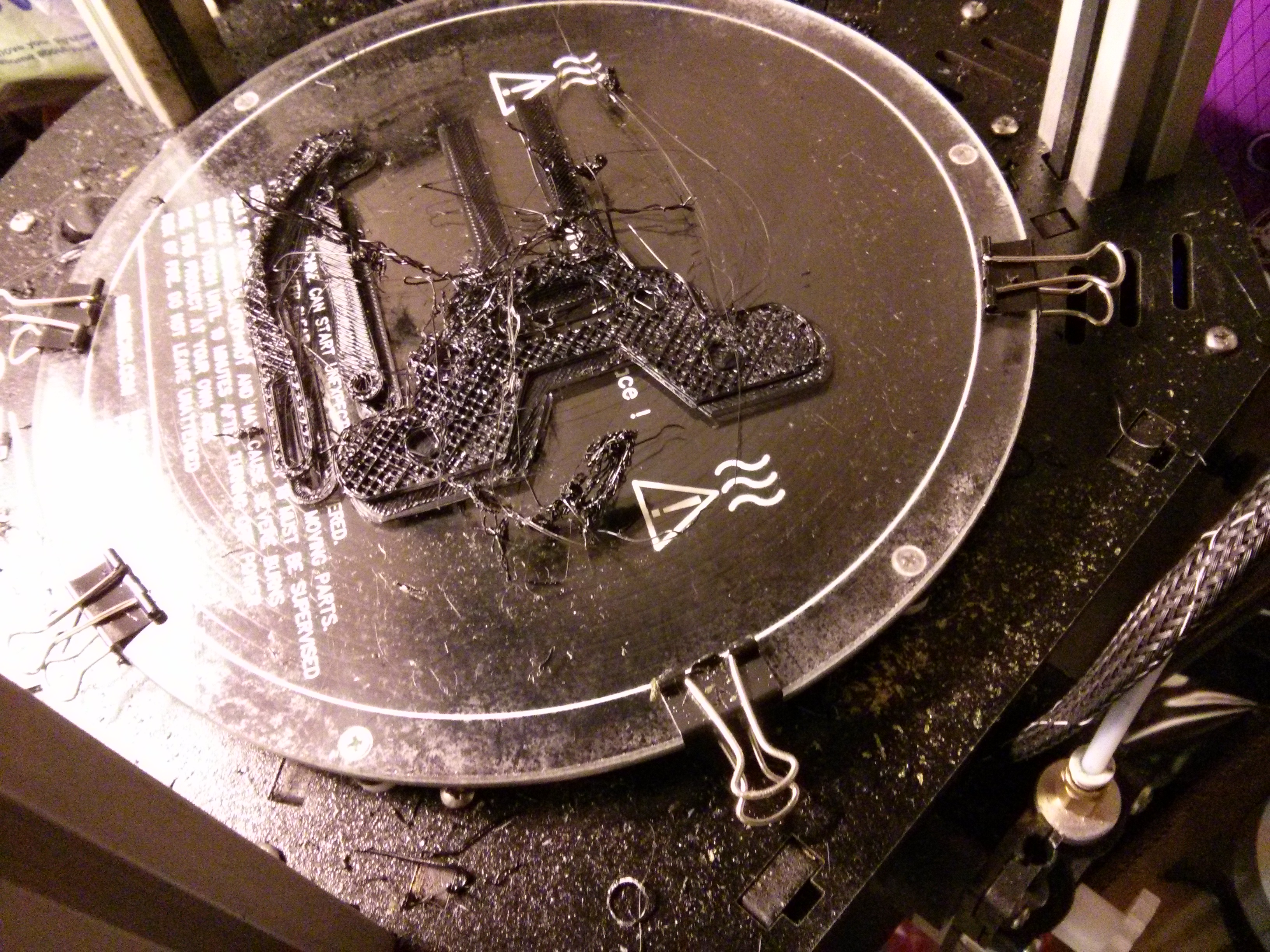

I have an Orion with about 890 hours on it. It has printed without issue for the first 840 hours or so, other than blowing a heating resistor. When it blew the resistor, I upgraded to an E3D v6, which has also performed well.
It's developed a problem where it seems to be missing steps, potentially on the tower opposite the extruder. At this point, I am not able to complete hardly any prints, although it seems to fail at seemingly random points.
  • First few layers usually seem to look good...sometimes a dozen layers or more are fine before it goes out of whack, and the level at which is fails does not seem to be consistent.
  • Problem is consistent across three spools of ABS from two different vendors. SainSmart and Zen ToolWorks.
  • I have re-leveled the bed a number of times, using a 1 layer thick spoked wheel to look for consistent first layer extrusion height with good line to line adhesion without too much smoosh. (I've never had great success with the "watch the gap" method.)
  • I have disabled ALWAYS_CHECK_ENDSTOPS, to ensure it's not the EMI issues identified in other threads on this forum.
  • I have checked the extruder, by telling in to extrude 10cm of plastic, and verifying extruded accuracy with calipers. G1E100F90
  • I have tried with both a .4 and a .8 nozzle. (.8 is what I've used since upgrading to the E3D, but wanted to rule things out. .4 is current installed.)
  • Fails both when sending via OctoPrint, as well as printing directly from SD card.
  • The problem started happening shortly after I cleaned the bed...which may be pure coincidence.
  • I use hairspray. Over time, spray tends to build up on things. Is there any specific parts I should try to remove and clean, or potentially replace?
Related to this issue, how do I access the stepper motors? I assume they are behind the blue acrylic panels, but I'm not sure how to remove those.
Regardless of this specific issue, is there any maintenance that should be performed on a printer with this many hours?
I NEED to get this resolved this week, to ship orders that depend on parts produced by this printer. I appreciate any help.

The acrylic panels just pop out,,,,, Download the build manual for a Max V2, the orion is the same, just smaller. First thing to check is the drive pulley, If they come loose, it will exhibit what you posted.

From the photos, can you take an educated guess about which tower I should focus on? You can see the ezStruder, as orientation reference.
I got the acrylic off (thanks), and see where the gear attaches to the stepper (very limited access), but am not sure what exactly to do, or which tower to focus on. I tightened belts on 2 of the 3 towers, and am trying a print now...

Turn the printer on and Home it, that should lock the steppers. See if you can grab the carriage and slide it down the tower. If it's loose it should allow the pulley to slip while the shaft is locked by torque.

With two belts tightened, I got a good print my first try.
Went ahead and tightened the other belt too, and am starting another part...

The inside strand of the belts felt tight. The outside strand felt very floppy, but because of how they are inside the extrusion channel, I had to feel them from "inside the acrylic" after they exit the extrusion channel to see how loose they felt.
Now, two good prints in a row...and best looking prints I have seen in months...clearly tightening helped. But the third print failed again.
OK, back to checking the drive pulleys. When I grab a cart during homing to force a skip on two of the towers...it's a "zip" sound. The third tower has a very different metallic clicking when forced to skip, although it still takes a lot of pressure. I'm guessing I just identified a slipping pulley wheel. I'll investigate how to access that pulley.

Sounds like you found the slipping one or maybe two in your case. The hard click should be the belt slipping over the teeth of the pulley.
Off topic question but how the heck did you get filament splatter on your towers? or is that filament?

I think the splatter is from a combination of hairspray and misprints. No joke, I've probably printed 6 pounds of spaghetti in the last month or two.
