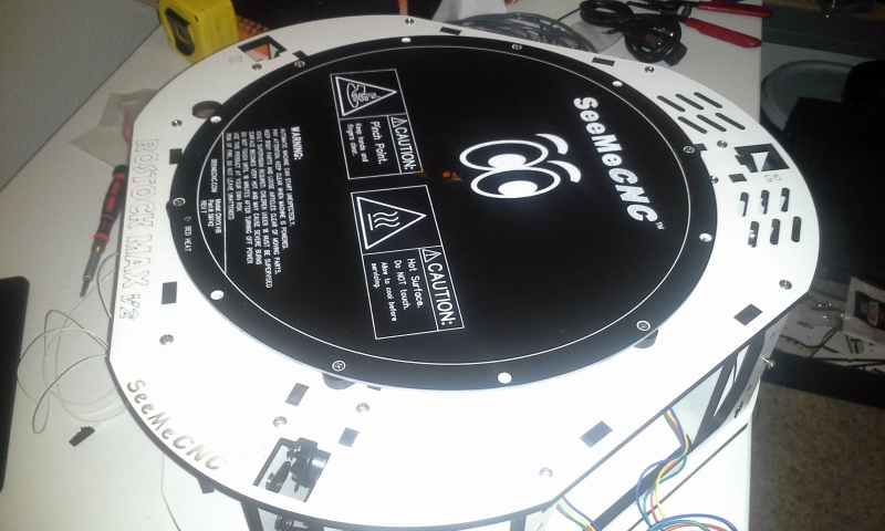

Top is on and towers aligned. However I am not happy with the smaller square that I have. I may have to revisit the alignment.
It seems that my heated bed is domed in the center from the get go. How to fix this? No its not the kapton tape this time.
Re: drunkenmugsy's build thread
Check to make sure the wires between the snowflake & the base aren't bundled up and pressing up on the back side of the Onyx plate.
If the Onyx plate is removed from the snow flake, is it still domed when unmounted?

Test fit of the Trick Laser arms upgrade. Yes I know the plate is backwards. I did 2 that way before I realized it. But I dont care if the eyes look to the left. It will be unique. They are all looking the same way.
I will check the wires under the bed. I suspected it might be something like that. I put a small zip tie on the wires under there. With the spacers it shouldnt be bound up but it might be I guess.
If you put on the glass and clamps around the edges is the doming still present?
