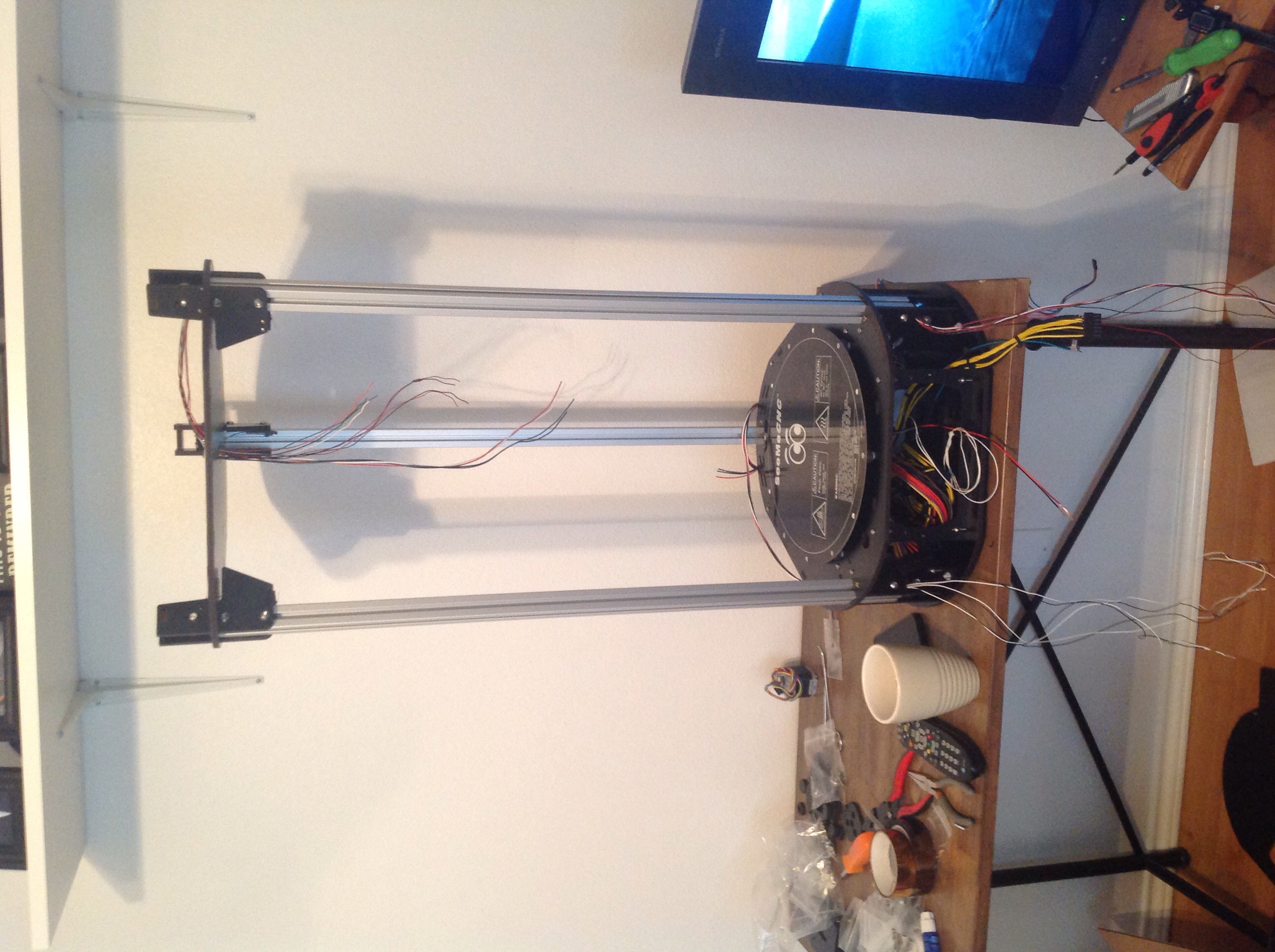

Trying to upload a photo of my build. Going pretty well so far. I've just finished installing the top and connecting the end stop wires. The build quality is really good, I'm impressed on how I'll look at the manual, look at the build, maybe think,"How the heck is that going to go? That's gonna be tough!". Then I try it, following the manual word for word and it goes flawlessly. As a mechanical engineer working in a production environment I see an sometimes draw a ton of assembly drawings and work instructions, and the pdf manual for this kit is REALLY good, kudos to those that designed this kit and build instructions!!!!!
As far as the tape goes I understand that it could be considered a consumable like paper towels or RTV. The only problem I had was sourcing it locally, and for something that's somewhat difficult to source I would have gladly paid another $30 for the kit to avoid the frustration, as it stands I ended up paying closer to $50 for the roll with no stick and the roll+fast shipping for the roll from Amazon. Now, if I was a smarter man I would have read the assembly manual before I ordered the kit and ordered all needed extras at the same time I ordered my kit, so that part is on me. In the end I'm still totally satisfied with my purchase, so I'm gonna quit whining about tape

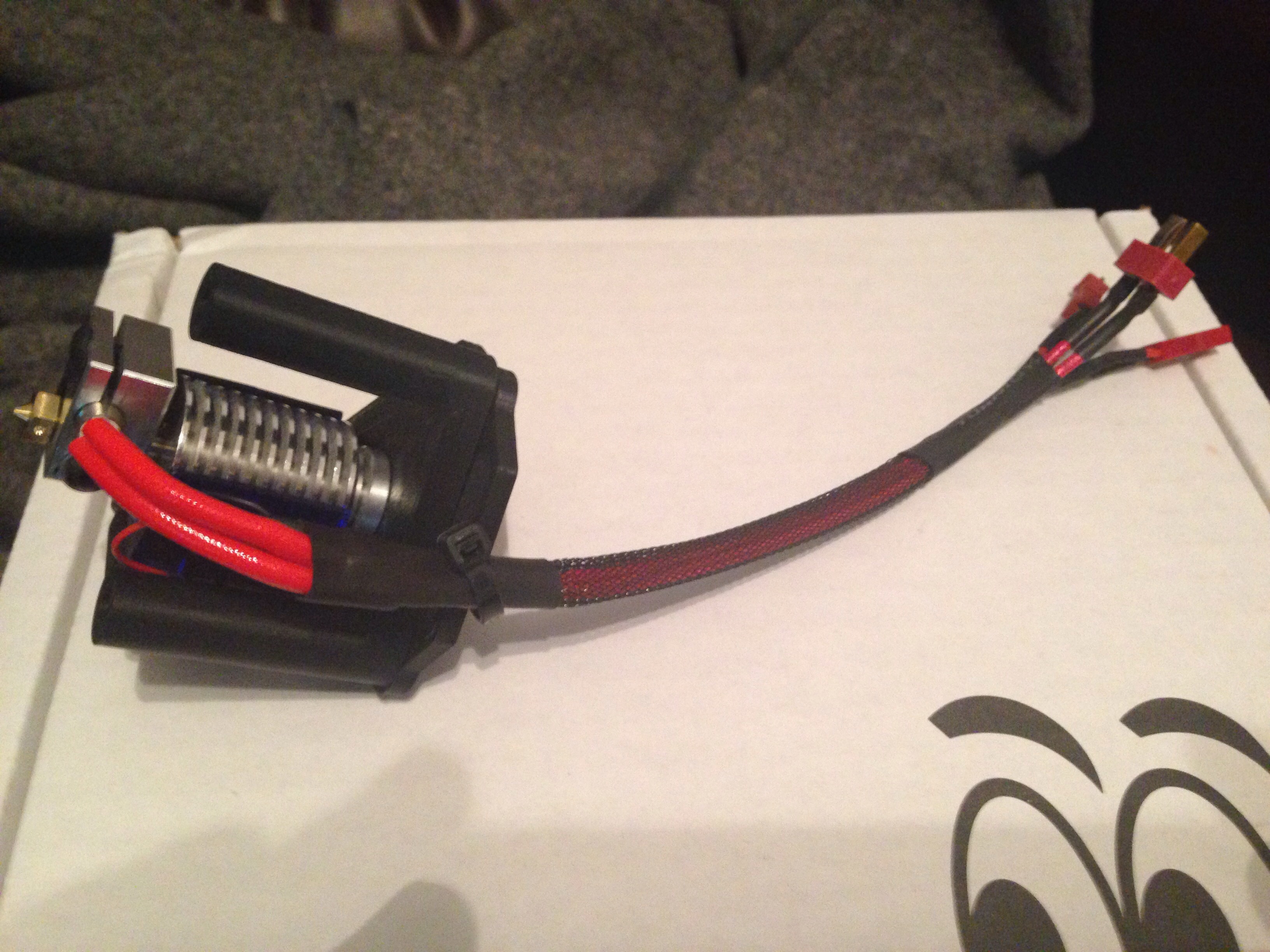

Ran my v2 for the first time last night, got it moving, but no temp reading on hotend during testing, hotend got hot however. Luckily I had ordered an E3D hotend already planning to replace the stocker. During disassembley I found that the temp sensor had actually come loose from the hotend, probably while I was taping it up? anyways, new hotend arrived this morning and I got it all wired up.
Used 3 different hobby connectors I had laying around from my RC helicopter days so I can easily remove the hotend in the future if needed. Reason for 3 different connectors is this assures I can't plug them in wrong and I could use lighter connectors on lower current areas like the fan and heavier for the heater cartridge. Got it all soldered up, wrapped in sock and heat shrinked, think it turned out pretty good:-)

I like that connector setup. I had planned to do similar with rc connectors. There was a post about suggestions for doing this 04/14 but I have been unable to find it again.

I used to use Deans connectors for the the Hotend power and JR style connectors for the fans, they work fine. The only reason I changed was because I was trying to wire 4 hotends at the same time and I liked the long wires that come with the heater cartridges, I moved all my connectors off the Hotend and put some panel mounted connectors on the printer itself.
Getting the connectors off the moving part meant I was no longer restricted in what type of connector, so they end up being easier to connect/disconnect.
Re: Another new user from Fort Worth Texas
I used Deans for the heater, micro Deans for the sensor and JST for the PEEK fan or heat barrier fan in my case with the E3D hotend. I put another micro Deans on for the layer fan and sharpied it black. I have tons of those connectors laying around from RC helicopters and airplanes, but I really like the idea of putting them up top with a simple plug bus like you suggested, sounds slick!

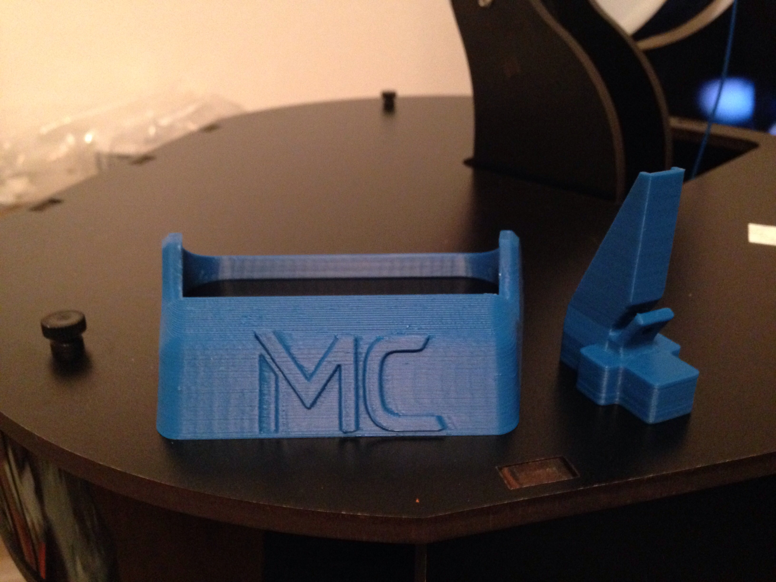

Prints 2 and 3, layer fan shroud and a stand for my MatterControl Touch!!! Came out great!!! The stand was my first print using the touch as well, 2 previous prints were driven from my PC. The MCT has a pretty decent interface, no brainer after using the PC version of MC.
Next I'm going to try some different filament and get started on my sons school project.
