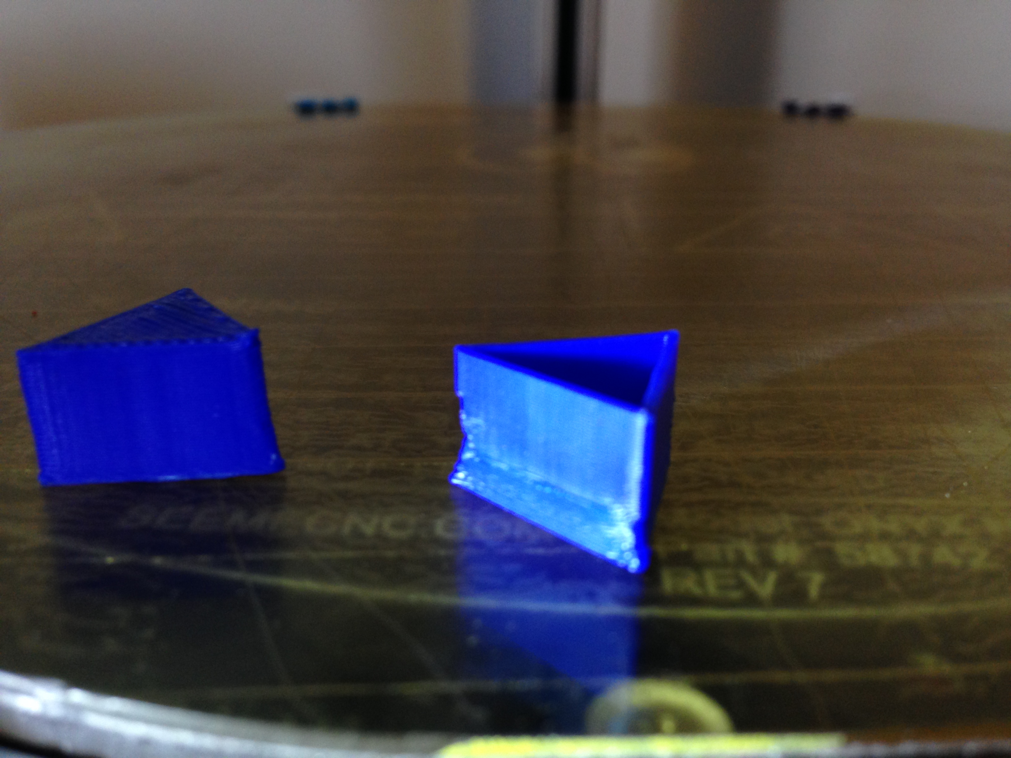

Re: Vertical Banding Revisited
bottom shows vertical bands in large print, next shows minor bands printed with same settings in matterslice, next shows about the same with spiral vase with no fill, top is the gcode from Jimustanguitar (standard Cura)
Cura showed more vertical banding but the print in person is much better. I'm going to match the layers in matterslice and try it again.

The thing I just printed has the pattern. Narrow spacing compared to the infill. You can see it in the attached picture.
Infill 10%
Slicer S3D
Speed default (50mm/s infill, don't remember what perimeters are).

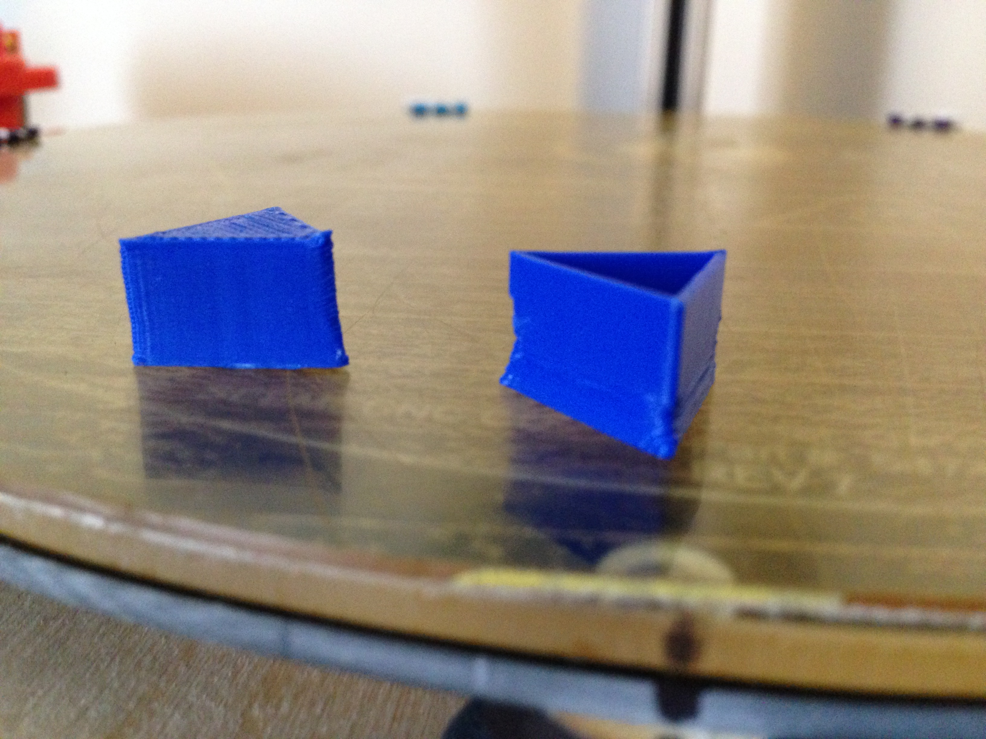

I was able to tease out some of the banding with a change in speed and temp, but it's not all better. (switched from 40mm/s @220 deg to 70mm/s @ 215 deg)
Before:
[img]http://i.imgur.com/qVihWzt.png[/img]
After:
[img]http://i.imgur.com/096bIrK.png[/img]

ok here is the one with infill just as sliced. hard to see the banding on such a small piece but its there.
[img]http://i1102.photobucket.com/albums/g446/davidflowers1/Mobile%20Uploads/20150209_094609.jpg[/img]
